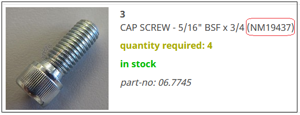

Both the 7" & 7 3/8" forks (FeatherBed & Navi/Electra) use Part No 19437
cap screw

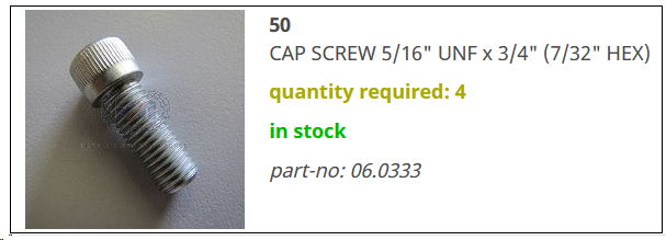

The Commando uses Part No 06.0333
cap screw - commando
Pictures courtesy Andover Norton
