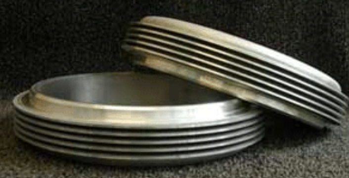

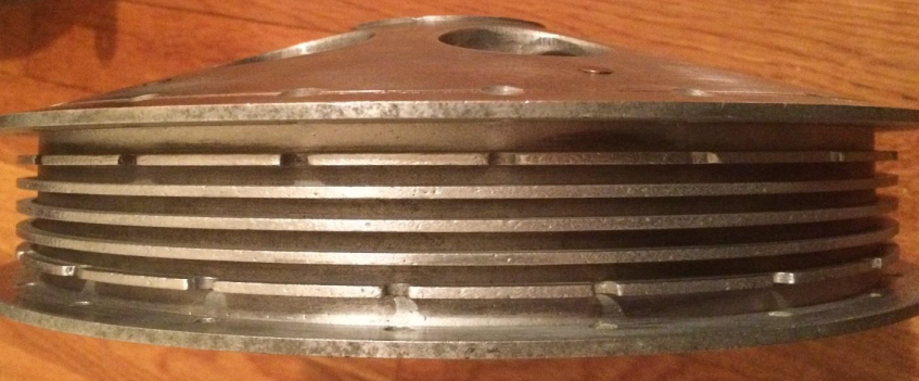

Improved cooling can be catered for quite easily, by hole drilling plus drainage facilitated. Gold plating intensifies heat transference!  Plus ribbed drums helps too.
Remember, Bacon -slicer cooling discs, i was too young!

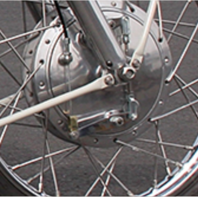

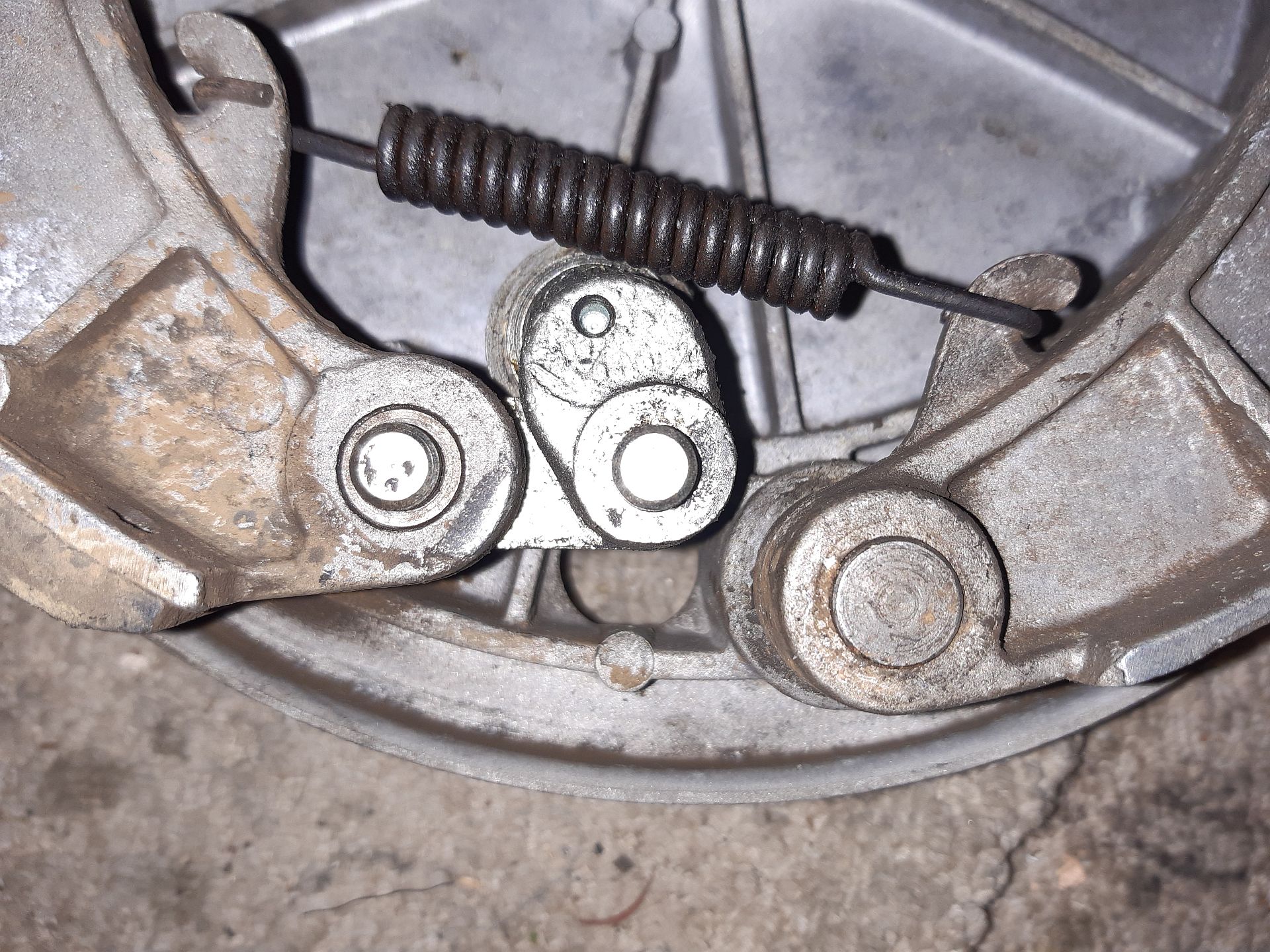

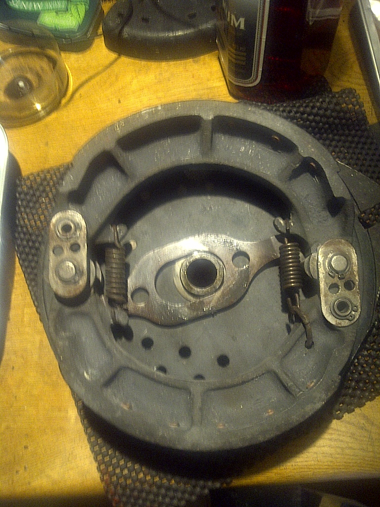

John; I came across this picture of the TLS brake on my plunger Norton of 1950 vintage.  Externally it looked the same as a Magnesium plate SLS of the period but the added actuator plate and dual pivots added. Another Jo Craig experiment???
 Maybe it will help with a new idea.

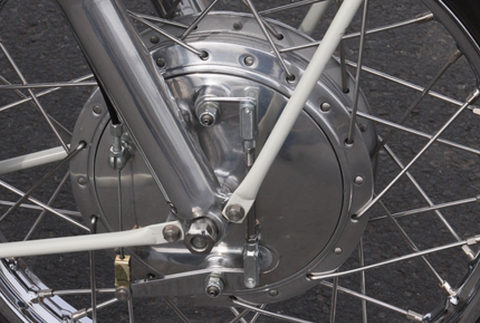

The Laverda design allows the two levers to move in opposite directions.  So the cable can pinch one against the other, and does not need a tie rod.  BMW do the same thing.  They both have to have the cam pivots at different radii from the wheel spindle.  If you did it with the Norton brake, the cams would each be pushing at different radii from the spindle, so the self-servo action would be different on each shoe.  The cranks will have less friction than cams, so that should put more force on the shoes.
There was a vogue for replacing the cams with hydraulic cylinders from BMC minis at one time.  Are any of those still on the road?  Again, less friction.

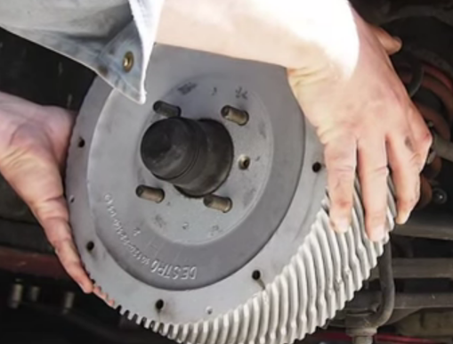

Also seen some drums I think Alfa Romeo automotive brakes, with intricate fin designs for cooling, before the ugly disc units crept in!

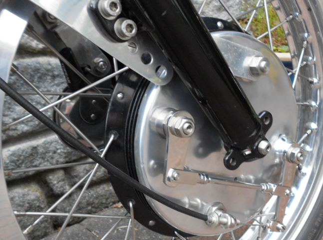

A better photo of the modified Norton Dominator SLS to TLS.
