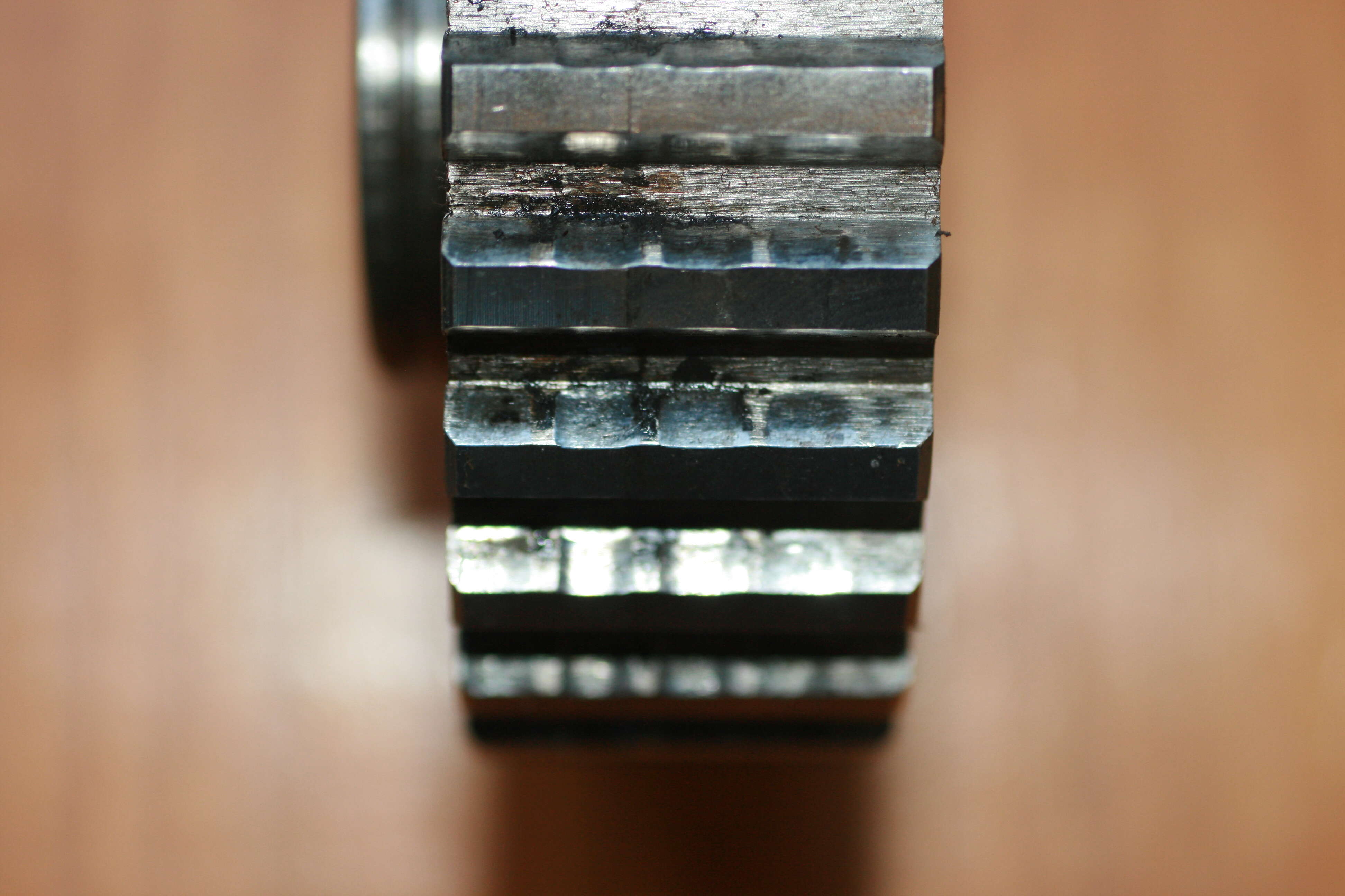

First gear is selected when the 4 dogs (pegs) on layshaft 2nd gear engage with the four holes in 1st gear. When fully "in" gear, the dogs pass fully into and slightly thru the holes. It stays in gear because the dogs are slightly undercut (inverted taper) which locks them together under load. With use the dogs and holes wear so the taper goes the other way and the gears are pushed apart under load. The selector mechanism - cam plate & index plunger spring - resists this until the wear is too great and the bike jumps out of gear. The problem also occurs that the 2nd gear dogs are not fully engaged with the 1st gear holes and, sitting right on the edge, easily slip apart. This can happen if the rider is rather half-hearted putting it into gear but a Commando usually completes the shift for you - unless it's worn. Then you have stiffness in the shift mechanism, if the camplate pivot is stiff, if the index plunger doesn't slide freely or has come unscrewed (when you'll have an oil leak)

Well David, knowing the effort you put into these things, I hesitate to disagree with you but I have just measured the dogs on a brand new 2nd gear (06-4640) and, at the base (next to the gear) I get 10.52mm and at the tip 10.68mm. Which in my book is a taper, albeit not as marked as the one on the 3 dogs between 2nd and 3rd.

06-4640 : I think my gear must be in the wrong bag 'cos that p/n shows as mainshaft 2nd on Andover's site, Mine is definitely a Mk3 layshaft 23T 2nd from Andover (06-4639) circa 2000.

Having 13 gearboxes with all the bins of parts, from N to NA to all vintages of commando including MKIII. Then several more in 12 commandos I own. The factory prints will tell all if the "current" ANIL will show or declare the print detail. I have examined various other factory prints and the taper detail "should be" quite clearly spelled out. The peg on 2nd gear and the holes on 1st would both be needed to be tapered to be effective.
I defer to the results of factory drawing details....

Having looked at the dynamics of thrust transfer between two ajoined gears, I have surmised the thrust transfer is at an angle between the driven layshaft and drive mainshaft gear sets. With a worn 1st gear bush there becomes a "crawling effect" while revolving that produces a bit of dog disconnecting thrust. I always refresh the 1st gear bush to reduce the crawling effect by better supporting 1st gear.
Worn dogs against worn holes in 1st layshaft aggrivate this worn bush situation and the result is popping out of gear in 1st gear high thrust situations.
