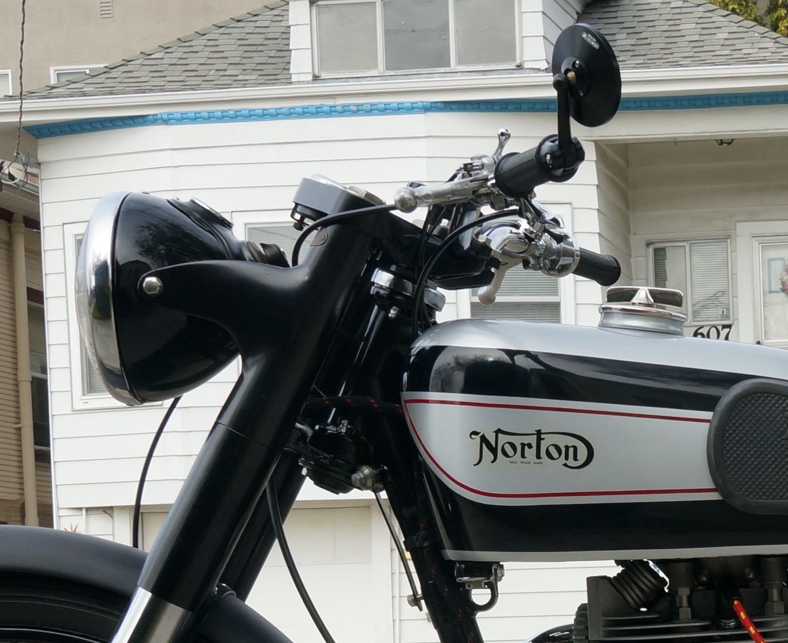

The only morrors I would consider are Halcyon made in stainless with an expander that works and wont fall to bits , replacement glass on line ,and semi concealed adjusters to stiffen the action .  Worth the money but not cheap compared to Chinese crap.
I have Halcyon bar end mirrors on 3 bikes now, and as Robert says they just work. I think mine are the 830 type.
Remember the old phrase "the quality is remembered long after the price is forgotten".
Image clarity is OK up to around 80-85mph on the Norton, then the vibes start interfering.

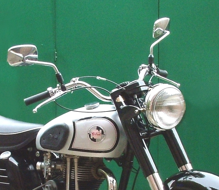

after trying one or two cheap mirrors, none would stay put. some would fly off in the wind no matter how tight they were. at certain rev you slowly got a view of the tarmac when they vibrated loose. on fitting some raised handle bars i wondered if i could fit an old set of mirrors i had. they were off a triumph adventurer 900. its the sort of mirror you can grab hold of to push the bike around with they are fairly sturdy. dont know what view you would get on straight bars. i think its worth as already mentioned buy some dearer types, better quality ones.

Only old English bike I have where rear view isn't blurry is a Vincent with bar end mirror. All with long distance between mirror and handlebar gives blurry vision.
I use stadium or halcyon bar end mirrors on my dommi.  Avoid the cheaper mirrors they do not give a very wide view giving potential blind spots. I suffered from vibration on my mirrors which became a blur after 30mph.  Filling the bars with molten lead reduced the shake. Also I discarded the steel expander within the bars and replaced it with suitable sized rubber pipe. I now have good vision up to 50mph.

I had two  Halcyon bar end mirrors that were very clear up to 55 as well. after that the vision got blurry very quickly.
Worth paying extra for genuine Halcyons.
