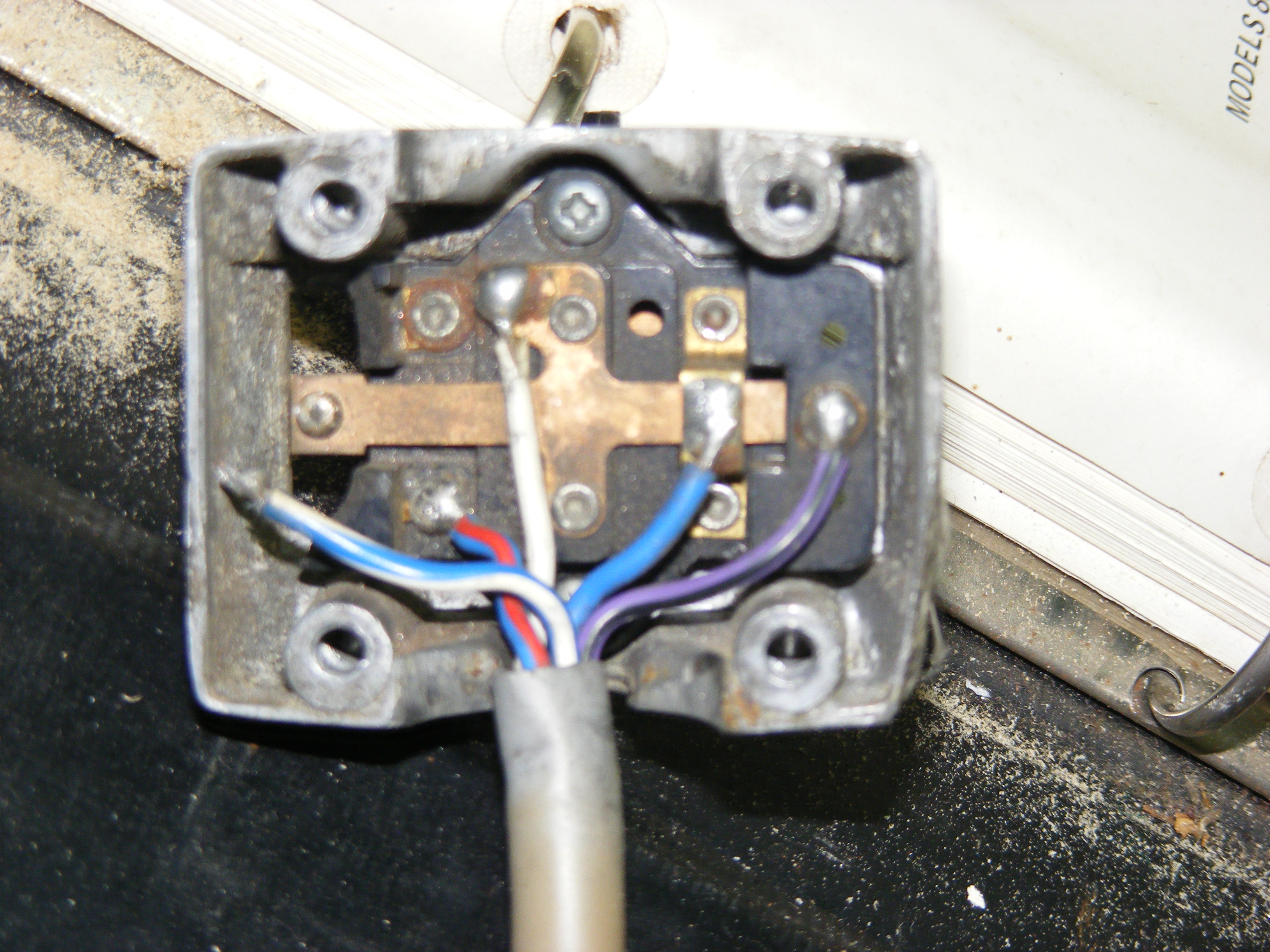

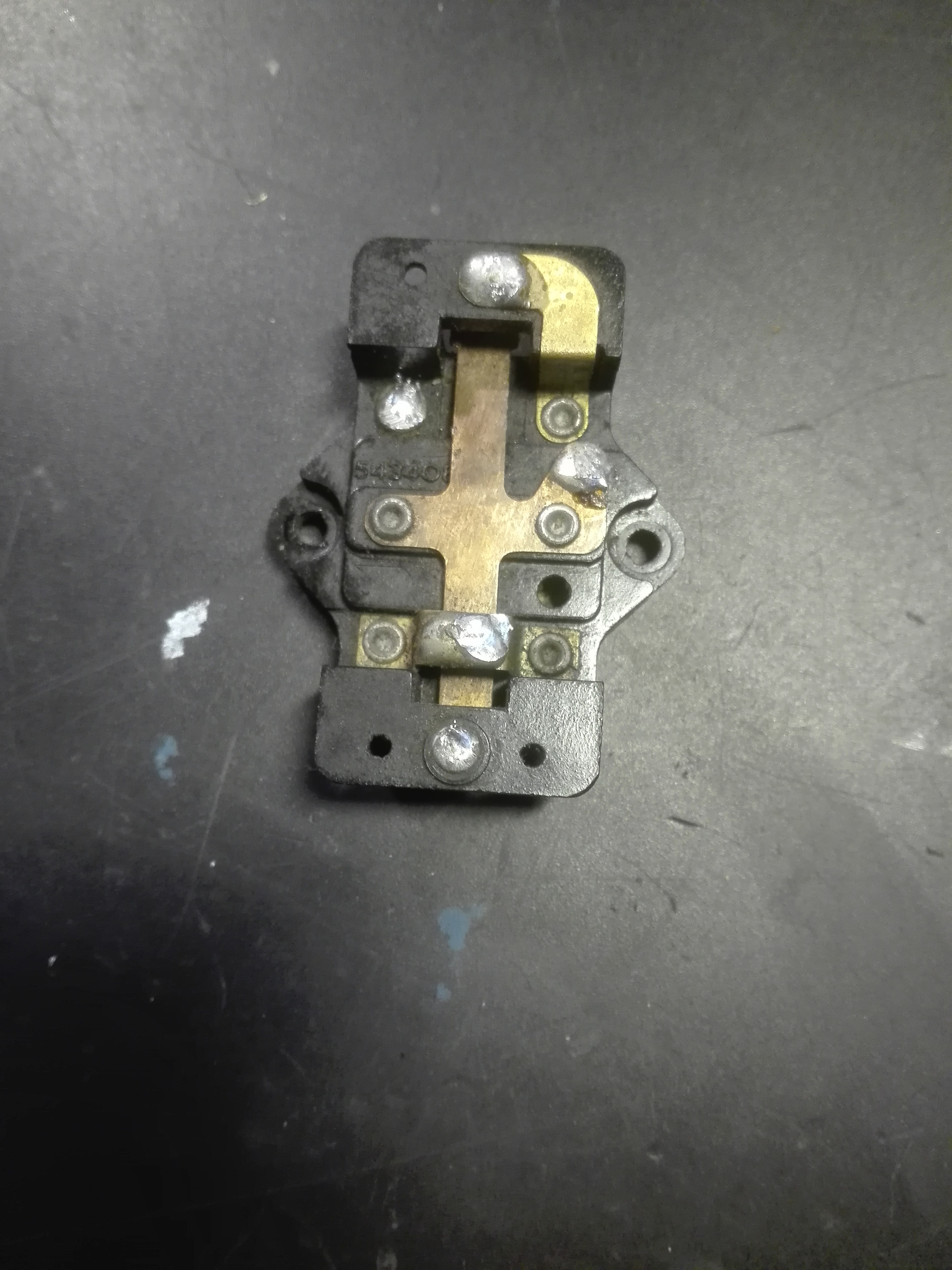

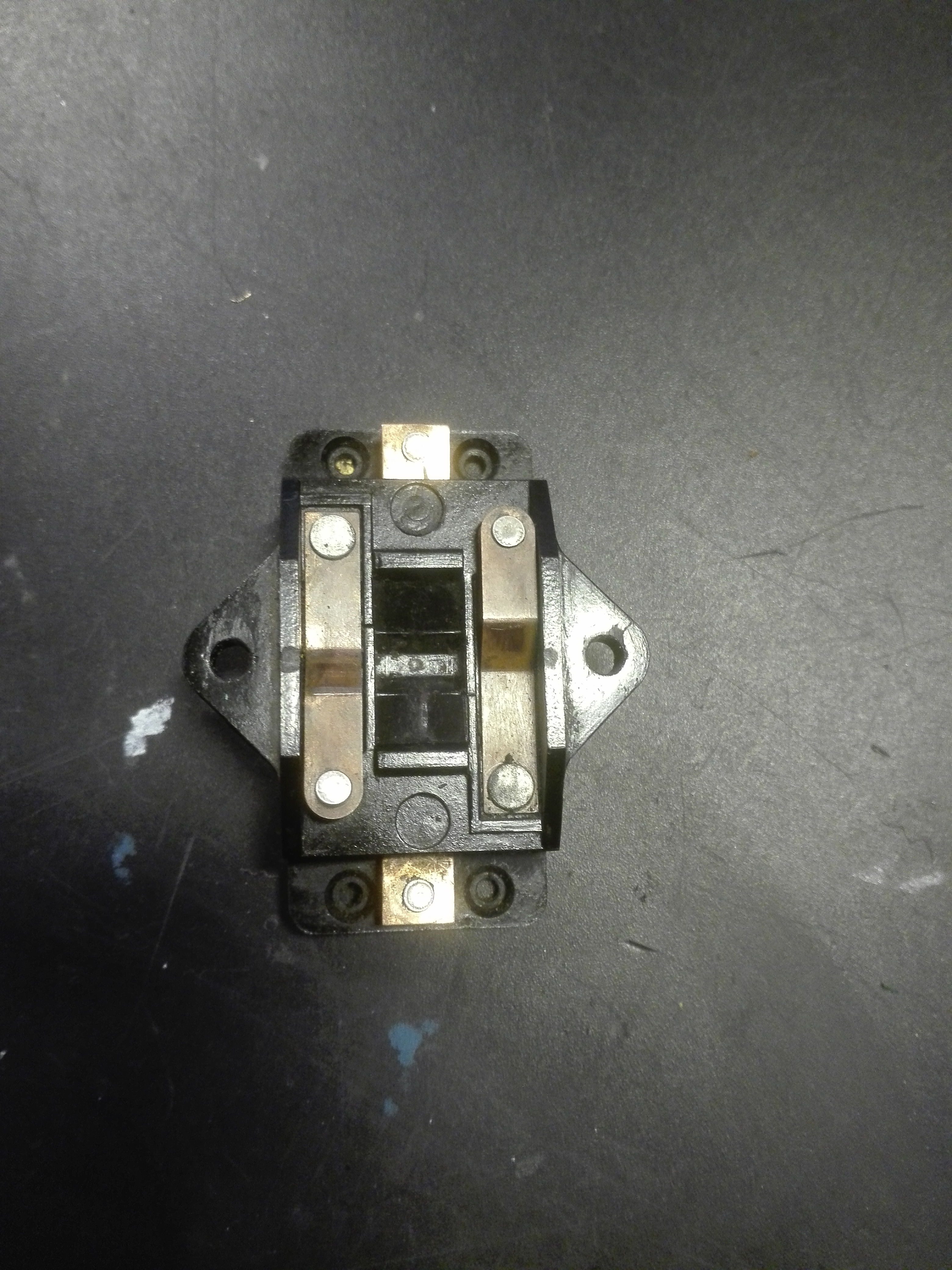

If you still want to do a conversion, I have attached some photos.
Just be aware that the engine kill button breaks a connection and the horn button makes a connection when pressed.
RH. White = live. UW Blue/White = main beam. UR Blue/Red = Dip beam. U Blue = Switched live from headlamp switch. PB Purple/Black = Horn. Flasher is an internal connection.
LH. White = Live. GR Green/ Red = lh indicator. WR White/Red = rh indicator. LG/N Light Green/Brown = live feed from flasher unit. WY White/Yellow = Engine kill.
