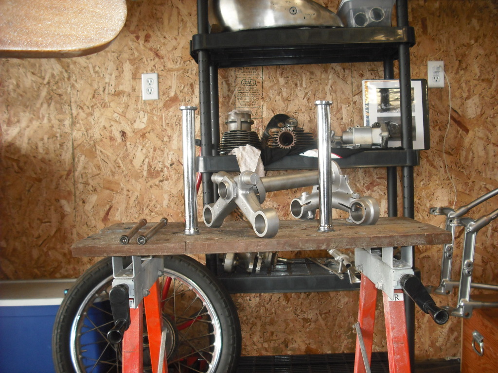

If you want to play "Where's Waldo", you can find the handlebar clamps just above the handlebars in one pix. The other pix shows the top yoke with its "Dowles".
These are pix of my sickly '48 ES2 thatI am SLOWLY restoring.

yes there the right 1948 type they handle bar clamps fit on the end of the top yoke keep a eye out on ebay for these there not easy to find,
Previously Paul Gibbons wrote:
are they roadholder longs thow as the 1954 featherbed framed Dominator model88 had this type of Handel bar clamps they where mounted in rubber and had sleeve nuts on the under side of the top yoke the roadholder longs had there handle bar clamps cast in
to the top yoke
