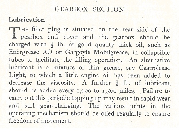

If you happens to have an old gearbox that uses semifluid grease, warming as Michael said makes it possible to get the grease/oil mixture into the box. Not sure but some really old Nortons might have used it.
... the query related to the laydown box that doesn't.
Whenever I check the oil level in my gearbox, there is always some oozing out of the level plug hole.  I haven't been asked to add any for at least two or three thousand miles.  Maybe I grossly overfilled it initially.
Phil, it never occurred to me to use sloppy grease in a Norton box.  I use hypoid gear oil, but you have to make sure it's not going to eat your bronze bushes.
