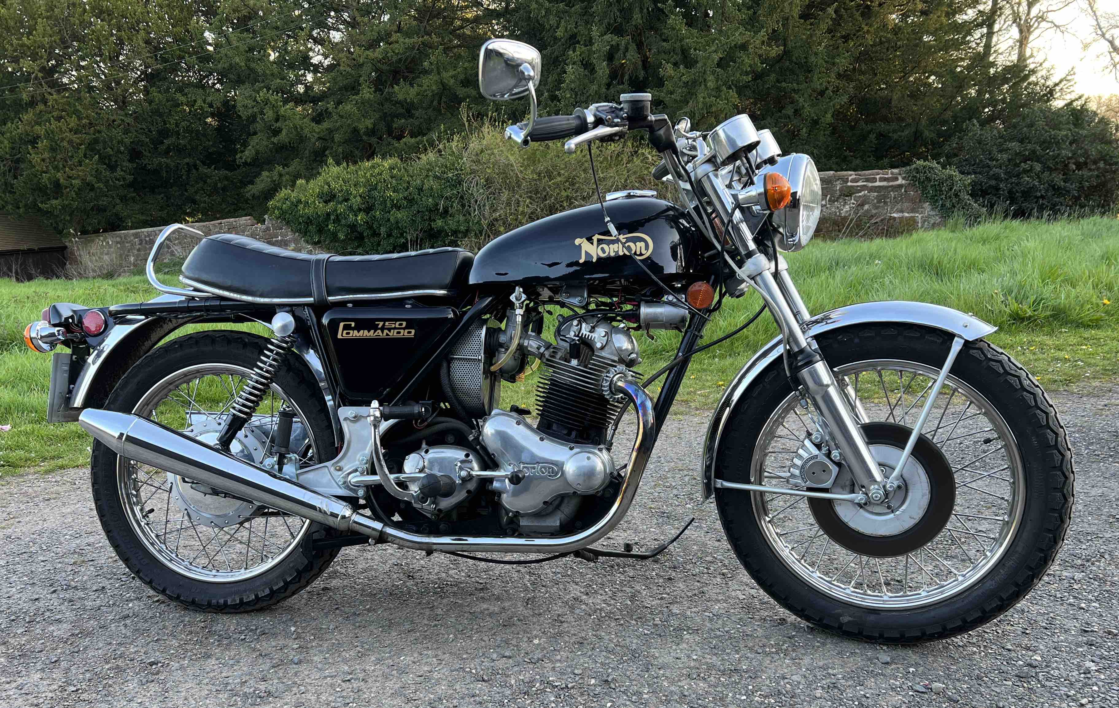

Just bought and well hooked!
Never knew that buying a Norton would open up a wealth of info!
1972 Commando 750, think it's a Roadster, pretty darned tidy as appears to have been so little used!
Last owner tidied the bike to really good condition, had it over 2 years, before that was laid up 30 years in a shed, just a bit of a black hole in the history from production till 1991.
V5 says registered 1991, so would that imply an imported one?
Can anyone advise a "newbie" on what data is out there and the best way to find this out? See there are multiple paid searches, just not sure where to go!
Any help greatly appreciated!
The new addition in the garage!
Hi Richard
Welcome to the club and thanks for posting the pic of your new bike.She looks pretty good to me even with the 'High Rider' style tank (which I guess 'floats your boat' so it's good for us too?)
Attempts to find a bike's history start with the engine and frame number. Your '72 Roadster was probably produced towards the end of the year when they were all fitted with the front disk brake. We offer members a 'NOC1 dating certificate' which can provide much useful information for only £30.00  Regrettably, our records are not 100% complete but we should be able to help. You may find that the bike originally was delivered as a different variant but that's less important than your enjoyment of the ride.
You'll find that there's a wealth of information about how to look after your bike on this website and I can recommend searching the 'Roadholder Index' and the Technical pages. We also have links to 28 local UK branches filled with like minded owners who can offer support and a social framework in which you can show off your new Pride and Joy.Check out your local "Shenstone Branch" website here.
The 72 was fitted with a disc brake when the Combat option was selected, late in the 72 run everything got the disc and the Combat was detuned. If you can post the first 3 digits then we can see if its early or late. Of course a disc front end could easily have been fitted later on in its life to repair a damaged drum front end.

Lovely looking bike, I like the High rider/SS tank, I have one of those tanks in the garage for a project if I ever get round to it, is your tank steel or fiberglass? Best keep a close eye on the fuel level as it soon empties in these small tanks, I`ve run out on a Roadster more times than I care to remember!

Frame / Engine no's match and start 210xxx, any data appreciated!
Wet sumping, as have ownership of an A10 Golden Flash well aware! Total ignorance of the issue till took ownership & tried to start after years of storage!
Tank is a fibreglass, but appears to have liner coat installed, hope it works as read horror stories over ethanol! Must find what original tank was like and try and find a steel one.
Only issue at the mo is carbs to be setup & ignition light permanently on, seems to be charging as ran 19 miles today for MOT and back, 12.4 volts in battery seen after switch off, so wiring diagrams to de-cipher!

Watch out for reproduction petrol tanks from India, they usually don`t fit and are the wrong shape, often looking very square edged.

Last Combat was prior to engine No. 211110, so you need to check if yours is a Combat. Look at the carbs, are they 930's or 932's.
Best current Roadster steel tank is the Emgo one made in Taiwan, several people stock it.
