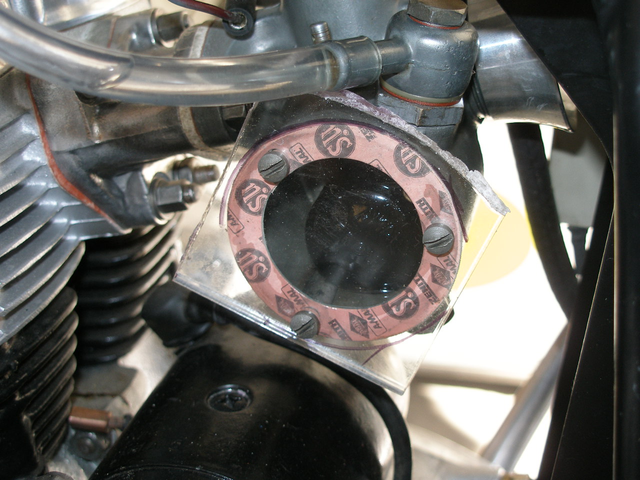

We had a similar issue. We…
We had a similar issue. We put a perspex side on the carburetor to see what the fuel was doing (see photo) and that's when we found out that the little hole in to top of the tickler is actually the vent for the float bowl. Fuel was coming in but couldn't displace the air so once it had run off the choke it would die. We cleaned out the tickler and it ran perfectly. Fuel should come up to the little pip below "Amal " on the cover. you can see our before and after photos here.

Ian that's interesting, I…
Ian that's interesting, I'm running a new concentric rather than a monoblock, but it's worth checking. I've changed the plug caps this evening and that's made no difference. I've also changed the main jet from 130 to 140 then to 120 and that made no difference either so I'm certain it's not a jetting issue. I've booked it in for an MOT tomorrow so if it passes I'll be able to give it a better run.
