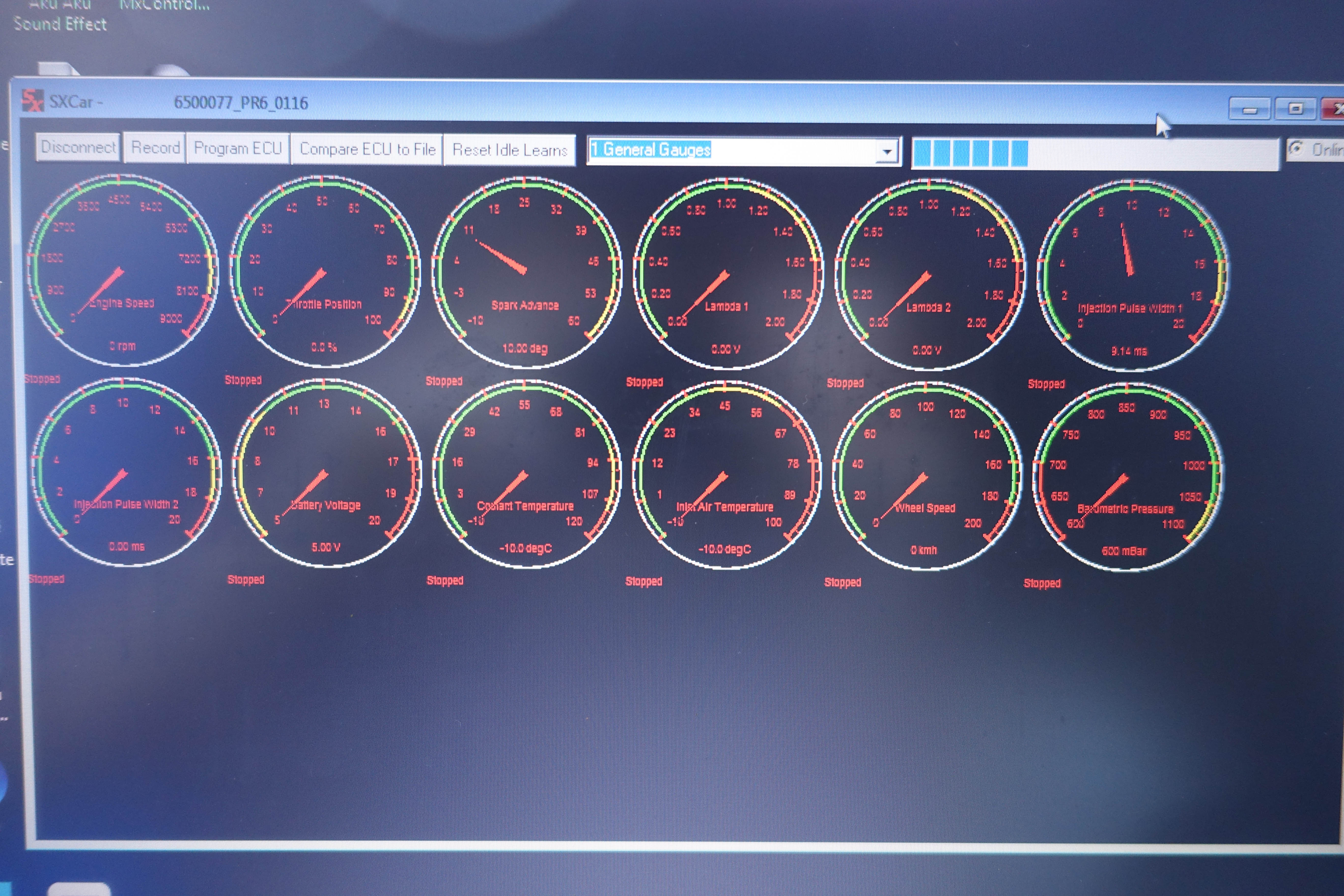

There was more than one make of ECU (SCC and Omex) depending on when your 961 was built. The SCC ECU is more accessible than the Omex and some folks on the Access Norton forum have reprogrammed theirs using software that is available from the supplier, having had the supplier unlock the ECU. Even if you don't change anything it's useful to have the software to see what's going on. I've included a couple of screen shots from when I had it hooked up to my bike.
A few years ago I asked SCC whether any settings were learnt and retained in the ECU and their reply was "Aside from referencing the stepper motor for idle control on each switch off, no."
There is also information on Access Norton about fitting a battery isolation switch, and tracing parasitic battery drain (which should ideally be around 1ma).
