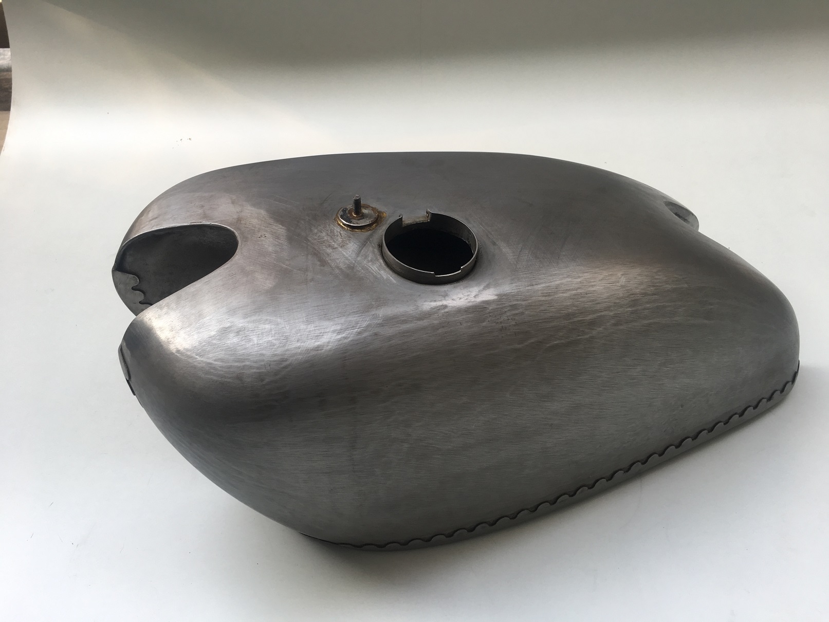

Thanks. I add some photos I got from them to this message.

Attached are some shots of…
Attached are some shots of a tank I acquired a few years ago. Before and after stripping and straightening. Note the way it's formed in the front with a crease running back and down. Also shorter in rear on right side.

I've not handled any Indi…
I've not handled any Indian Inter tanks but have examined a number for the other pre-war singles.
The biggest problem in giving an answer is that there is no one single 'Indian' manufacturer - and they are not made on press tooling so that introduces another variable.
My impression is that there are three or four companies 'commissioning' tanks, eight or ten attempting to sell them internationally and that behind this there will be a quantity of small workshops who may be working with skilled craftsmen or just as easily subbing the work out with little supervision.
The claimed quality control is often not there - If it was then they would all fit as they are all alleged to have been tried on an actual motorcycle.
It's impossible to generalise and some are probably quite good - but it's a lottery unless you can find someone importing them and offering some post-production quality control.
None of the traders are really putting a good name and a reputation on the line so it remains a case of 'Buyer Beware'.
