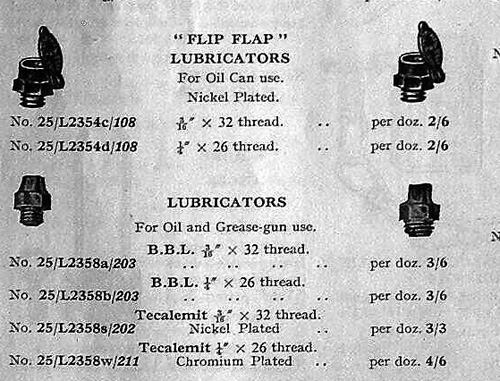

Do you have Flip-Flap lubricators ?
Oiler
Thanks chaps, I haven't greased hubs on my other bikes with 'normal' grease nipples for the reason you mentioned - lubricant on brake linings is no good thing.  Richard, I have Flip Flap lubricators by the looks of the picture you sent.
