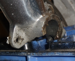

When taking the spindle clamping bolt out from the n/s fork leg, the bottom part of the fork leg fell off! It has been completely cracked and the bolt was all that held it in place. God only knows what would have happened if the spindle had come away when I was riding it.

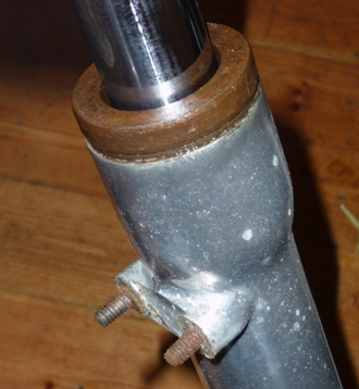

Thanks David - the clamp area has fractured and the circular part at the outside where the spindle goes through the leg is whole. That part doesnt look too substantial - I'll take a couple of photos tomorrow nd post them up. If its a common problem there may be a common fix?

Pinch bolt side fork sliders are often broken because people overtighten the pinch bolt. I replace broken ones rather than try to weld them as they tend to crack easily near the weld.

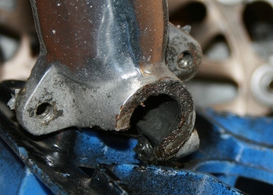

And the other photo!! Atta…

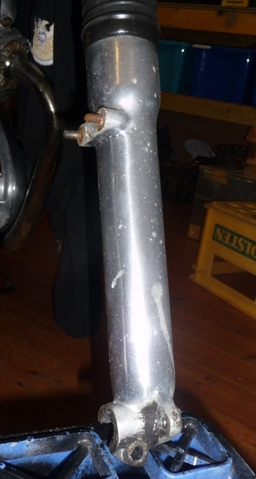

Alan, Would you post a pic…
Alan,
Would you post a picture of the whole slider, clearly showing the top and mudguard stay mountings.

Chris - here's the photos.

Hi, looks a dodgy casting…
Hi, looks a dodgy casting to start with. Notice the granulation. I have seen Norvil selling a cracked leg on eBay for £200. Gets your money back towards a new one. I have just bought a complete set of Disc forks on eBay in the States for £160, with yokes. If you repair it, then weld reinforcing gussets to it, otherwise scrap it. Best regards, Paul.
