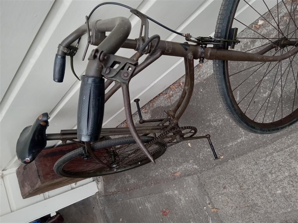

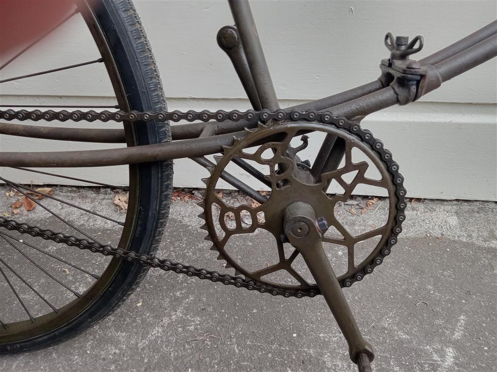

I have a nasty old Lycette saddle that I can cannibalise if need be.  The old girl has come back to life but I would like a more period saddle than the Brooks I have now. An original BSA saddle seems to be way out of reach.
front
