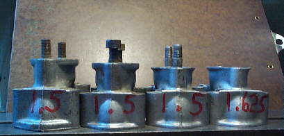

The 1.5 spacing is for pre…
The 1.5 spacing is for pre 60 head R12/136
1.625 is for the 88SS/136 head normally 61&62
All of the manifolds below use isolators at the head

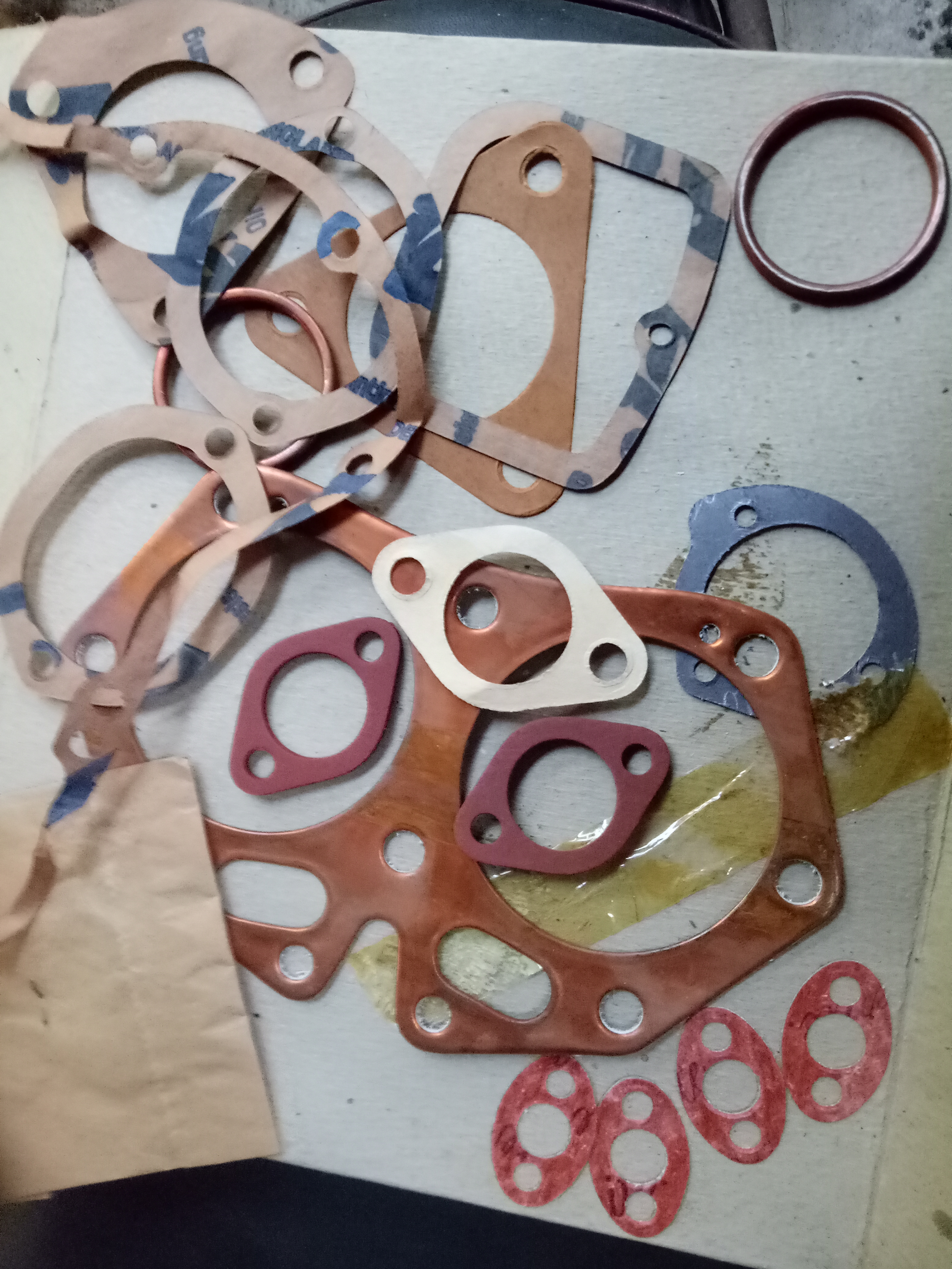

Gasket kit for all twins up to 1958
Attached is a photo of an original Payen gasket kit for all twins up to 1958 for Models 7. 77, 88 and 99 (1956) I opened today for use on my Model 7.
It clearly shows the two heat resisting washers which are fitted between the head and the aluminium manifold and the paper gasket which is fitted between the manifold and the carb
