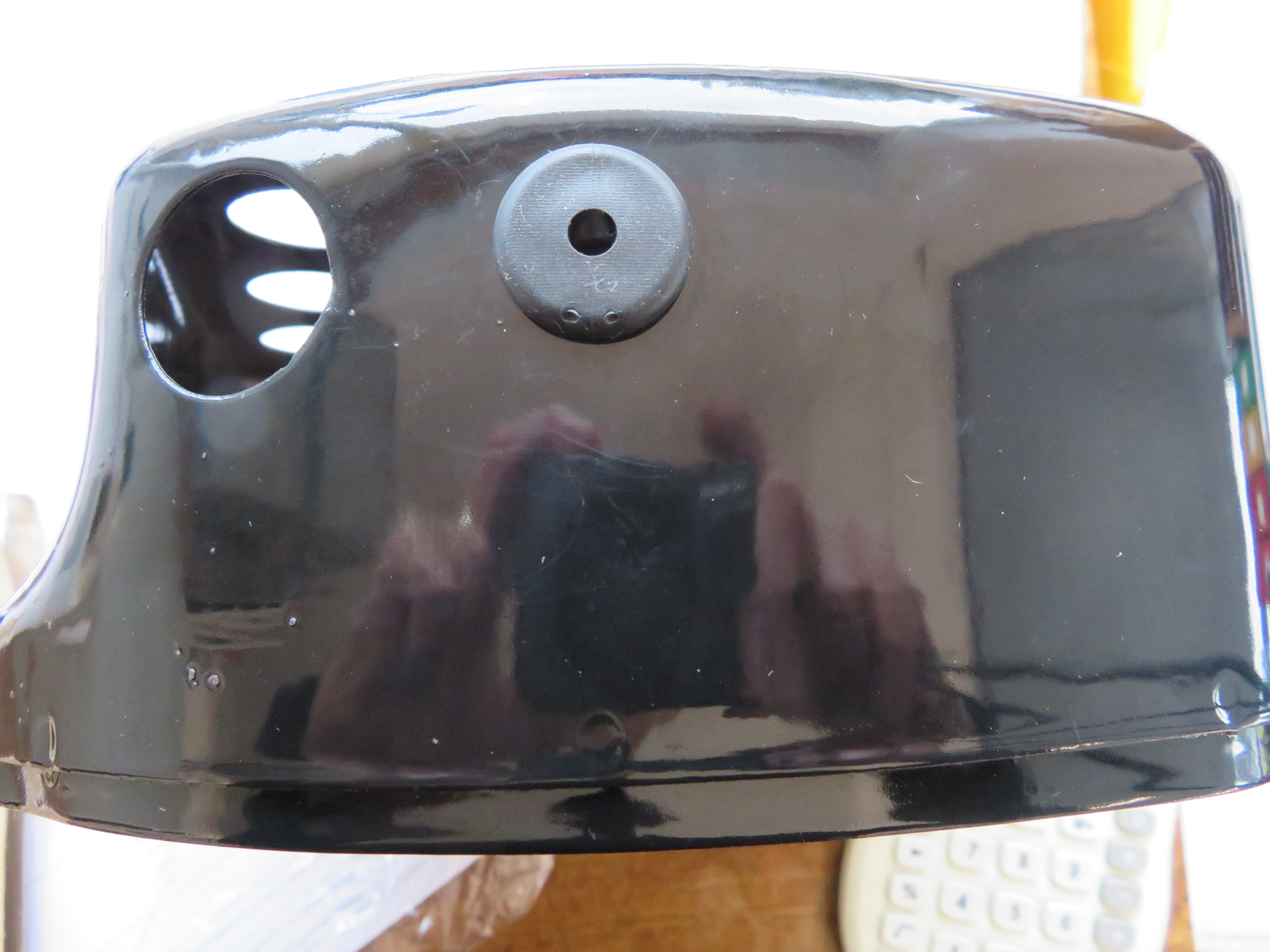

I have a bit of an issue finding the correct grommets for the brake stop switch/rear light cable exit and entry holes on the rear mudguard for my 650SS. I need to drill the holes myself and don't want to make the wrong sized hole. In the parts list No 067655 is mentioned, grommet battery box and mudguard. This has an OD of 7/8" and ID of 7/16". It seems a bit large for two small wires to the rear light. Norvil have suggested 060811 as an alternative. This is listed as an oil tank grommet for a Commando. I do not have any dimensions for this but it again seems a bit large on the pictures on the AN and RGM sites. Norvil have also mentioned 826320 with an OD of 3/4" and ID of 3/16". This ID may be too small (see picture). I have also found 064152, for a Commando rear light with OD of 9/16" and designed to fit a 3/8" hole. The mounting holes for the mudguard are either 3/8" or 1/4" and this grommet would seem suitable.
It might be easier to go to Halfords and get some metric grommets and drill holes to fit but I am trying to keep the bike in standard spec to make it easier to replace bits in the future.  Unfortunately I no longer have the original guards and can't compare with those.
Does anyone out there know the correct part number or have an original mudguard on which they can measure the grommet size.
