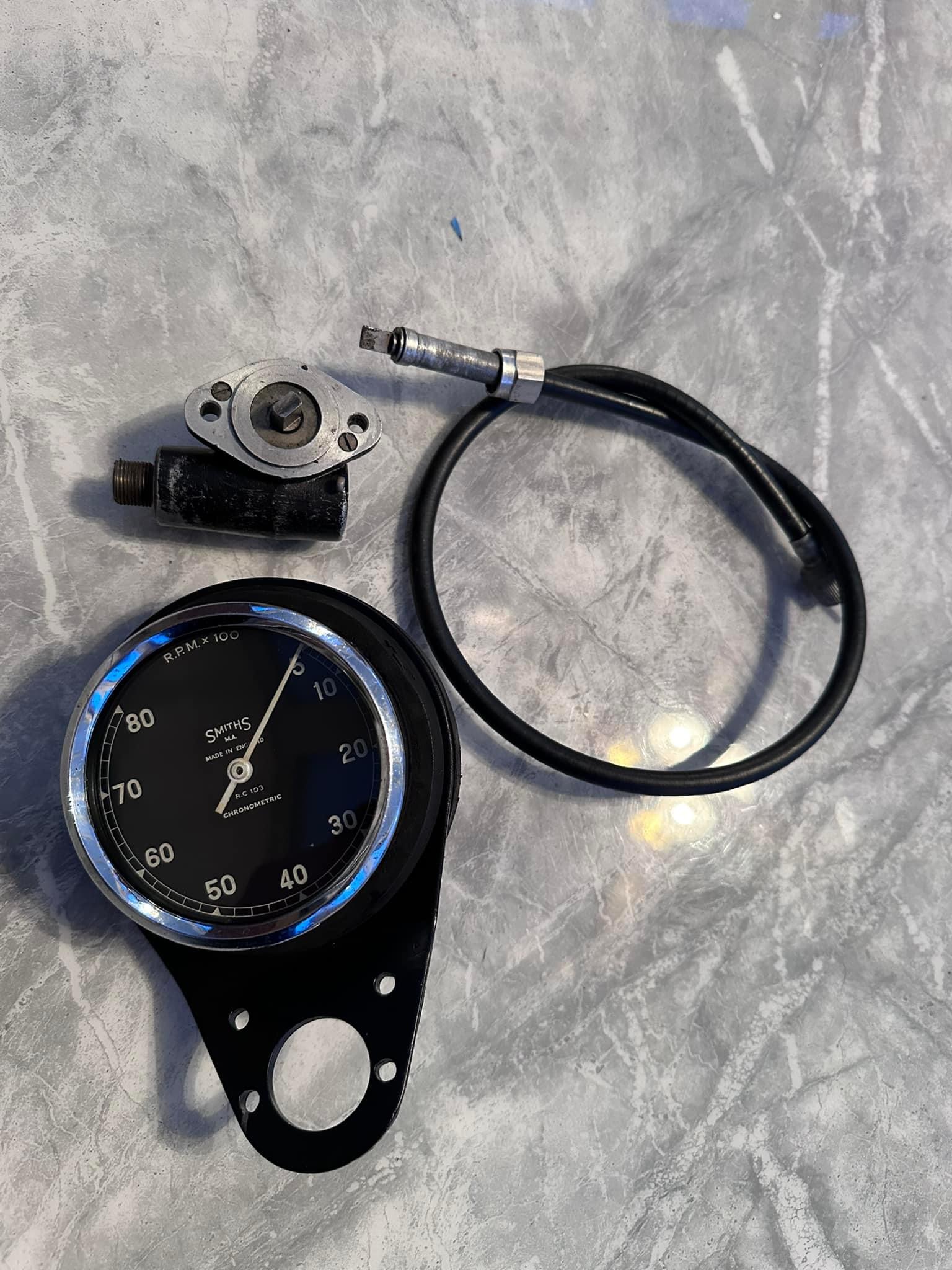

Most Manx’s used a 4:1 Tacho. Whether that was a Chronometric RC95, RC103 depending on whether it was ran off the Cambox or timing cover, one was anti clock and the other clockwise.  The later conical ATRC rev counters were also 4:1.
All with a 2:1 Drive,
Heres a kit I had for a Manx not long back, ive still got a special Manx tach drive with the long shaft for cambox applications.
