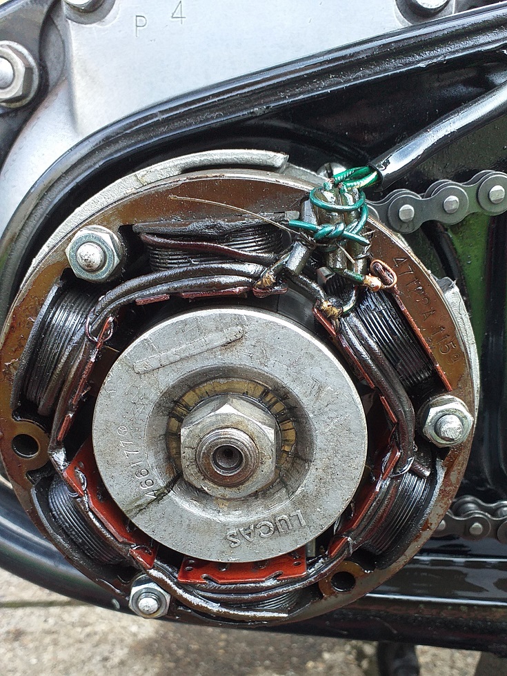

I opened up the chain case to do some maintenance today and the ES2 has still got it's original 6v alternator, it's is in a pretty poor state, the wires are all cracked and have been badly repaired in the past. It's now looking like I will be going 12 volt, I've got an old Commando alternator which is quite usable. Zoom in to the picture attached and look at the wires where they exit the alternator to see how bad they are. Its's amazing it worked OK like this.
I can rewire this stator with regard the wires that go to the out side, but I would be far more concerned about the state of the coils, as all the shellack/insulation is burnt, so it is a wonder it still worked.
In reply to by alan_osborn
Hi AO, yes thanks, I have indeed put two new leads on the old Commando stator that I intend to use on my ES2, which was only removed from my Commando because the wires had gone so hard and brittle. The old 6v stator is now a museum piece.
Those gaps between coils and rotor look very big. Are they, or is it a trick of the light (or angle of view)?
Hi David, it is a trick of the light, the gap is between the rotor and iron posts of the stator which are very close. I have pointed out on the picture so you might just see.
