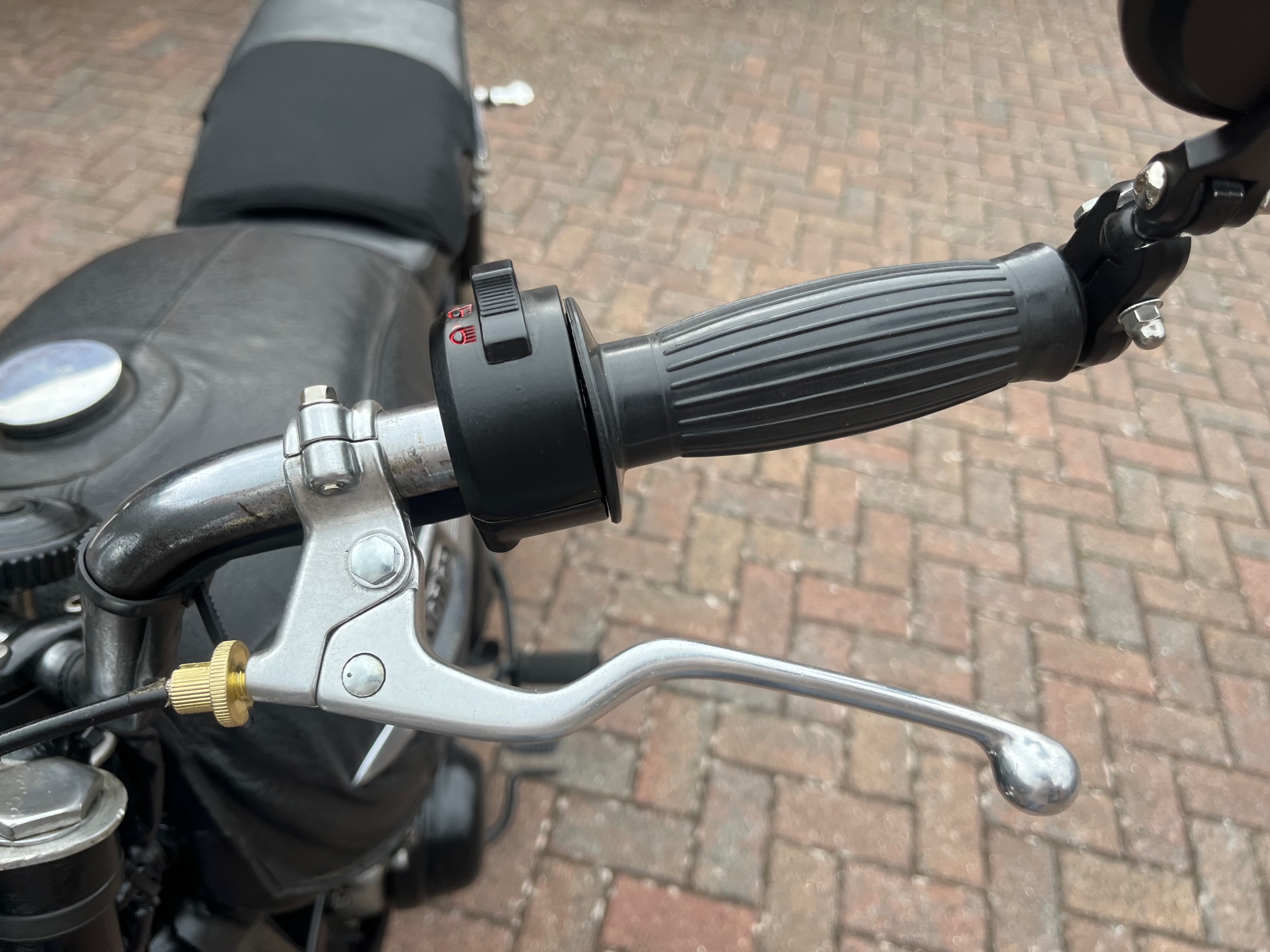

Slipping clutch
Graham,
In your photo some suggestions.
The cable outer looks very second hand where it goes into the adjuster.
The lever looks hard up against the lever bracket, as though there is some residual tension in the cable. You need free play.
The slot on your cable adjuster is vertical. Try arranging so that the slot is back facing. This gives a much better path for the cable inner as the clutch is operated.
The locking ring goes against the bracket as I'm sure you know.
Anything that results in residual tension in the cable inner, like a few broken cable strands, will tip the clutch towards slipping.
The cable is a much simpler fix and I hope it works for you.
There is actually free play,…
There is actually free play, about 5mm, it just doesn't show in the pic. The cable's ok, albeit a bit tatty on the outside and it's lubed. I don't think it's the cable.
