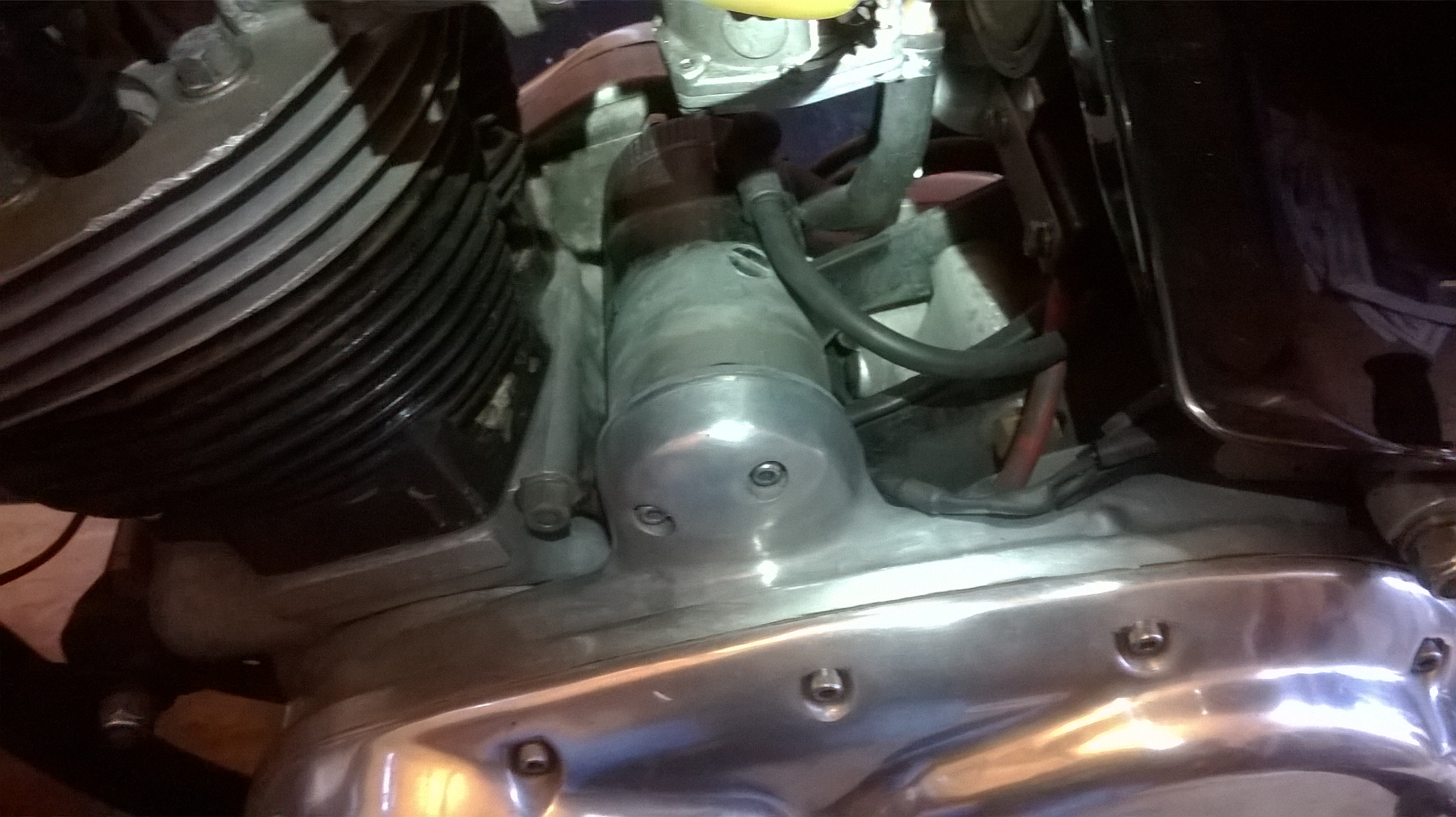

Yesterday i had the unfortunate experience of one of the two fuel pipes that attach to the SU carburettor come adrift and dump the best part of three gallons of petrol from the left hand side carb spigot. Very lucky not to set fire, and after begging a length of lockwire from the nice people at Teesdale Motorcycles in Thirsk, wired the pipe back on and filled up again to get home.
What a smelly mess its made. Totally stripped the paint from one half of the starter motor, better than using Nitromors! Turned the powder coating on the gearbox cradle, swinging arm and frame a yucky grey colour as well as cracking said powder coat (to be fair the powder coating wasn't very good quality and was on the bike when i got it) The petrol spigots on the SU do not have any barbs on them. I have replaced the pipes twice before when they lose their flexibility and on reflection should have done so again this winter. To any other owners of SU equipped bikes, wire the pipe clips together to prevent pipe and thus fuel loss

Seems to me Peter you had a lucky escape with the bike not going up in flames, I've seen it happen with much less encouragement. Did your starter motor get filled with fuel ?.

Dunno yet Sam I,ve yet to…
Dunno yet Sam
I,ve yet to take the starter motor off. Was busy trying to eliminate the petrol stench in my boots as the left one got a good spray of petrol for a few miles.
