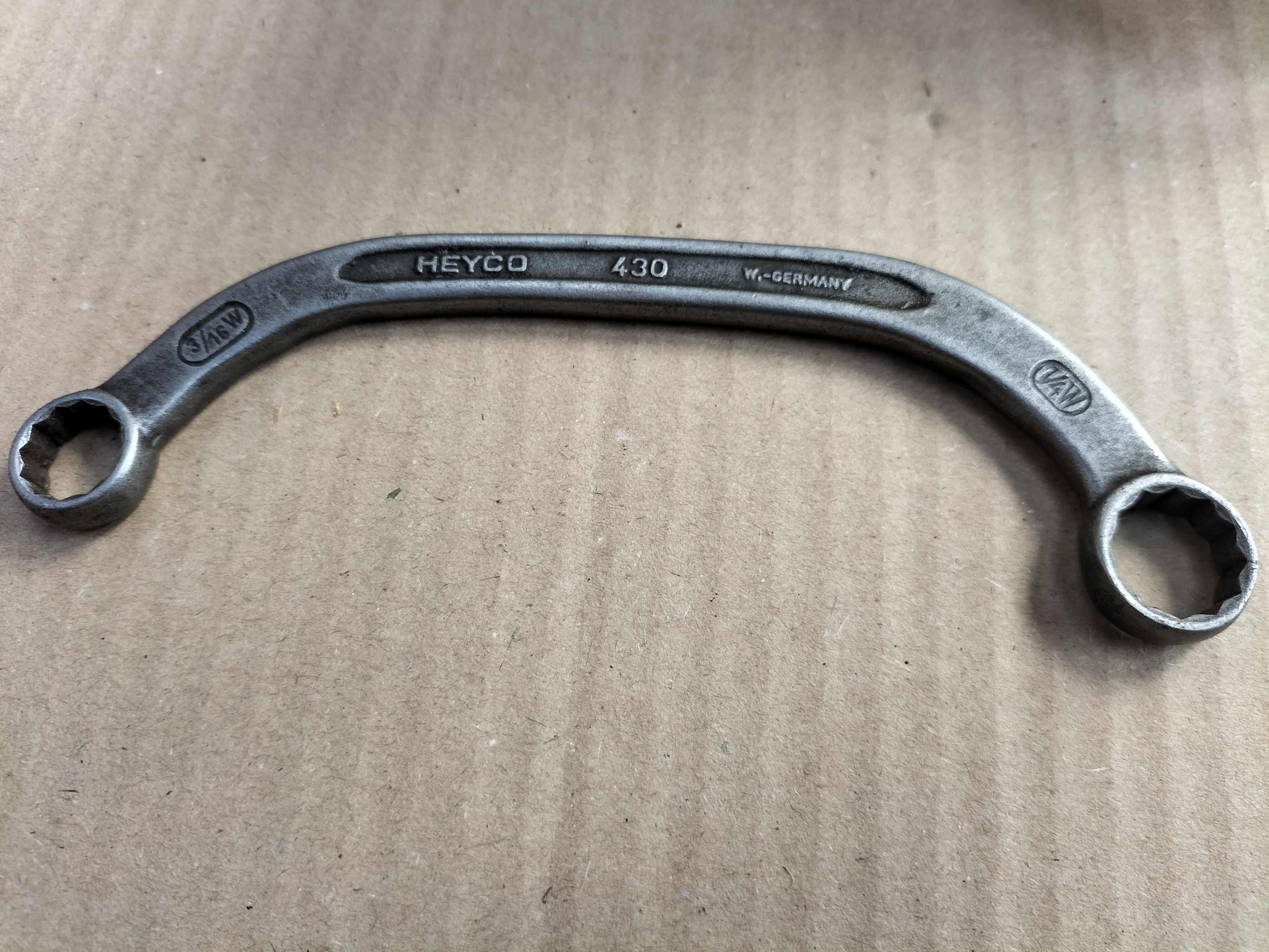

You need to get the extended magneto bolt. (Available from the usual suppliers). RGM part number is DE44.  Fits underneath the magneto and the hexagon is easily reached from near the points cover. Makes removing the magneto a doddle.
The spanner in the photo also greatly facilitates undoing the bottom nut.
