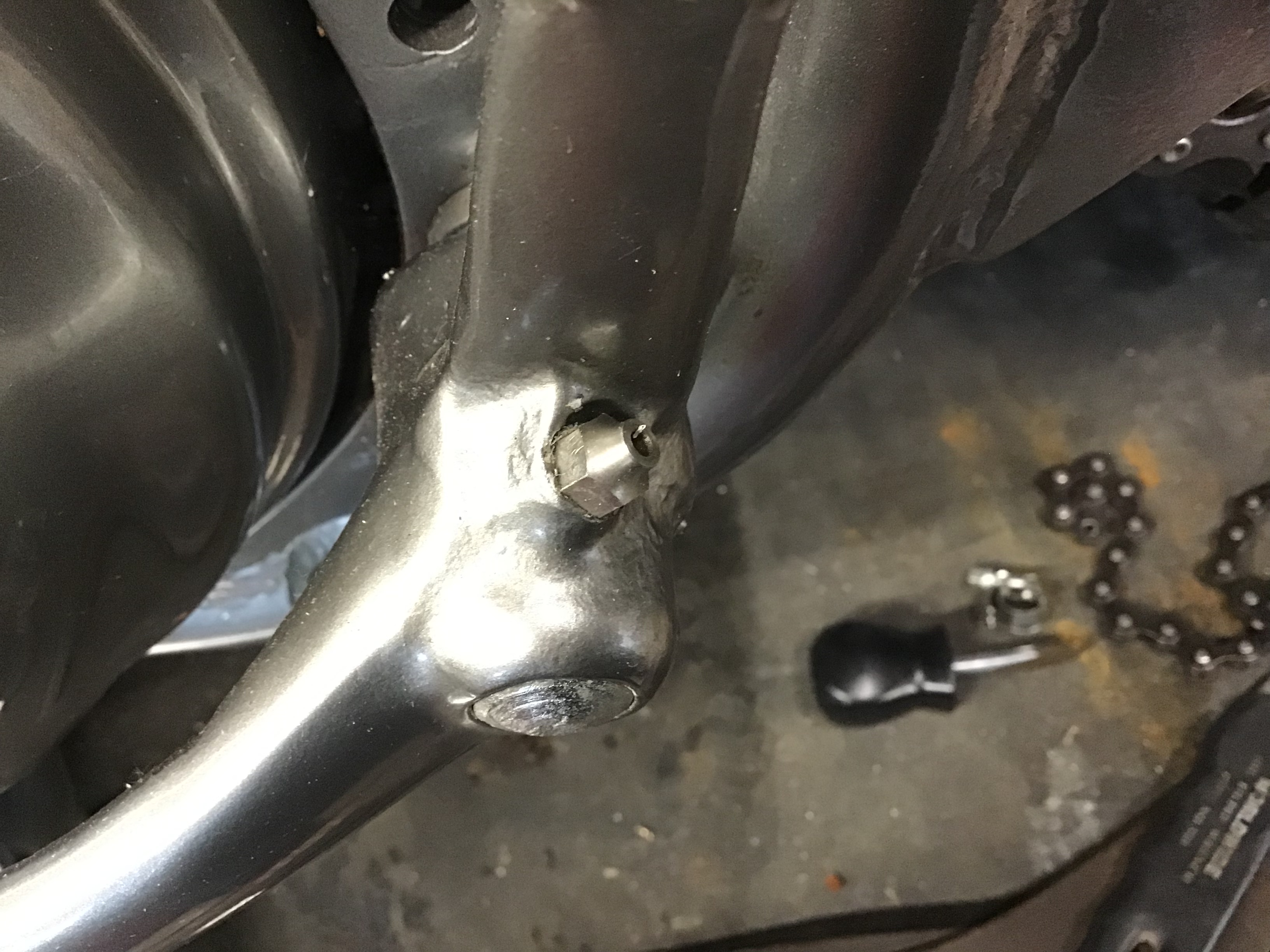

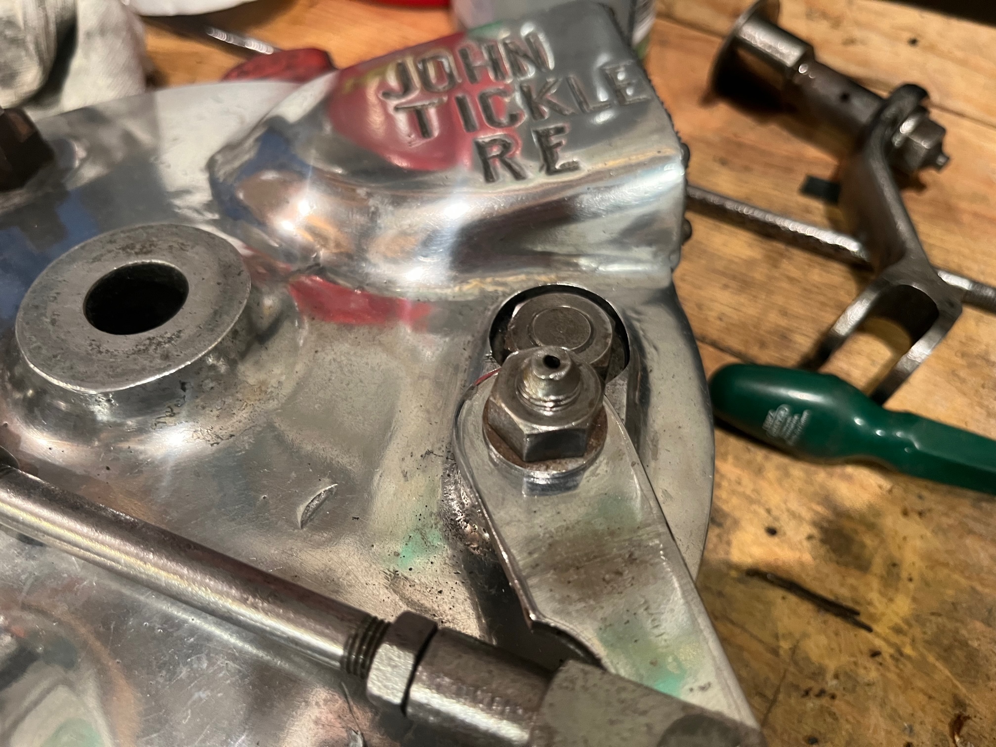

Whilst taking the front and back brakes apart to service them I noticed these, which I assume, are grease nipples on the end of the spindle bolts, only they're not actually nipples you can attach a grease gun to.
I cleaned them out with a thin wire. They were caked up with old dry gease. The thin channel that runs through these bolts is obviously to grease goes the spindles but I can't quite figure out how you'd inject the grease or what with?
I'd also assume they should have some kind of rubber dust cap to prevent ingress of dirt and dust.

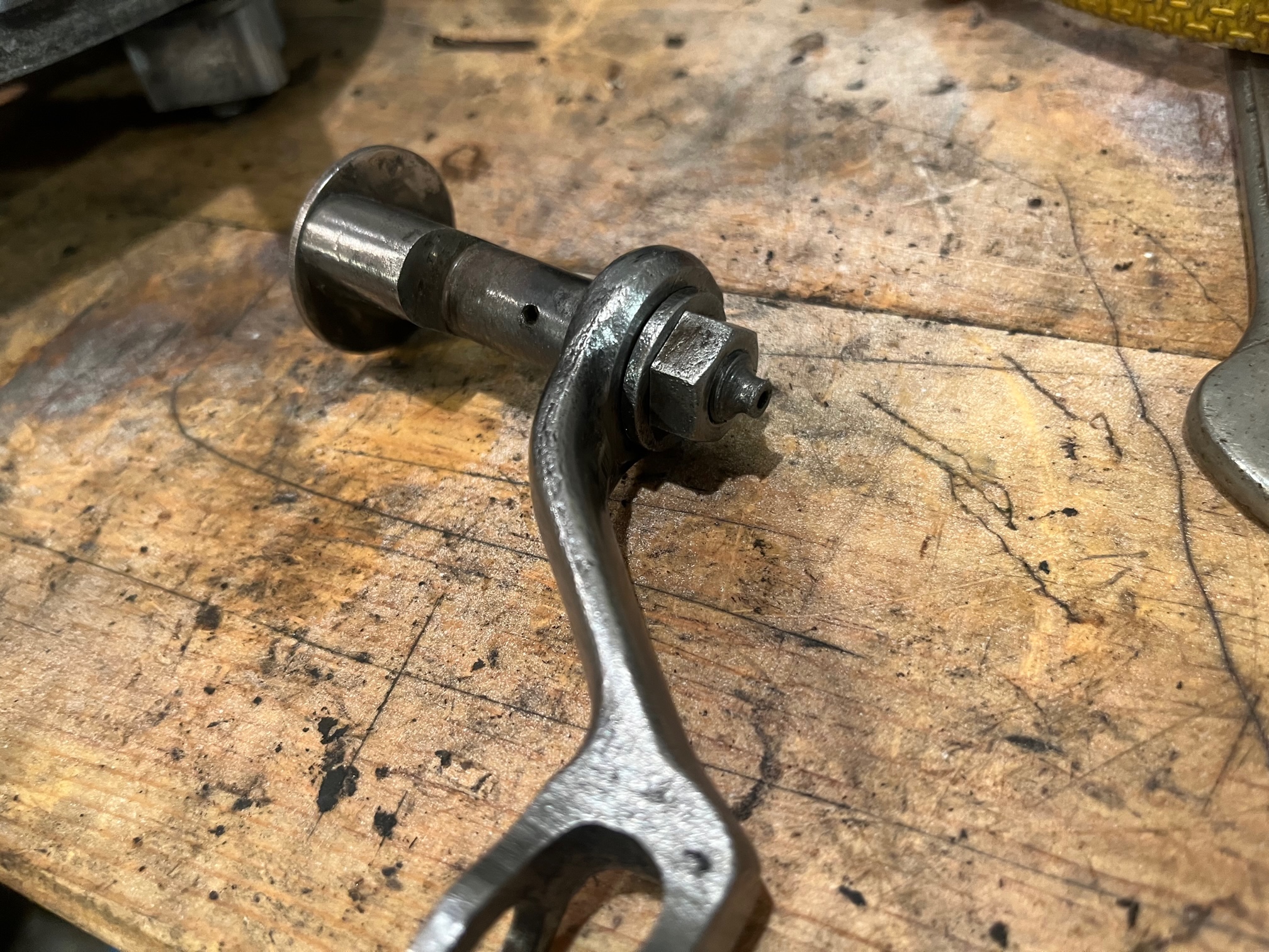

Hi Graham, they are indeed grease nipples and yours have been badly abused when dismantling. There should also be another on the end of the brake pedal securing bolt.
They need carefully drilling or filing out.and and all scarfed removed before greasing.

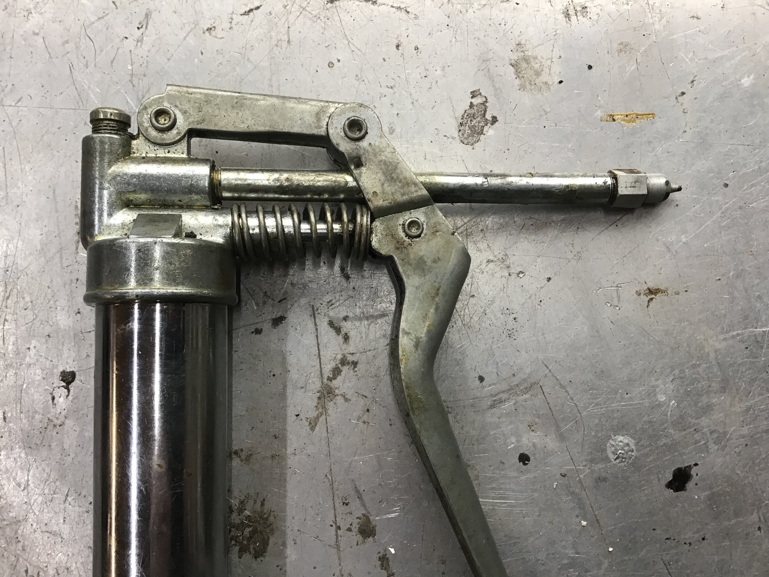

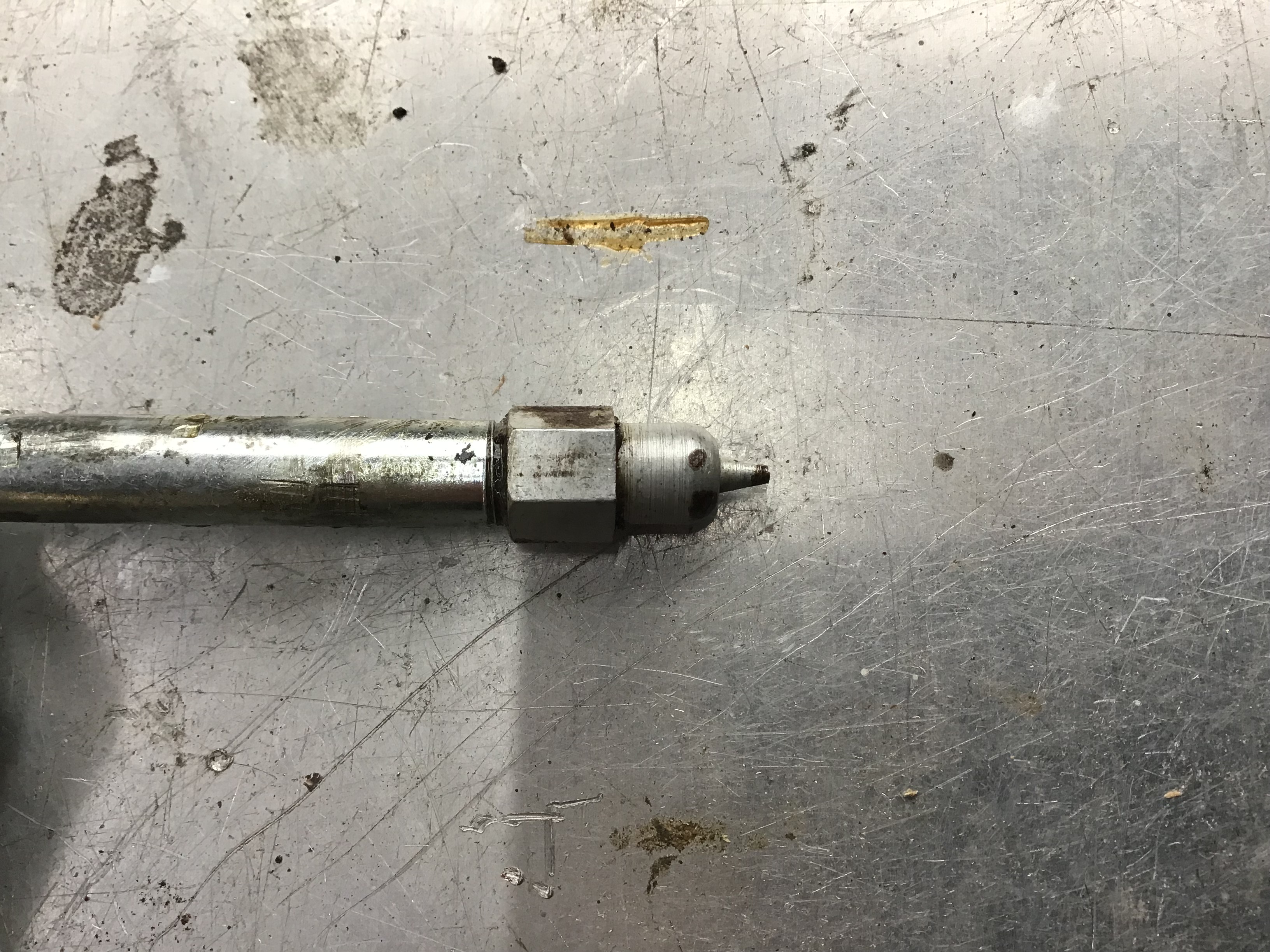

I bought my grease gun in 1962 when I bought my Dominator 99 but have no idea if they are still available. The tip could be easily made if you have access to a lathe and a suitable tap to suit your gun.
