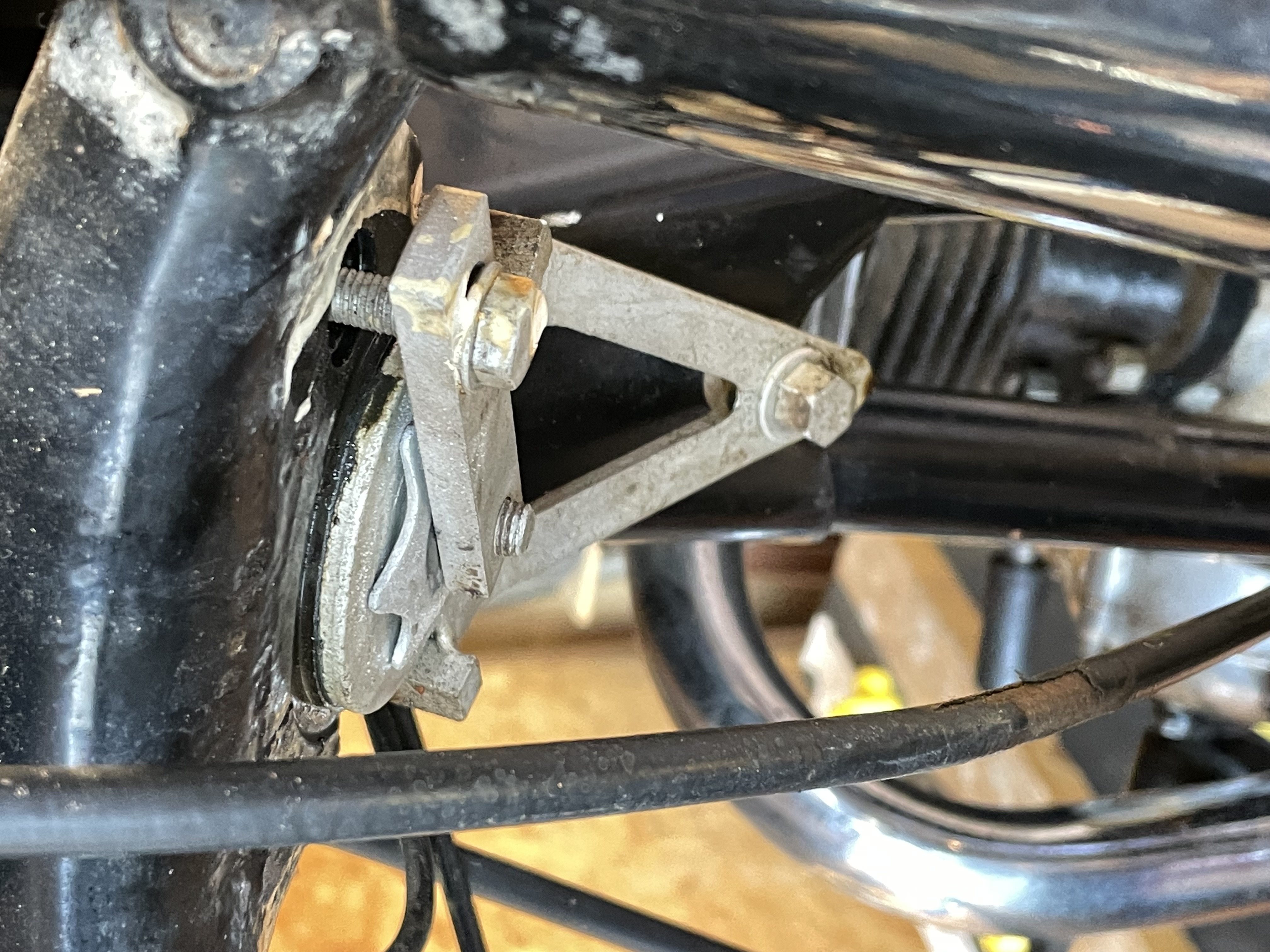

Kit, the steering damper you show on your images is a Norton Accessory that was available as an extra from 1962 for the SS Solo Models.  The kit had Part number SD/4 and with all the fittings it cost purchasers a measely £1 6s 8d.  regards, howard
Damper not really needed for solo riding but very usefull if leaning the bike against a lamp post ,tree ,wall or inside a van ,     locks the steering. Also cannot be ridden .anti theft !. Instant crash.
