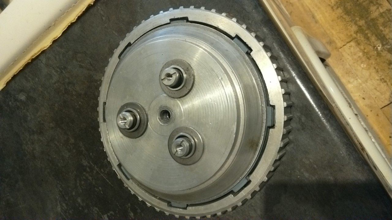

Belt Drive 2
Belt Drive 1
Is that a dominator clutch with a belt drive outer? Does it retain the kush rubbers? I cant see any rubbers from the picture, but if so... where on earth can I find one of those! :)
