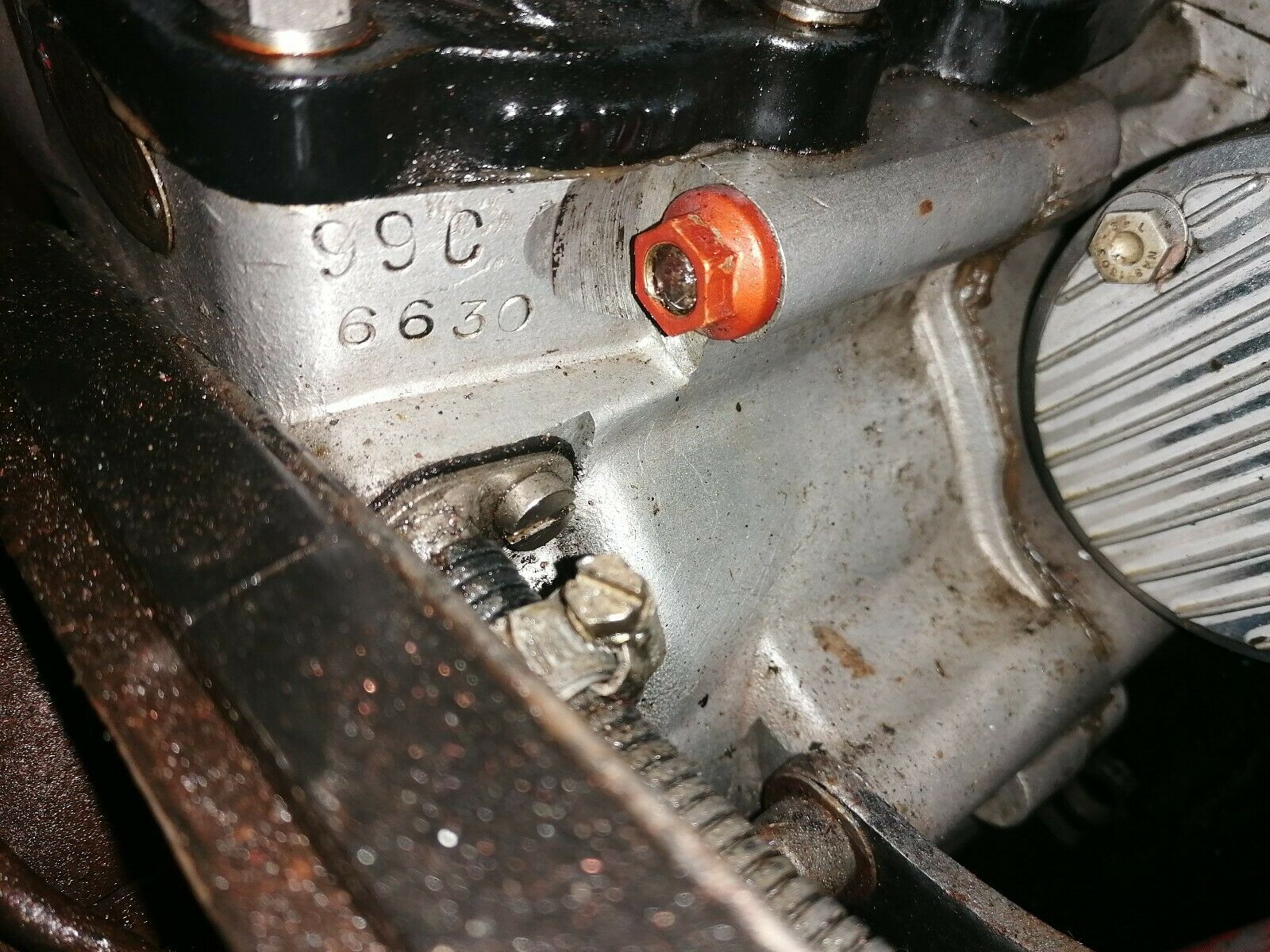

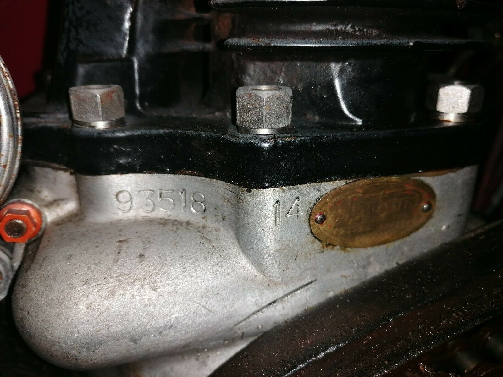

David......the attachments show the positions of where you should find the later 99 numbers.
If you could take photos in these two positions and post them,  those of us who know the engines well may be able to narrow down the producion date. Also include photos of the cylinder head from side and top. There should a casting number by the inlet cover.
