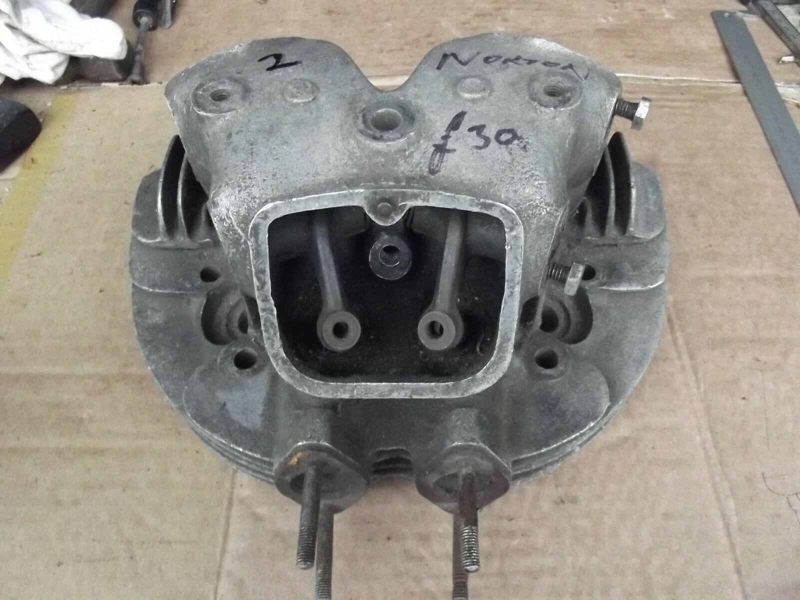

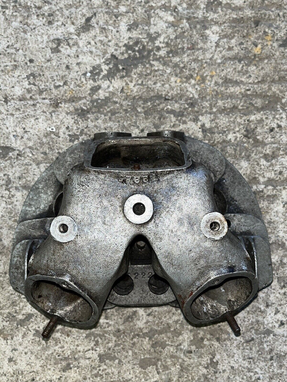

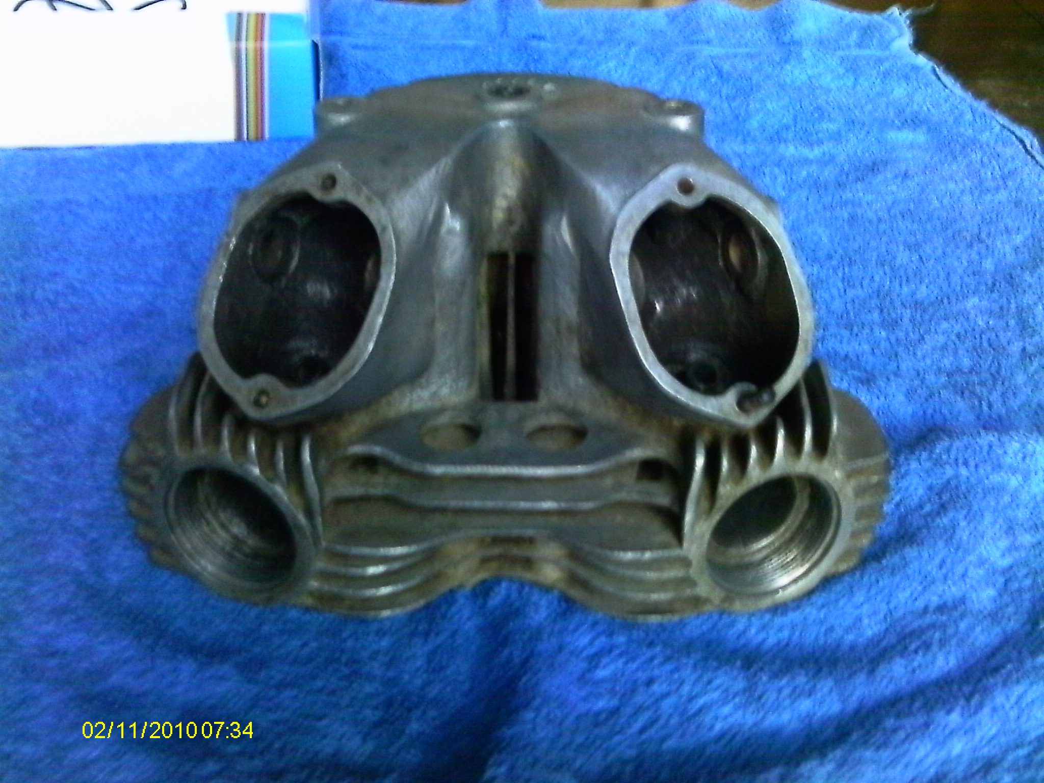

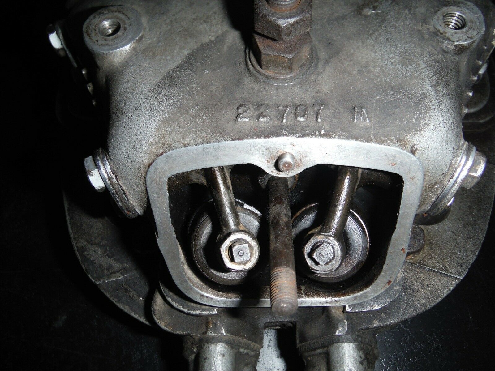

Hi Russ.........some photos of your 2 cylinder heads would help with your ID crisis.

Up until 1959, these heads had a casting number on the top........probably T2225.  After 1959 the casting number became 22707. But this head had vertical manifold spacings of 1 5/8". Plus just to add to the confusion, the first 650SS cylinder head used the same casting number but had a  different horizontal  twin manifold set-up and exhaust ports that were more widely splayed.

See the attached photos for a few ID clues.

FYI my "old" head has 'T 2225' and my "new" one shows '22707Y' although these may be casting numbers rather than Norton finished part numbers.
