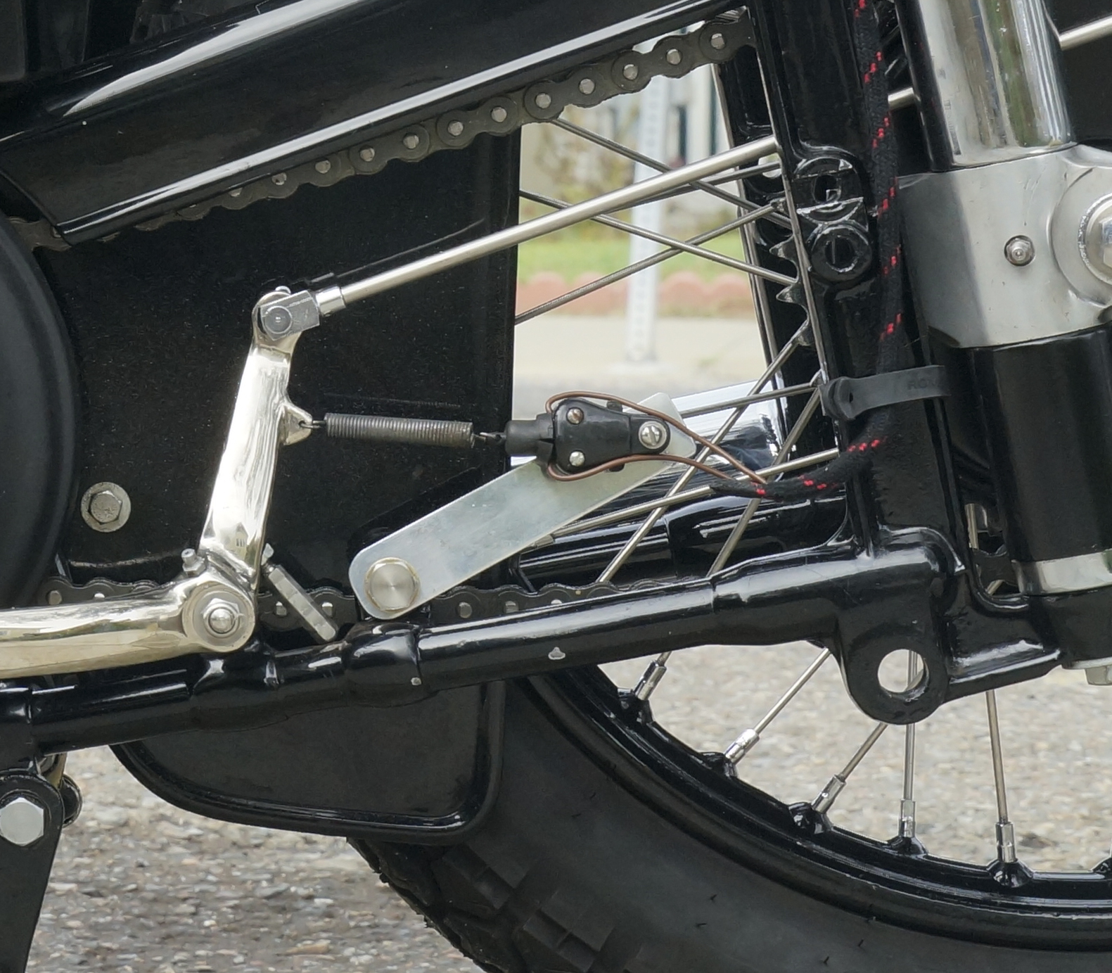

Here's what I did.......
One wire to battery and…
One wire to battery and other wire to light? I’m probably overthinking as I do with most things.
Thanks Michael.

NOC Spares supplied.....
....a wiring harness that provided for a brake switch. Doesn't matter how you hook it up as it simply interrupts the hot lead to the brake light. If you use this type of switch, be sure that it can pivot on its mounting screw.

On the rigids, the switch was attached to the brake rod by a small clamp and can be fairy well tucked away in-line with the rear mudguard stay.

....on my Inter:
