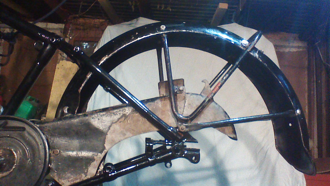

Hi Kevin
I have attached a photo of my mudguard. My Model 18 was made at end of 46, as a 47 model with teles. As you can see it needs restoration which I have recently started. Rear stay doubles up as stand, centre is of flat steel, front stays are round steel and two separate pieces. Hope this is of some use.
Dean Ghest

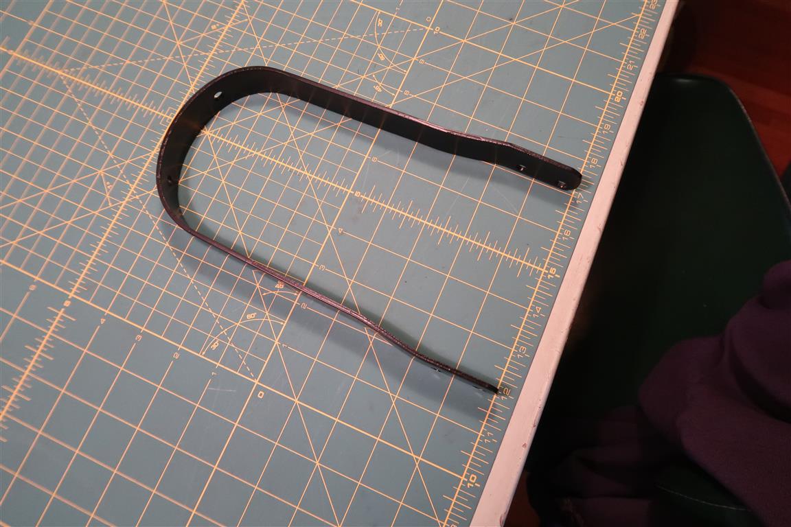

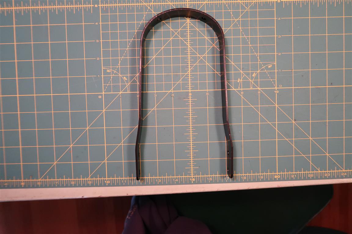

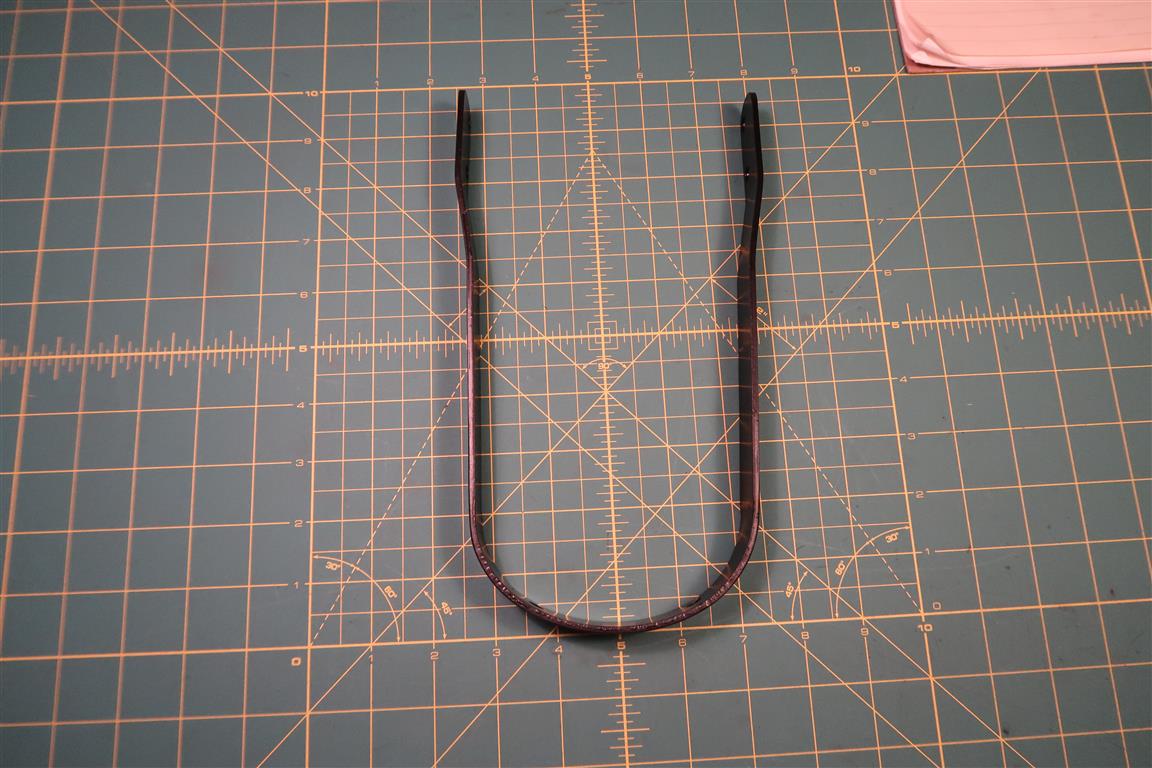

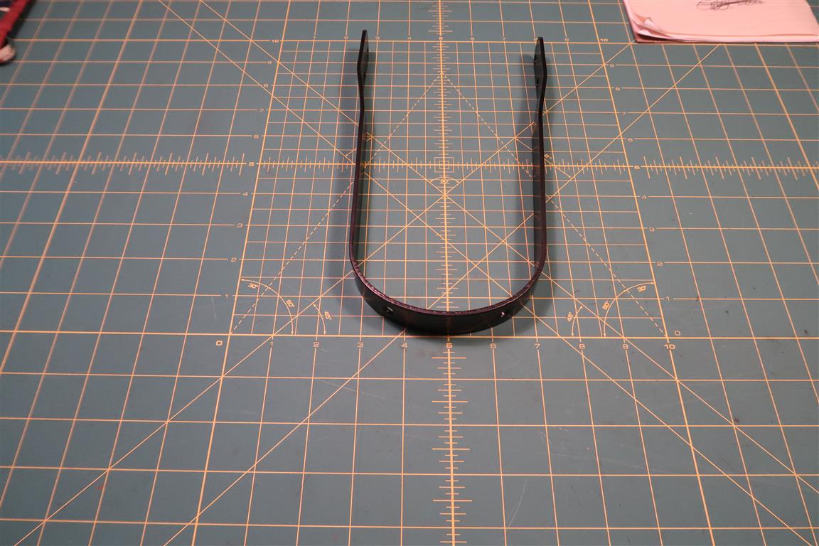

I looked and looked..............
...for the center bridge for my '48 Inter and ended up making my own. I first made up a pattern with light gauge aluminum and then duplicated it in steel, 3 pieces then had it welded. Came out nice. Toughest part was the top radius.
Hi Mike, Perfect, nice job…
Hi Mike,
Perfect, nice job. It’s looking like I might have to do just that for mine.
thanks guys for all the help I now know what I need to do.
cheers Kev.

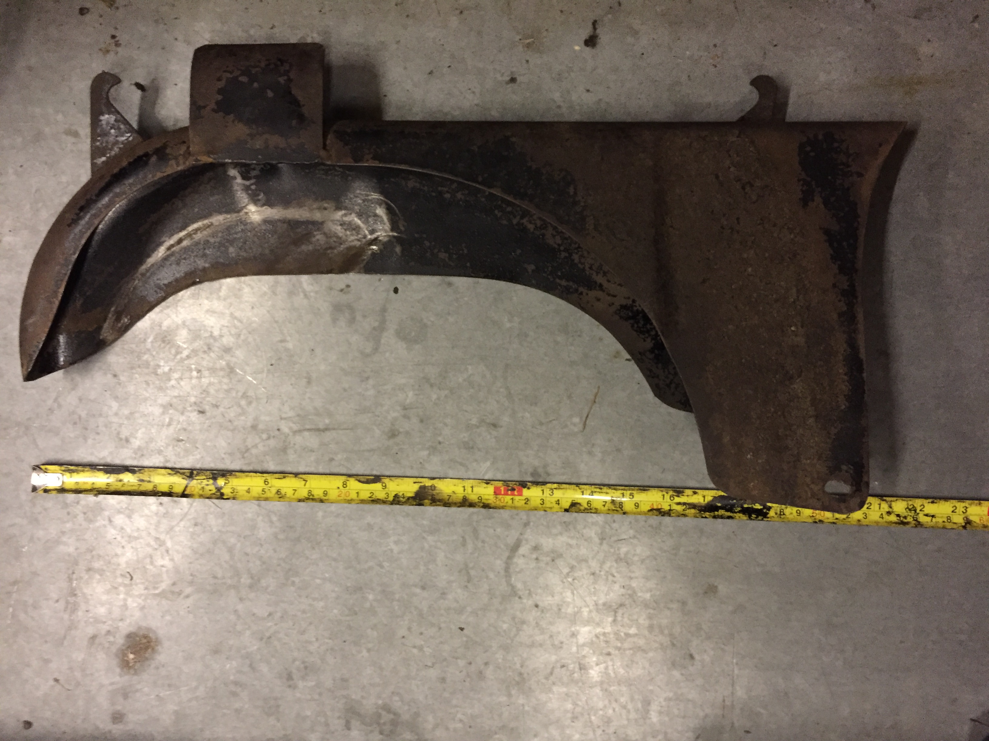

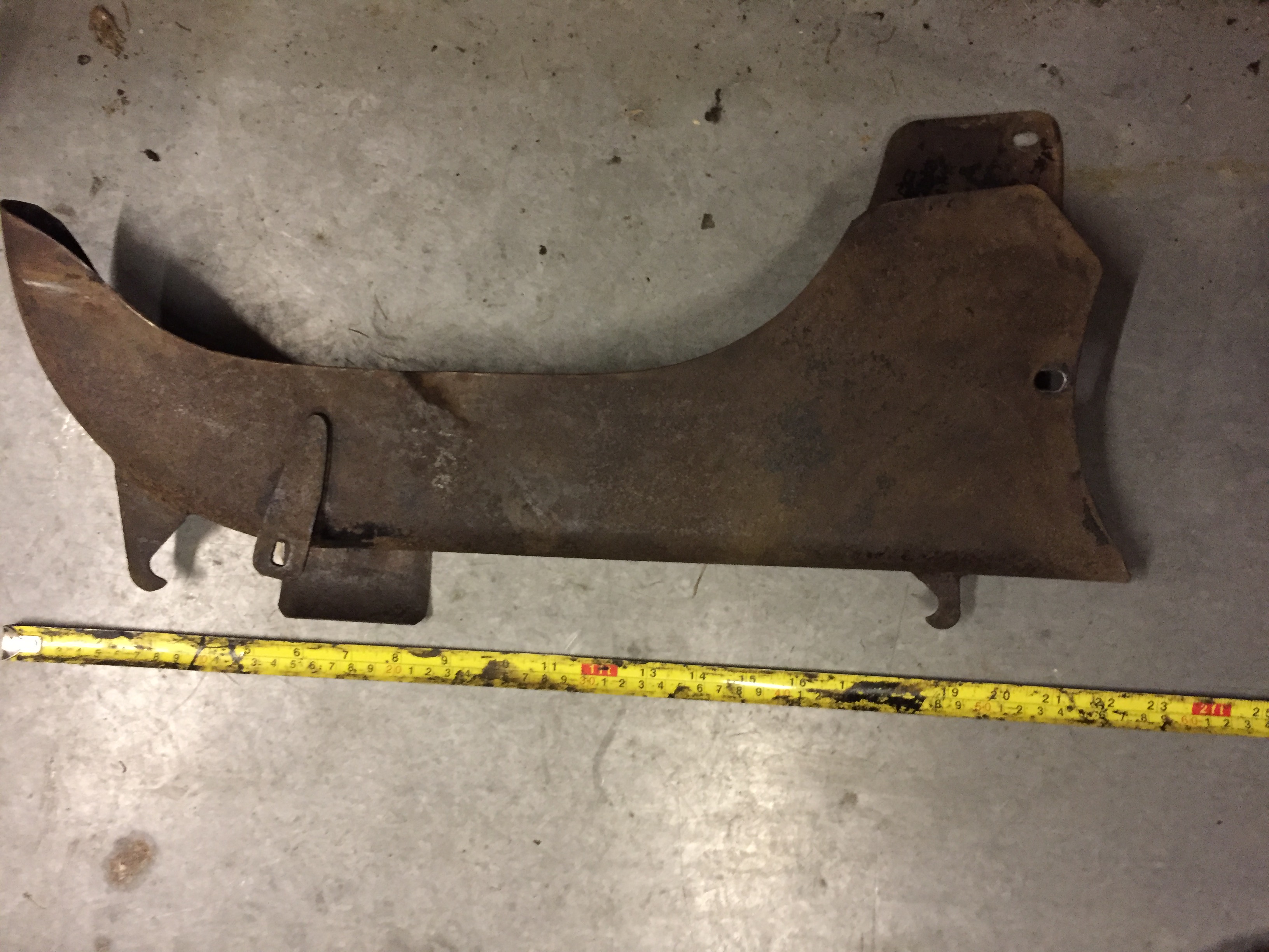

Chain guard
Hi Kevin
Here’s a couple of pictures of my chain guard. Excuse the state of the tape measure it’s the only one I could find! This came off my once assembled bike so pretty sure it is the correct one.
Hi Dean, Thanks for that,…
Hi Dean,
Thanks for that, looks like I have correct chain guard.

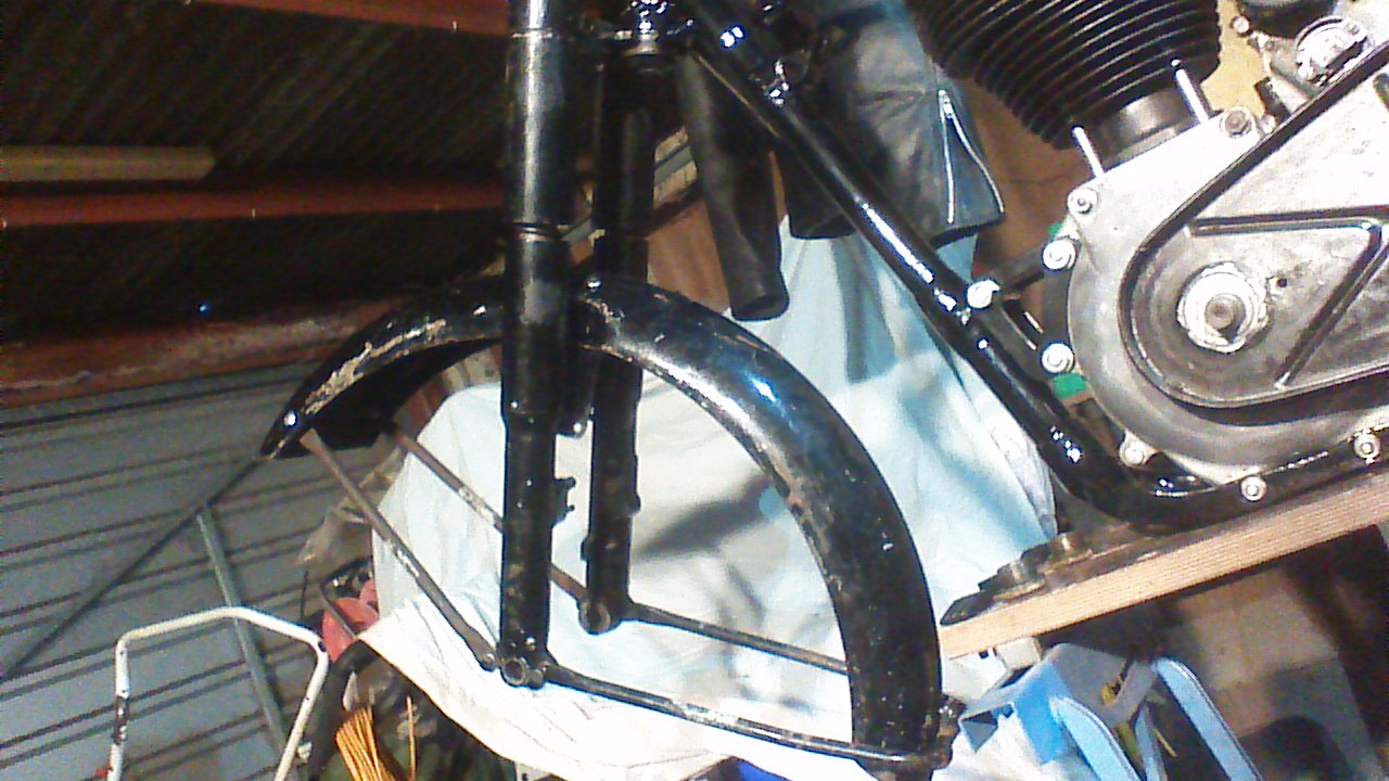

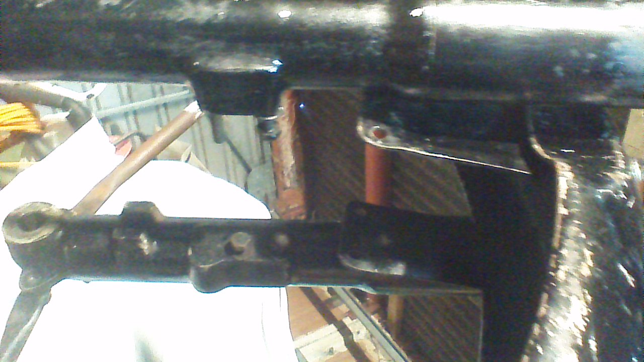

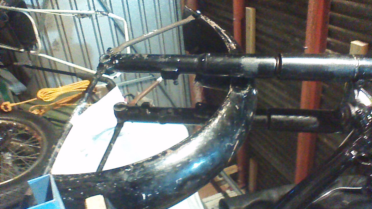

one last request do you have a picture of the fitting on the bottom of the front guard that holds the rear stay (stand).
Hi Kevin,
I missed this post last week,, can you attach a photo or 2 of the guard and fork legs as these changed over the years and they may have got mixed up.
