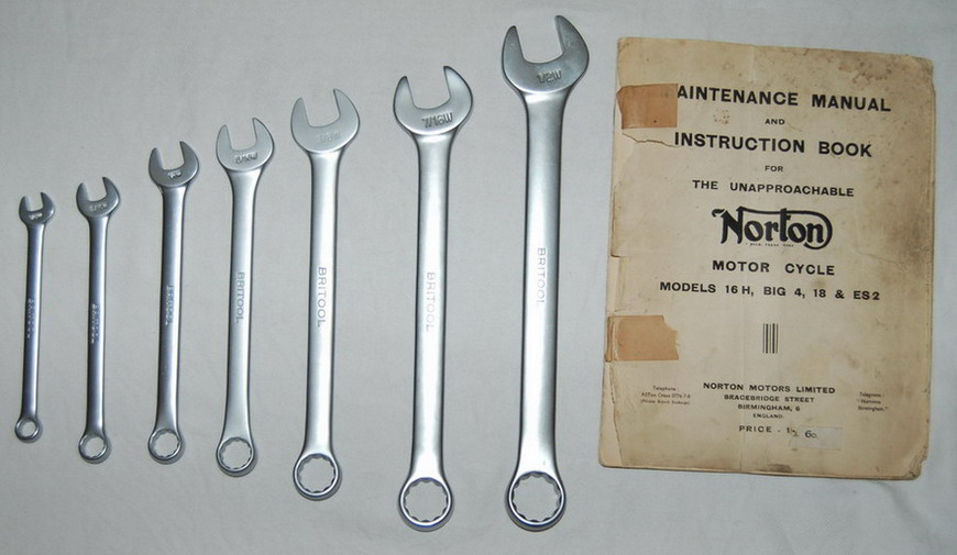

A selection of Whit/BSF spanners will be needed. Trying to work on bikes from this era with A/F or metric tools is bad practise as it always ends up damaging the hexagons of the nuts and bolts. Iâm attaching a photo of a nice set of (Britool) combination spanners to give you an idea of the most useful type to look out for.
Flat combination spanners are the type I choose. Although those in the picture were a birthday present from my children the other day, so they (the spanners) have not been christened yet.
