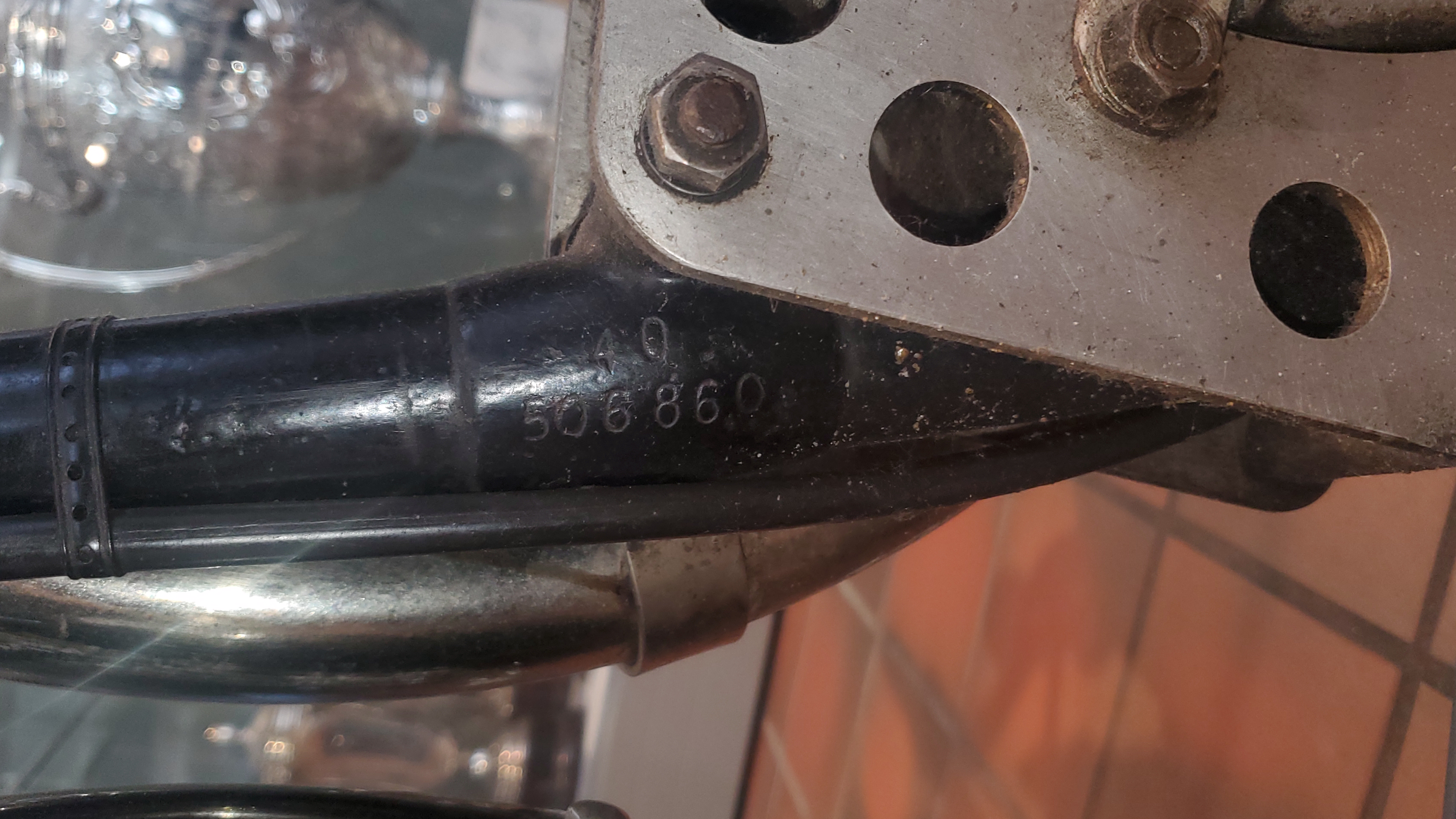

All the notes I've read tell us that the frame number is on left face of upper front downtube headstock lug.
Went to Brooklands today.  Denis Jenkinson's Model 40 (with later 500 engine) has its number on the upper front engine mounting lug, about a foot below the headstock.  And mine also has it on the engine lug.
Both are stamped in two rows.  Upper number is '40' or '30'.  Below that is the frame number.
The two models had slightly different frame sizes so it must have avoided mixups at the work to have model numbers.
Both are early 30's.
Something wrong there , the frame number has one digit too many , should be only 5 not 6.

Most 20s and 30s cradle frame OHC bikes I've seen have their frame numbers on the lower engine mount lug.
The 20s CS1s the 30s international models 30 and 40 etc.
Certainly most rigid frame models.
There are strange exceptions with the early 30s, ( 31 and 32), CS1 stamping on the more commonly recognised by us diamond frame owners, tank mounting lug.

Anyway. Stamping of an inter in the location you mention would be normal.
