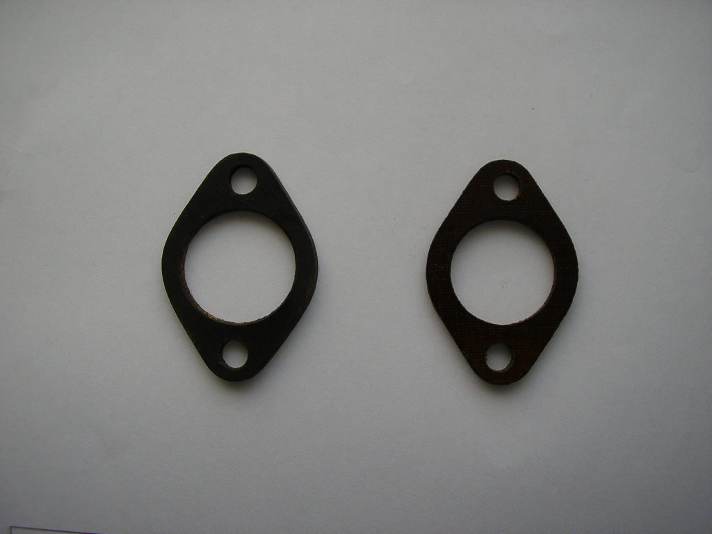

These maniflod insulating washers come is three versions. One version for the SS head where they are mounted horizontally and have mounting holes spaced 2" apart.
The pre-1959 heads (both 500cc & 600cc) used smaller vertically mounted washers with 1 1/2" apart vertical mounting studs. The later 1958 to 61 heads had 1 5/8" spaced vertical studs.
A 1960 engine should use the 1 5/8" versions which are part number 021572. The attachment shows the smaller 1 1/2" type.
Early engines need part number D12/984 which became T2241 and then 002241
