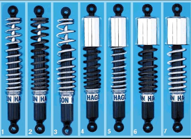

2) Yes it does seem odd that Hagons has been, and still sells ALL his shocks with the tight coils at the bottom....a possible write up mistake?
3) Any photos of Manx Nortons shows tight coils at the bottom.

NB Hagon shocks and many other suspensions use this set up method. Some years ago I emailed the new Norton company to tell them they had their rear springs upside down...and they have....Unfortunately in their arrogance never bothered to reply...Les
