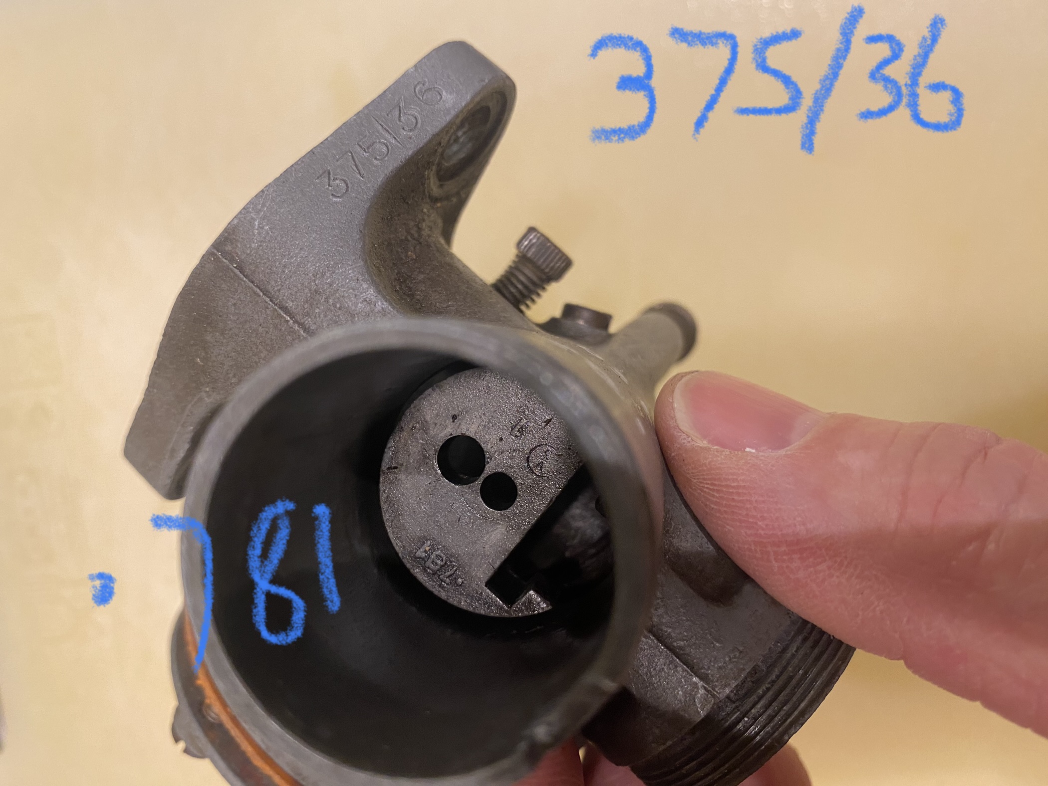

My carb (in the photo) has a main jet of .150 and needle jet of .105, it’s on a jubilee engine. Furthermore the carb is stamped 375/36. None of these numbers match any of the number combinations in the manual.  One more thing, the jet block has  .781 cast into it.
I have a second carb whose vital statistics are:
Main jet .140; needle jet .106; type no 375/47; jet block cast .875.
I think the bike was running on ethanol when it last ran- but I’m not 100% sure
I can buy new jets from various websites but I am perplexed over the size of my carb body. I know that 375 denotes the monoblc model, but what does the /36 and /47 refer to?
I haven’t mentioned an air lever because there is no air valve in the main slide (something I will need to buy).
Any help unpicking all this information would be appreciated. thanks again all. Mike
Hi Michael,
From the info I have the 375/36 was for a Norton 250cc 1958-63; Jubilee Twin De-Luxe; 25/32" bore, with 25 pilot jet, 3.5 cutaway, 130 main jet; 0.1065 needle jet and needle in the 3 position (from the top). Also 0.781" is 25/32", the bore size for the Jubilee. The standard Jubilee uses the 375/43, and the only difference, I believe, is the tickler type because of the panel work.
The 375/47 is for a Norton 350cc 1961-63; Navigator Twin De-Luxe; 7/8" bore.
Hope this helps,
Stan
Stan,
Thanks for your reply. Looks like I need to put in an order for the right sized jets. As it happens, I have both 250 and 350 engines so at least I now know which carb is which.
