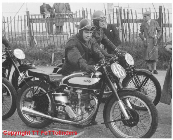

My own 48 350 Manx had painted crankcases and chromated, un-painted cambox. The attached photo is of the bike, lined up for TT practice, only 3 weeks old (and having already raced in the Leinster 200) so itâs doubtful that it would have been done by the owner â T L Irwin â in that time. (Note how much brighter the finish on the cases is compared to the gearbox). When Iâve finished restoring it will have painted crankcases which will no doubt raise a few eyebrows!
