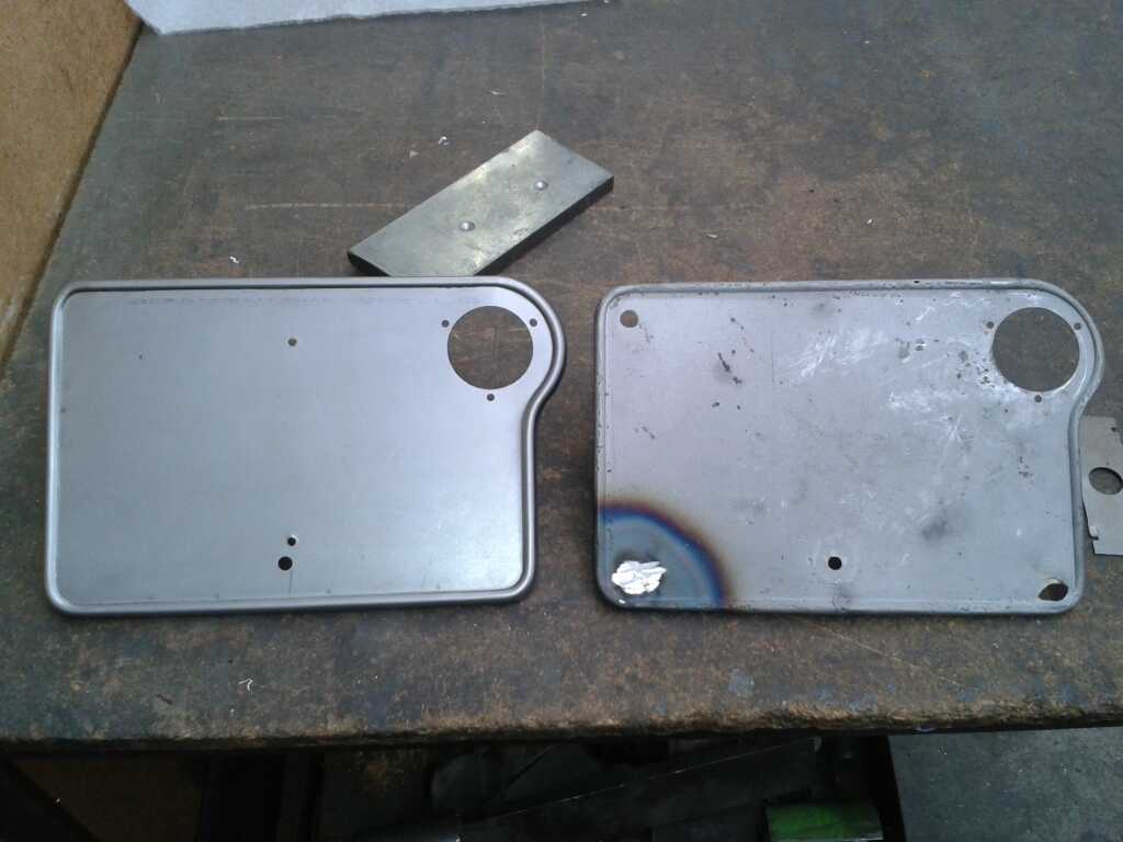

After a fruitless search for a new rear number plate for my 1945 norton wd16H
i ended up with the only option left make one
check the attachment for the first prototype press tool needs a few tweaks yet but very happy with the outcome.
hoping to make a small batch available for others that need very soon.
cheers

That's nice Duncan. Are you making the top bracket as a separate pressing and welding it ? I suspect that the original will always be a scarce part as rear number plates were only fitted up until about the end of 1941 and most sold-off post war would have been fitted with later plates on demob.
The requirement to fit a rear plate to a bike that didn't have one is always going to be a personal choice but I think that the 1938-on / MT110 rear light type such as you're making is the most attractive period option.
hi richard
it is one complete piece with the two brackets that bolt onto the mudguard all part of one sheet, also two of the holes in the one in the picture won't be there that was just on the test piece for alignment purposes.
i am really happy with it as it looks right and not too perfect if you get my meaning. i am not 100% sure on the legal issue about having to run the number plate on the road but to comply with all the speed camera's ect i suspect we all should have one. i know i would certainly not like to run any bike without a rear light.

i think your idea is on the money regarding the cut out, it would indeed allow the plate to be fitted to a full ribbed mudguard as well as the smooth types so a one fits all type thing, i had never even considered that.
i do notice in the pictures the rear carrier racks have an extra brace going to the rear of the mudguard at a 45 degree angle i just have the straight ones on mine, are the extra braces because of thepossibilityof a pillion seat?
i was not surprised they changed the design from one mounting tab to two though, can't imagine them lasting very long at all heh. i could redesign the tab so it butted up closer to the mudguard but to add the slightly raised flange would mean another tool making and i think some buckling andstretching of the top mount as it stands now it is just the two tabs bent on their own easily with a round bar tool. i think i will leave the design as it is for now as it serves the purpose and still looks great in my opinion.
it takes over 10 tons pressure to get the definition on the pressed outer part on the plate. have sold two plates now which should be with the buyers early next week so await feedback on fit on other bikes. if they are happy with them i will press the 5 more blanks i have as soon as possible. after this i will need to buy more material and get more blanks punched.

Duncan, if you do make some more then I think that it may be a good idea to make the cutout optional as it's not something that I can identify to date in period photos.
