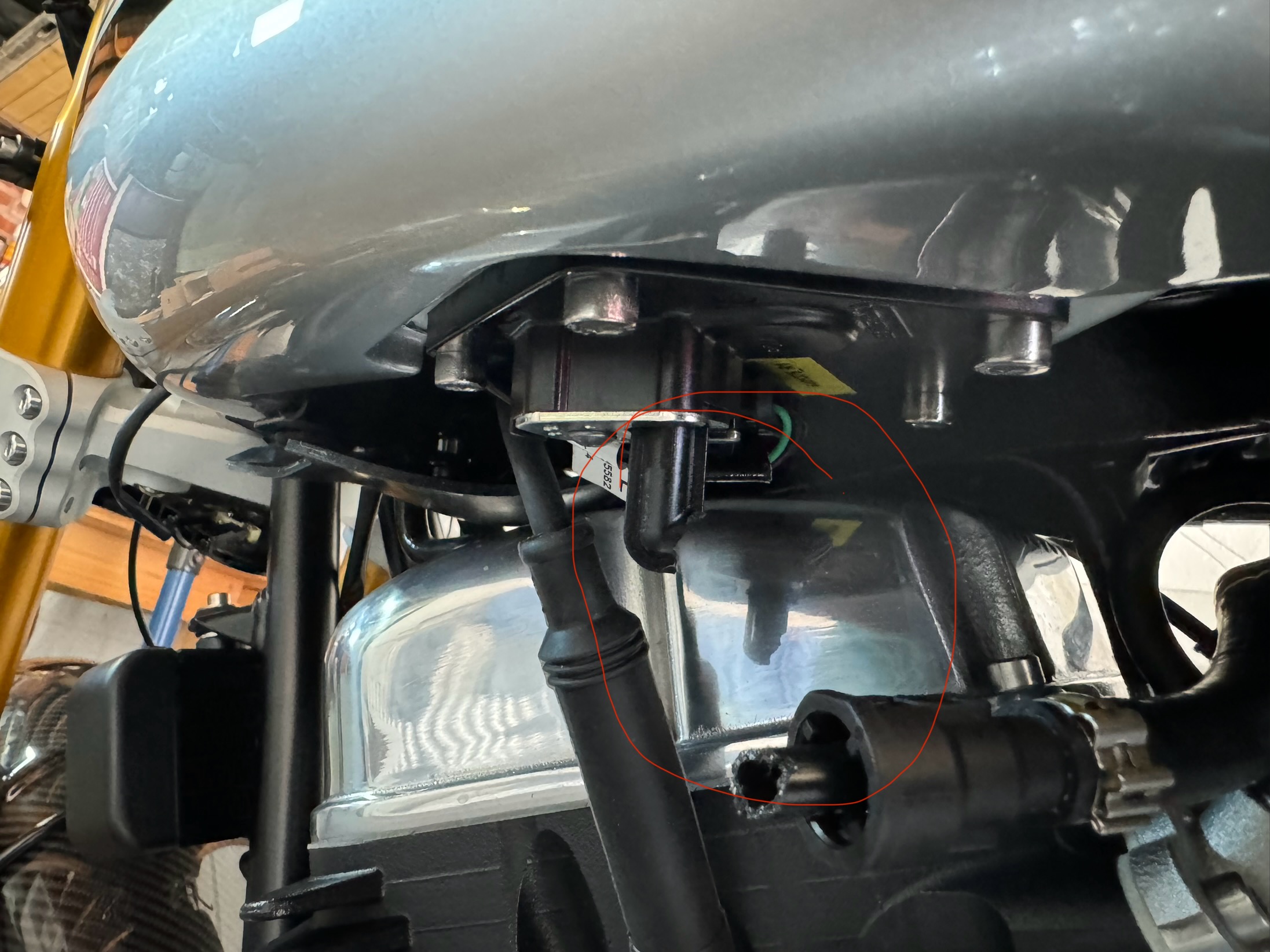

Several problems came to light on the first day. Whilst separating the fuel pipe from the tank the spigot snapped off (for those that don't know what the spigot is, its the name for the pipe from the fuel pump to the hose. Not a problem i thought, these things happen. I called Norton who advised that the replacement part was £1000!
That's because they wouldn't supply just the spigot but instead had to supply a whole pump pump to obtain a easily removable spigot. The after sales manager was absolutely useless and quite frankly couldn't care less. In the event i contacted Stuart Bodicote who was most helpful. He said bring the tank to me and ill fit you a new spigot, a 2 minute job £15.
It turned out the design had changed and the previous generation spigot didn't fit, He said leave it with me Ill find you a replacement. Within 20 minutes he had found me a replacement part in aluminium from China. The quality of the original spigot wasn't only plastic, but an extremely brittle plastic which is prone to snapping.

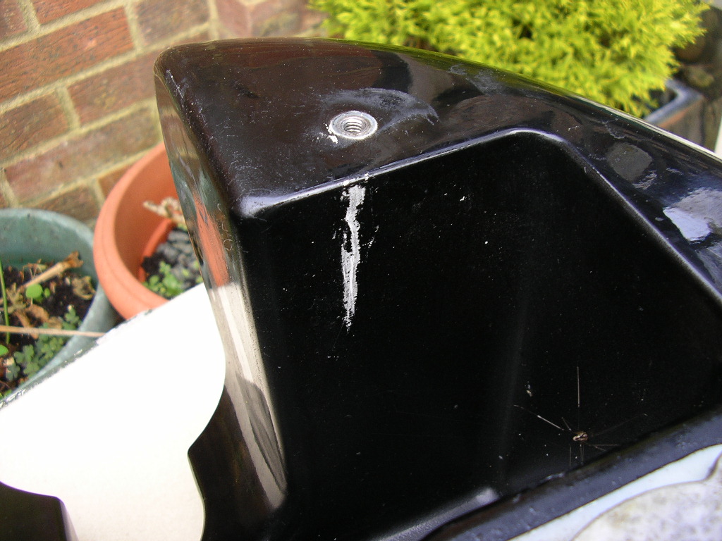

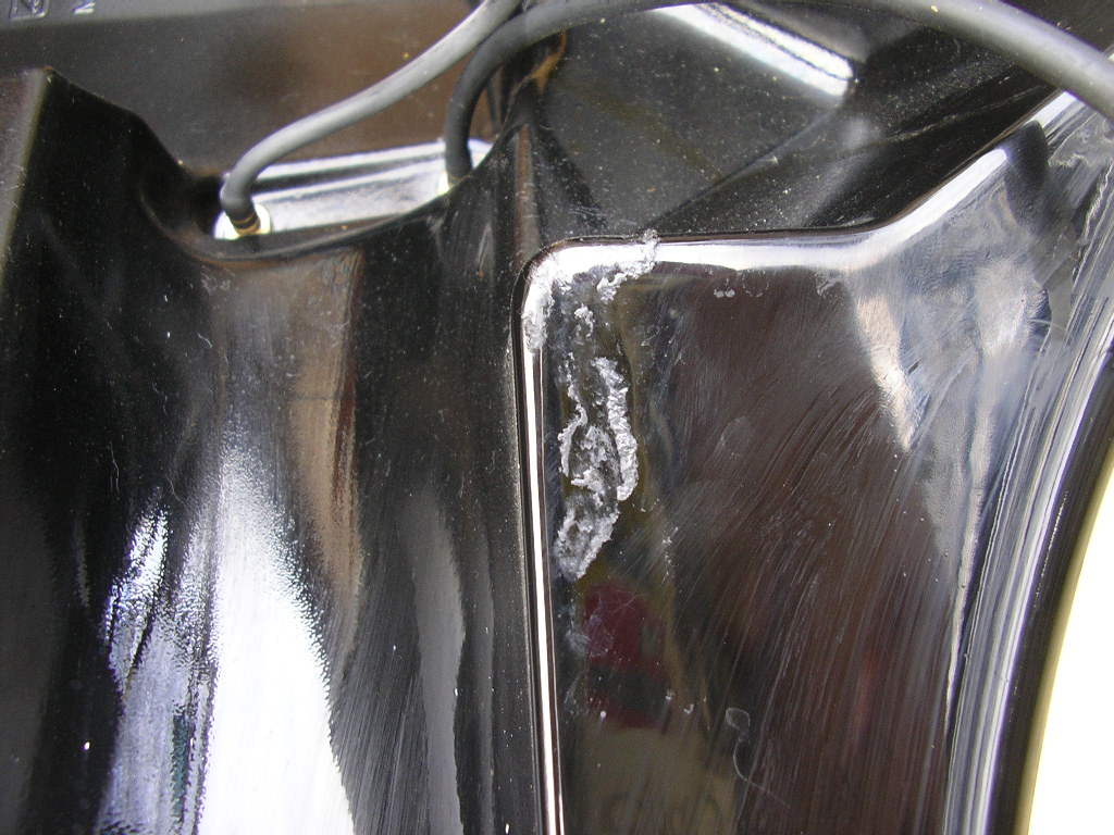

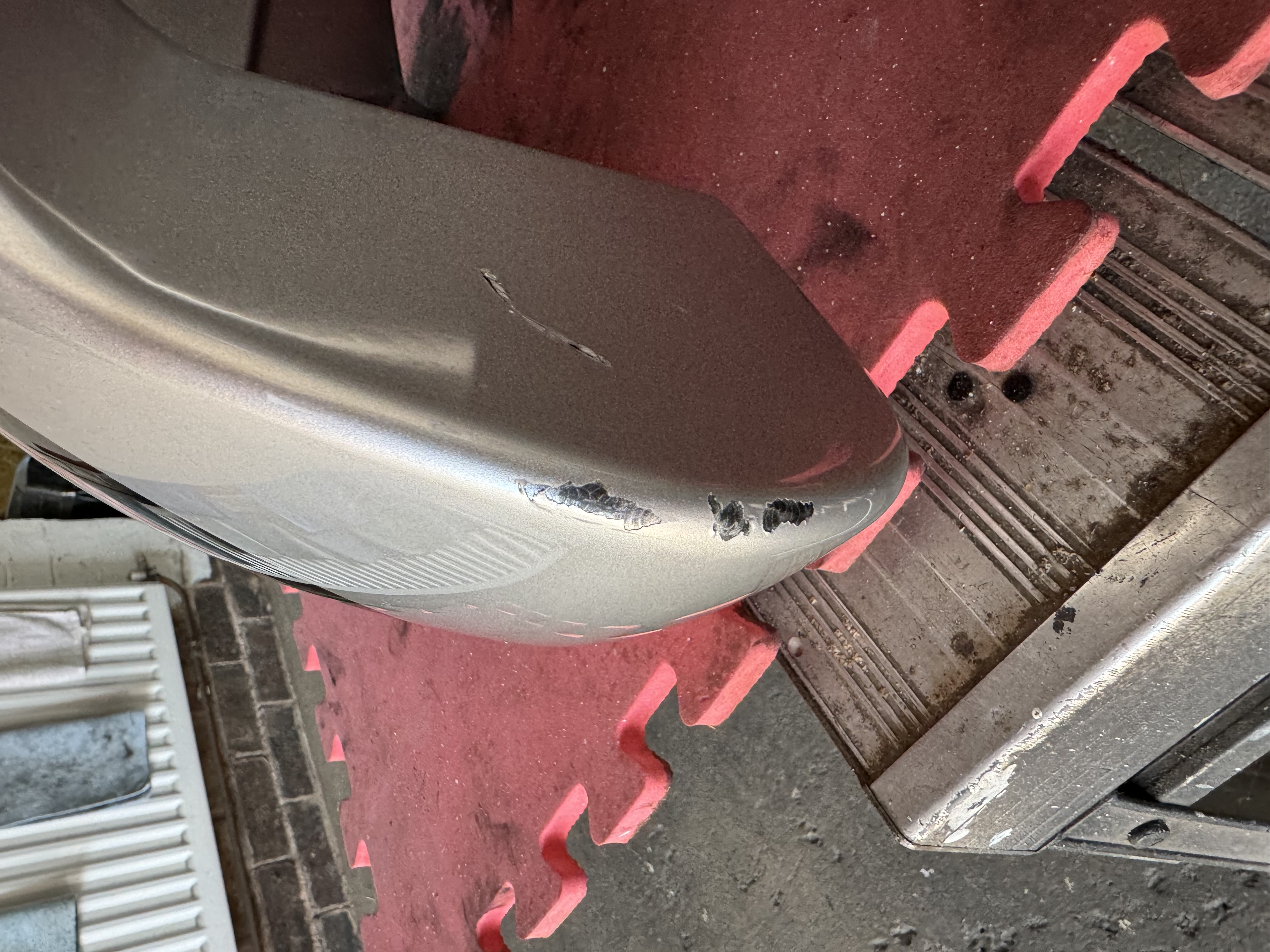

On removal of the tank with 2 people to make sure no damage was done i found the paint work had been severely damaged on fitting, the damage which only revealed itself once the tank was removed, again i spoke with the aftersales manager who told me it was my fault for not checking the inside edge of the tank on delivery and as before he couldn't care less.
Therefore my advise to anyone taking delivery of a SP is the tank should be removed on delivery so a thorough inspection can take place

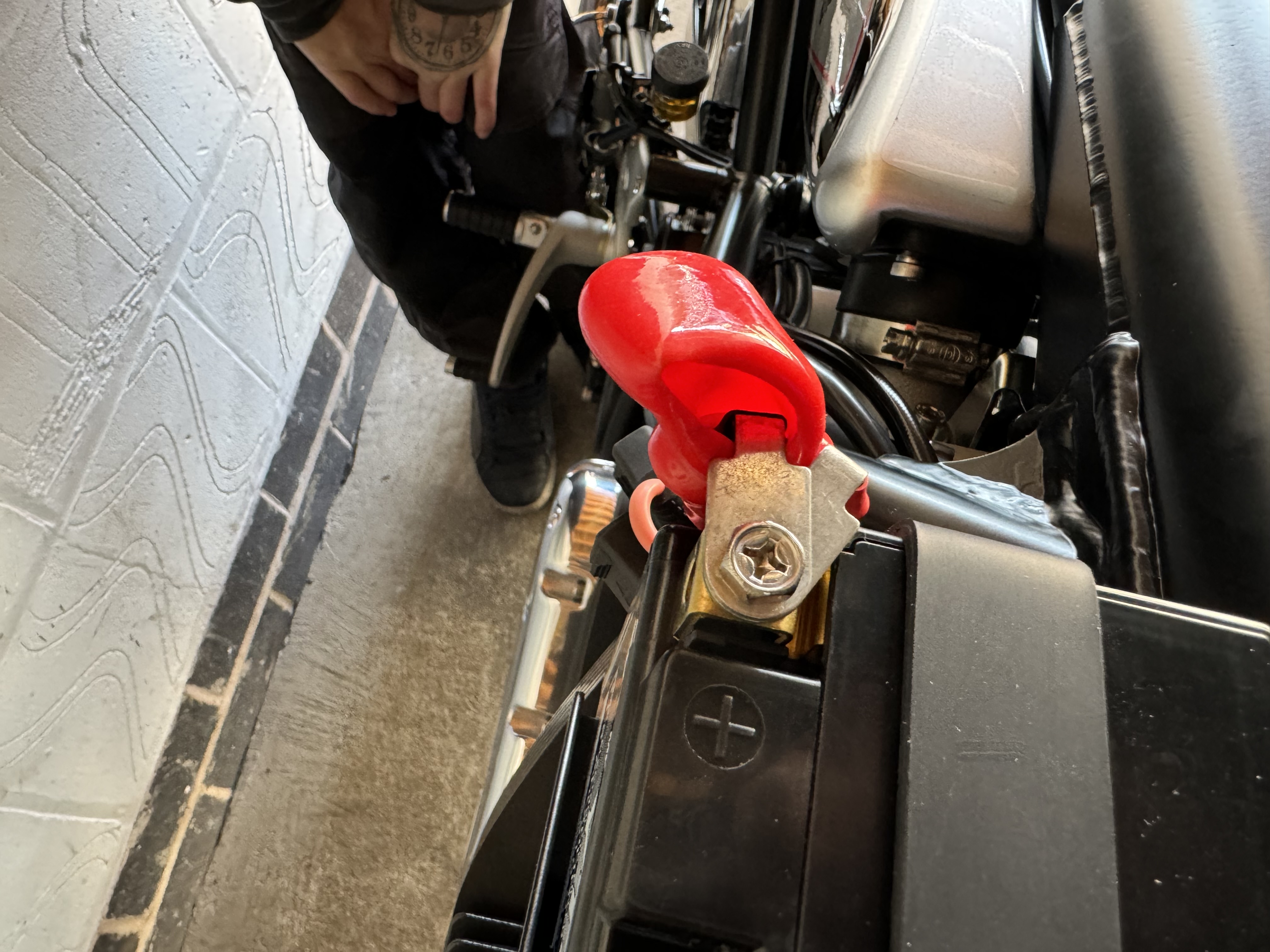

The red plastic positive terminal cover hadn't been fitted correctly and was sticking up rather than covering the terminal as it should, to be effective.

Tank damage

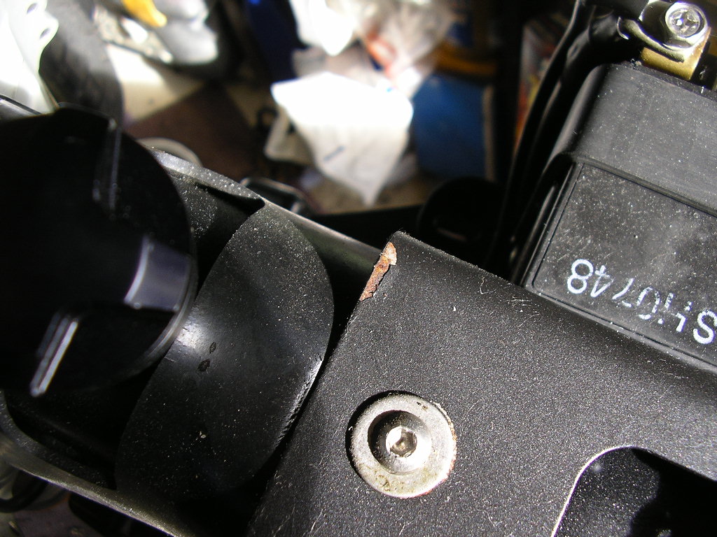

I had to remove the petrol tank, on my 961, just weeks after the first major service.

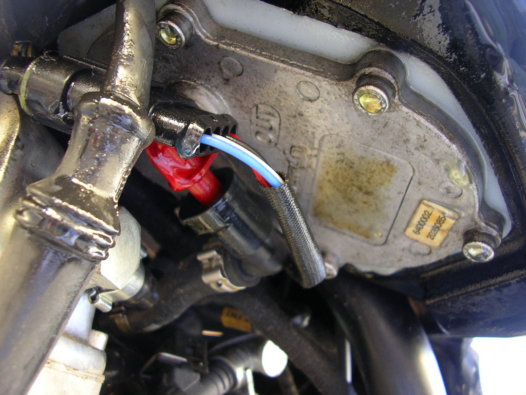

The petrol pump seal had failed and flooded the battery box area. The advice from the servicing agent was to remove the tank in order to disconnect the battery.
I was instructed to drain the fuel tank and then remove it. This entailed removing the seat, two tank bolts and a rear strap bolt. Followed by parting a fuel connector, two breather pipes and an electrical junction. The fuel connector only disconnected after its plastic clip was squeezed in a particular direction.
The tank finally came off but only after the clip broke.
With the tank clear of the frame, patches of rust were visible plus damage to the tank.
In the photograph below the red chunk is the fuel pipe connector and the shiny look neat fuel.

With respect to the fuel connectors, this was a common problem on early 2000s Triumph triples. I replaced the plastic connectors on my 2004 Tiger 955i with metal ones from here: https://www.omega.co.uk/pptst/FTLC.html but shouldn't be necessary on a new bike.

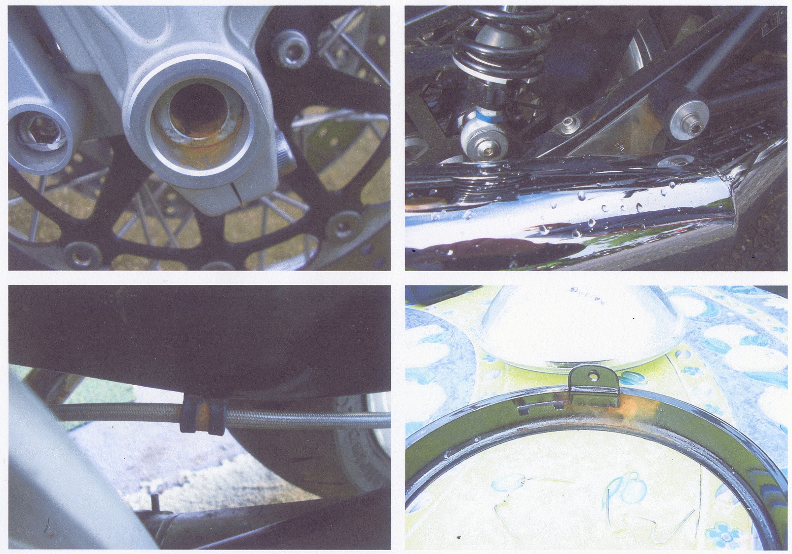

OK most of the corrosion was on minor parts but the front spindle was a huge worry. I asked the serving agent to replace it under warranty and was refused on the grounds that these parts were massively over-engineered. The rear spindle was far worse and the internal section blocked with flakes of rusting metal.

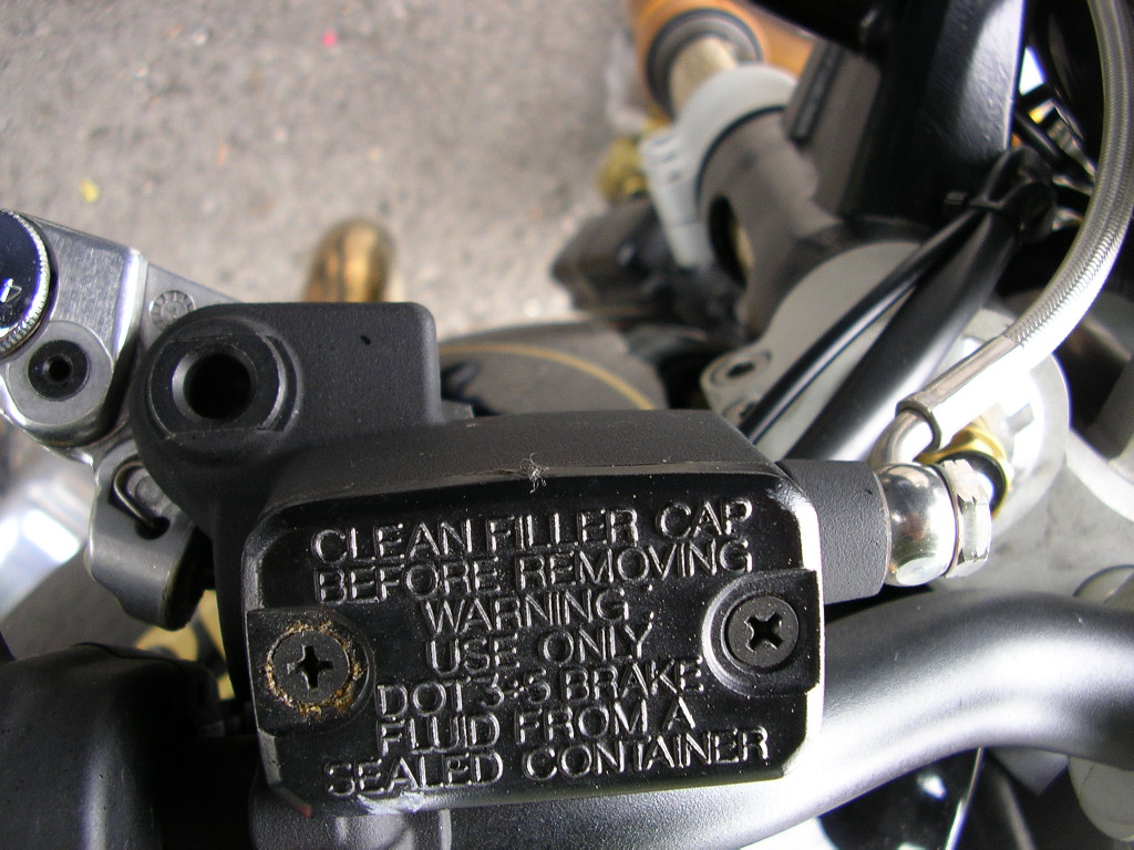

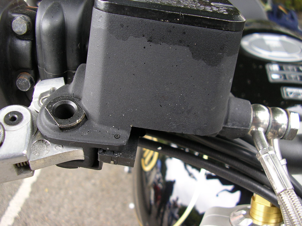

I took my 4 month old 961 to a local motorcycle servicing agent for a check over. The examination revealed three serious faults which would have led to an MoT failure. A leaking brake fluid reservoir, an excessively loose brake pedal and the wheel spindles corrosion.

I have taken my tank off my 961 a few times but for the life of me I cannot get my head around your picture of the tank, maybe because of the angle. How about taking another one from a different position please.
