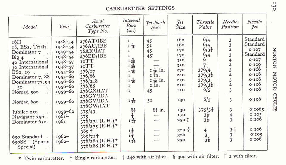

It's a 1 5/32 and the number on the flange is 389/228 with indicates that it came from a BSA A65 Lighting or Hornet which is why it was fitted with 270 main jet (standard for the BSA).
99 Maybe not so Blue!
Thanks Terry, for the money I would change back to a brand new 376 carb, and try that for a comparison, for £200 it could be a good fix and maybe the blues will go away!
The aperture/choke size is 1 1/8 th I think on the 389 rather than 1 1/16 th on the 376.
Best of luck!
See table attached
