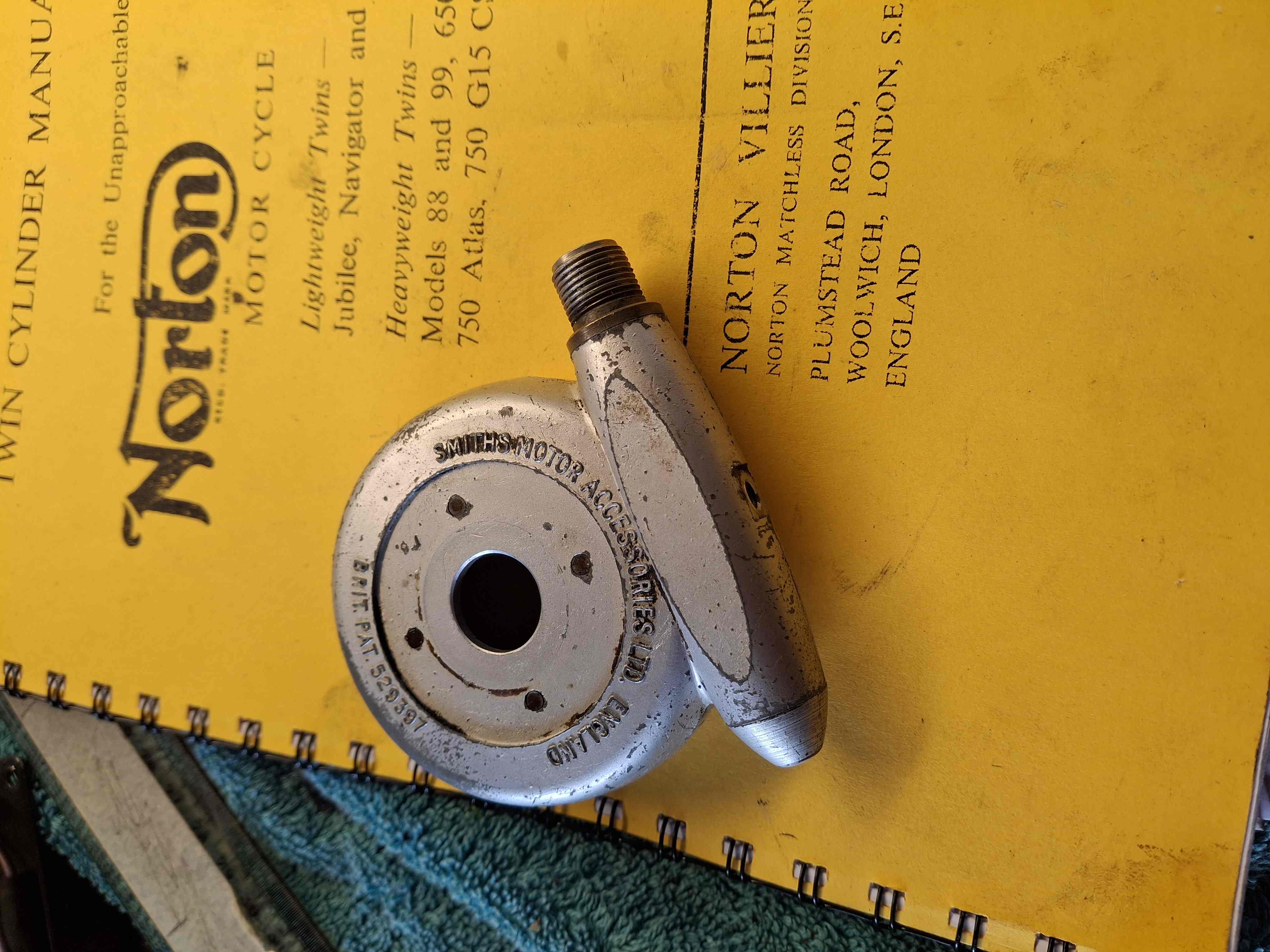

Grease or oil for the speedo drive?
Two pumps of grease through…

I have the screw. I removed it for cleaning.

Two pumps of grease through the grease nipple on the bottom of the drive. Every 5000 miles.
Only...... the grease nipple is missing on your drive.
