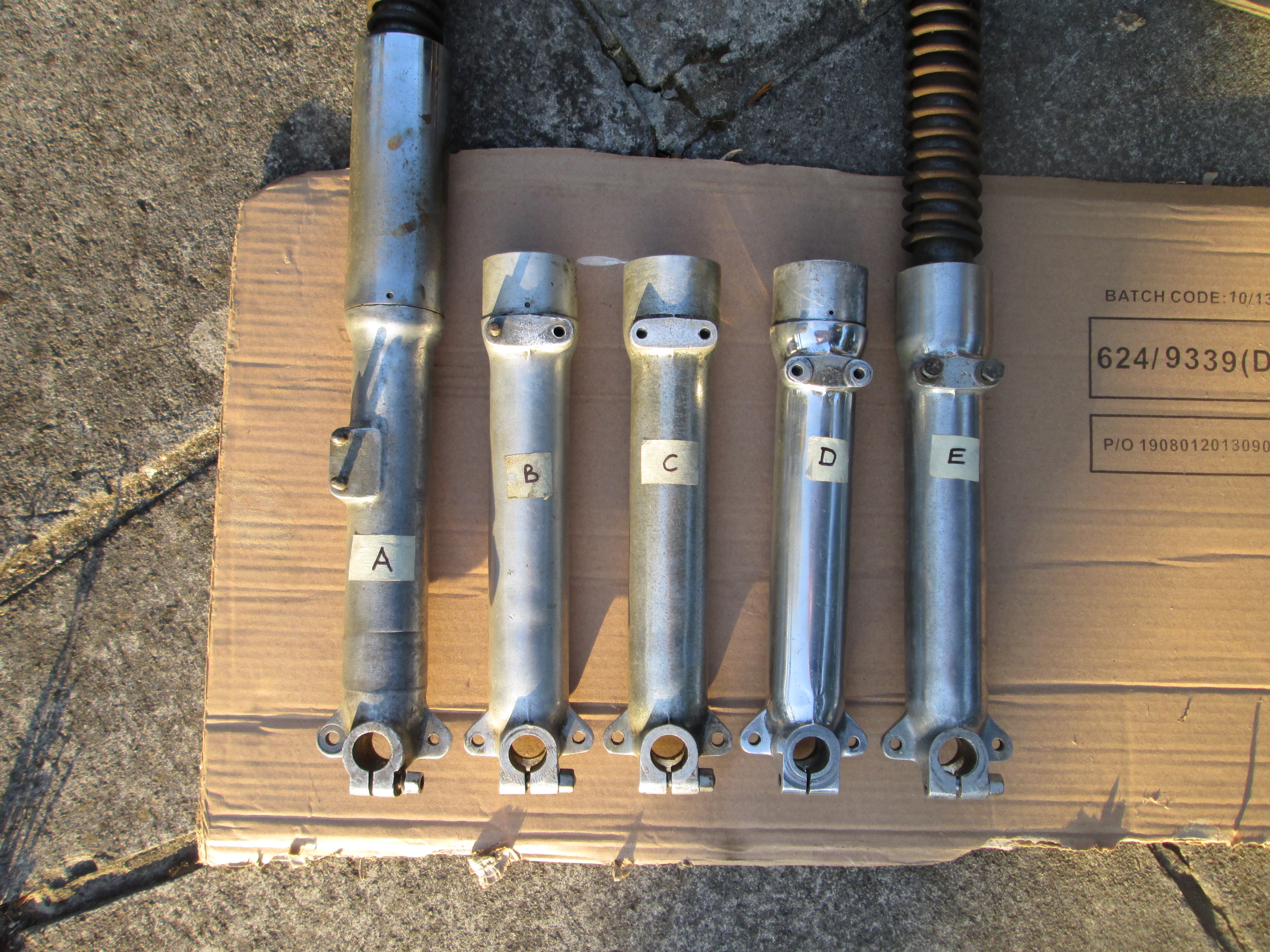

In the photo "A", "B" and "D" are long Roadholder legs and have the top machined for the lower fork shroud to fit onto and fixed in place with two small screws.  You can also see there are different positions for the mudguard fixing bracket.
"E" may be misleading as it seems to have an external spring place, I cannot remember why this there as I took the photo a couple of years ago.

But I’d suggest you post a picture here so we can confirm exactly what you have!

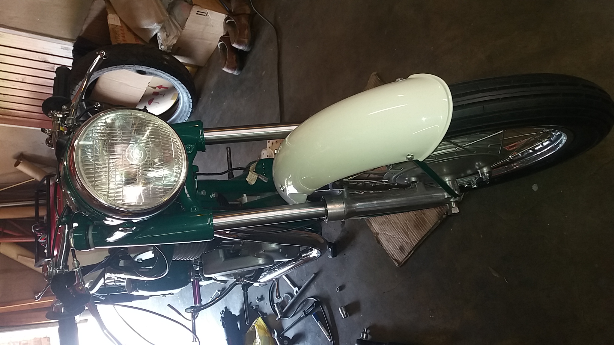

Attached photo shows the bike up on its stand, it can be seen that the stanchions are too long.
Maybe I will just add pads under the stand - the simplest solution!

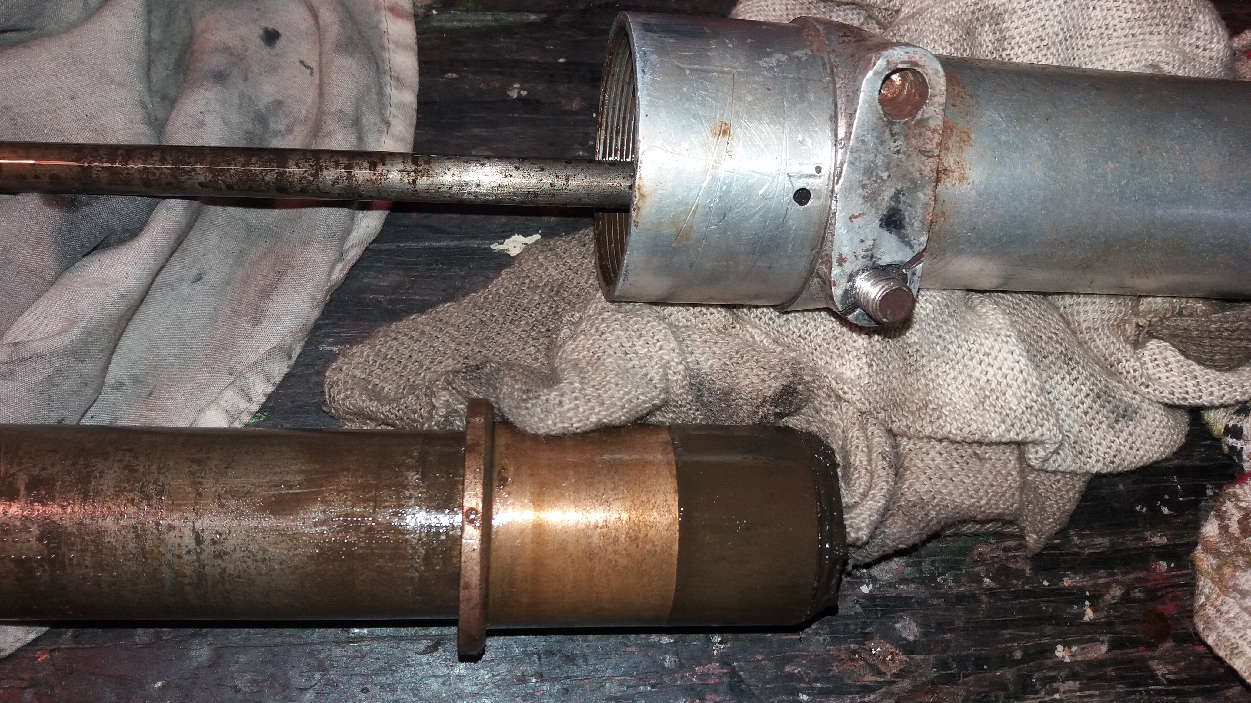

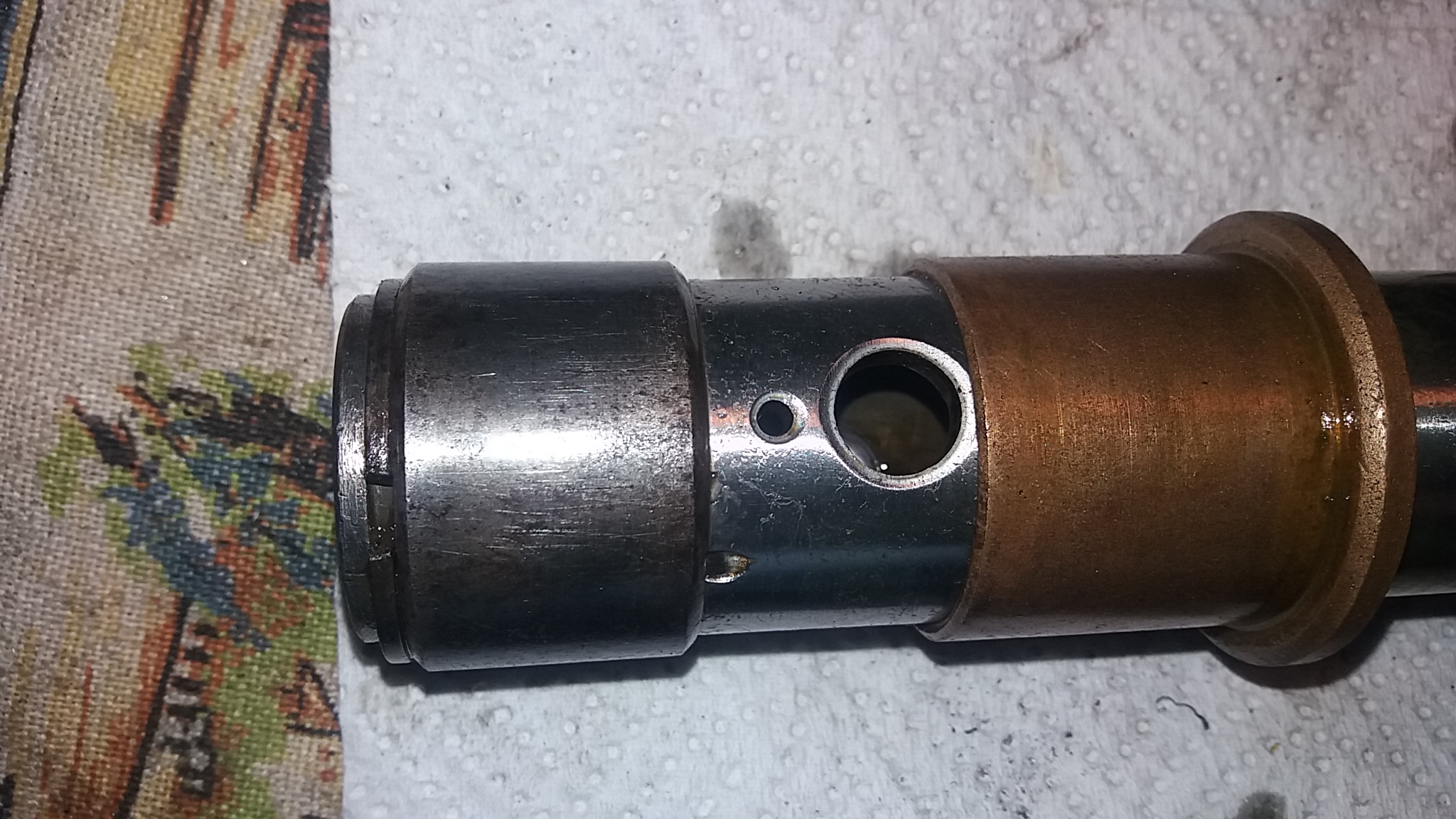

I replaced top hat bush, oil seals, and both damper tubes (someone had cleverly (!) welded two halves together to make one!). I did not replace the rods, nor springs as despite being filthy, they seemed in usable condition.
I have read the discussion about the position of the holes in the damper tube and fitted replacement tubes which had holes in the taper, not below it.

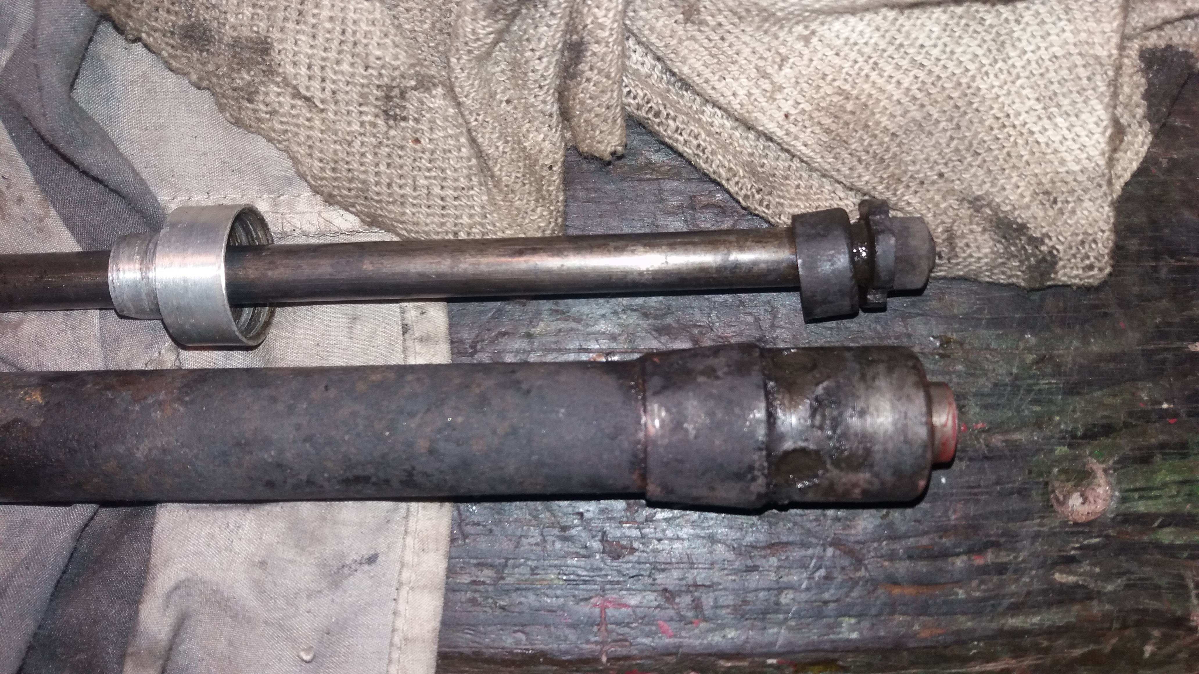

The attached photos show the condition of the internals - lovely aren't they?  It had been standing (or lying) since 1978 under an outdoor cover.
It isn't my main objective to get it back to original spec. If the forks work ok I'll leave them at this stage, maybe correct them later. I have to do something though to ensure it stands properly.

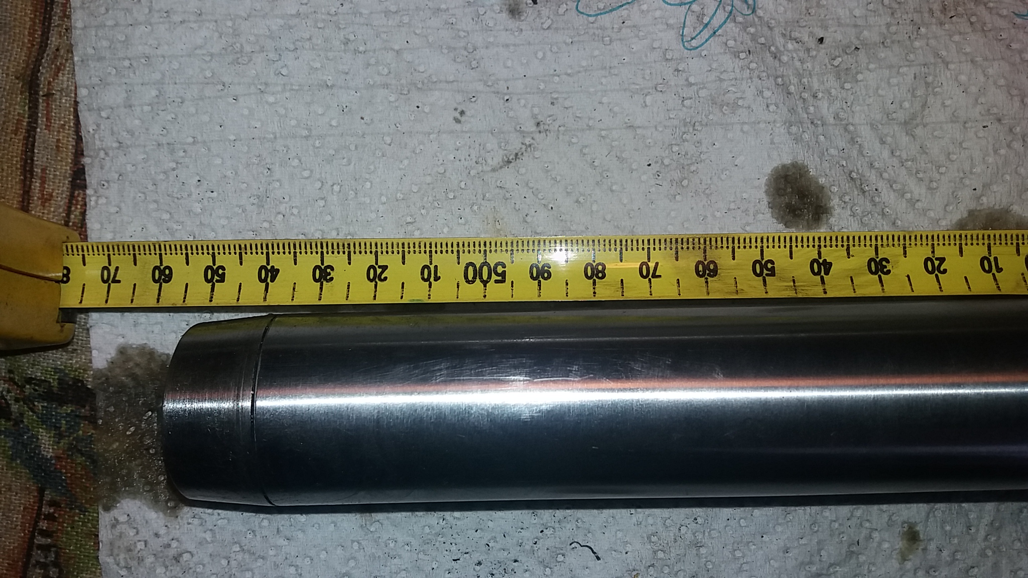

I stripped the fork this morning and measured:
 - overall free length of the spring 473 mm
 - stanchion protrudes from locking screw ring at full extension 463 mm
 - overall stanchion length 553 mm - see photos.
I like the idea of shortening the stanchion by ... mm, but will I need to shorten the spring?
I think so or else I will never get it back together.
But how to get a flat top to the cut spring?
Richard

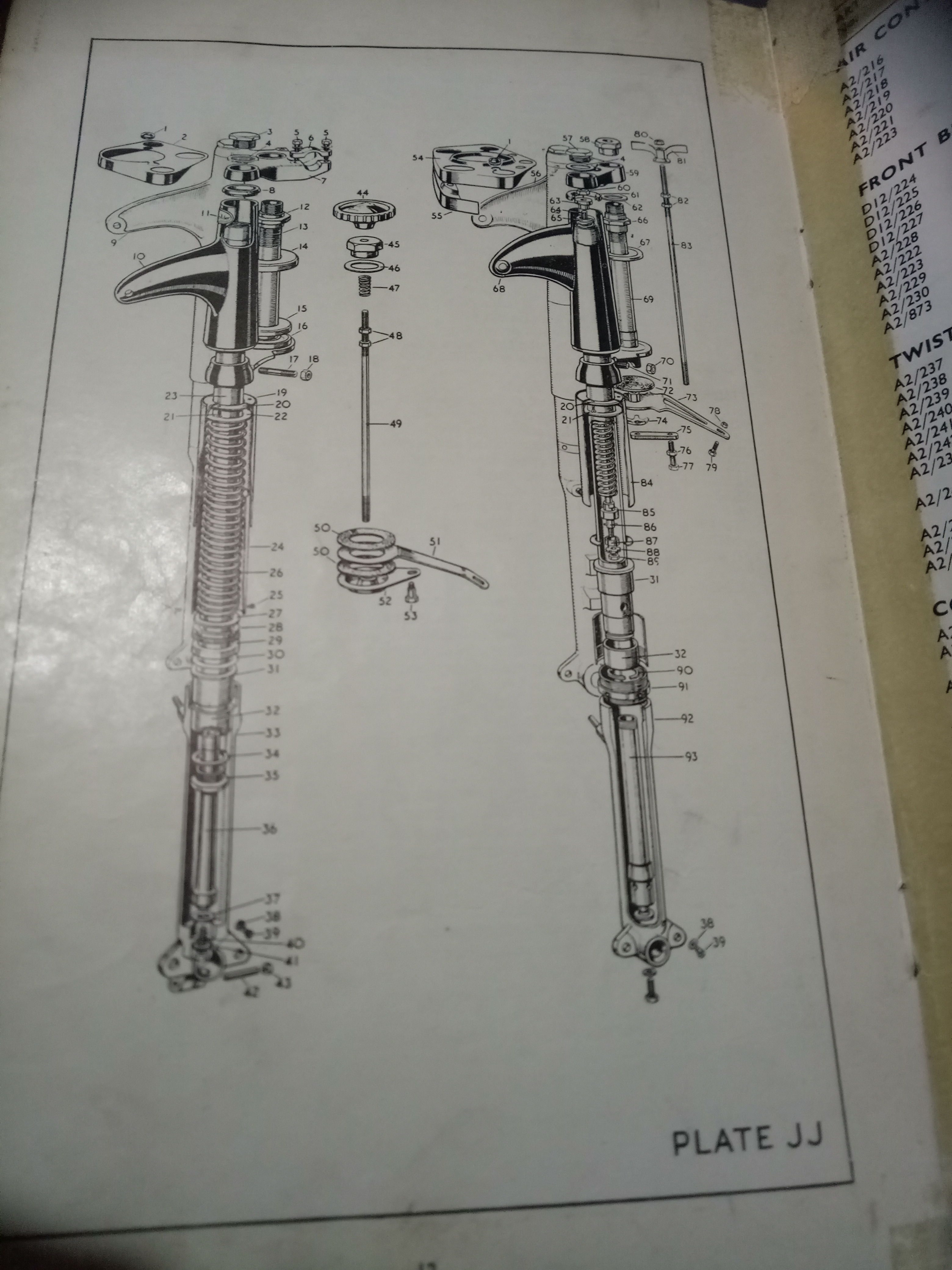

PreCommando short Roadholder staunchions are 21.8" long and long Roadholder stanchions are 23.3"  long.  Note Commando stanchions  are longer at 23.2" but look similar to the short Roadholders.
Spring lengths are 11.8" for Long Roadholders,  18.7" for short Roadholders and 18.7" also for Commandos.
Hopefully the photo from the 1956 parts book showing exploded diagrams of long and short Roadholders has attached to the message

The dimensions you have quoted are exactly what I measured so my stanchions are obviously  correct for the short Roadholders.

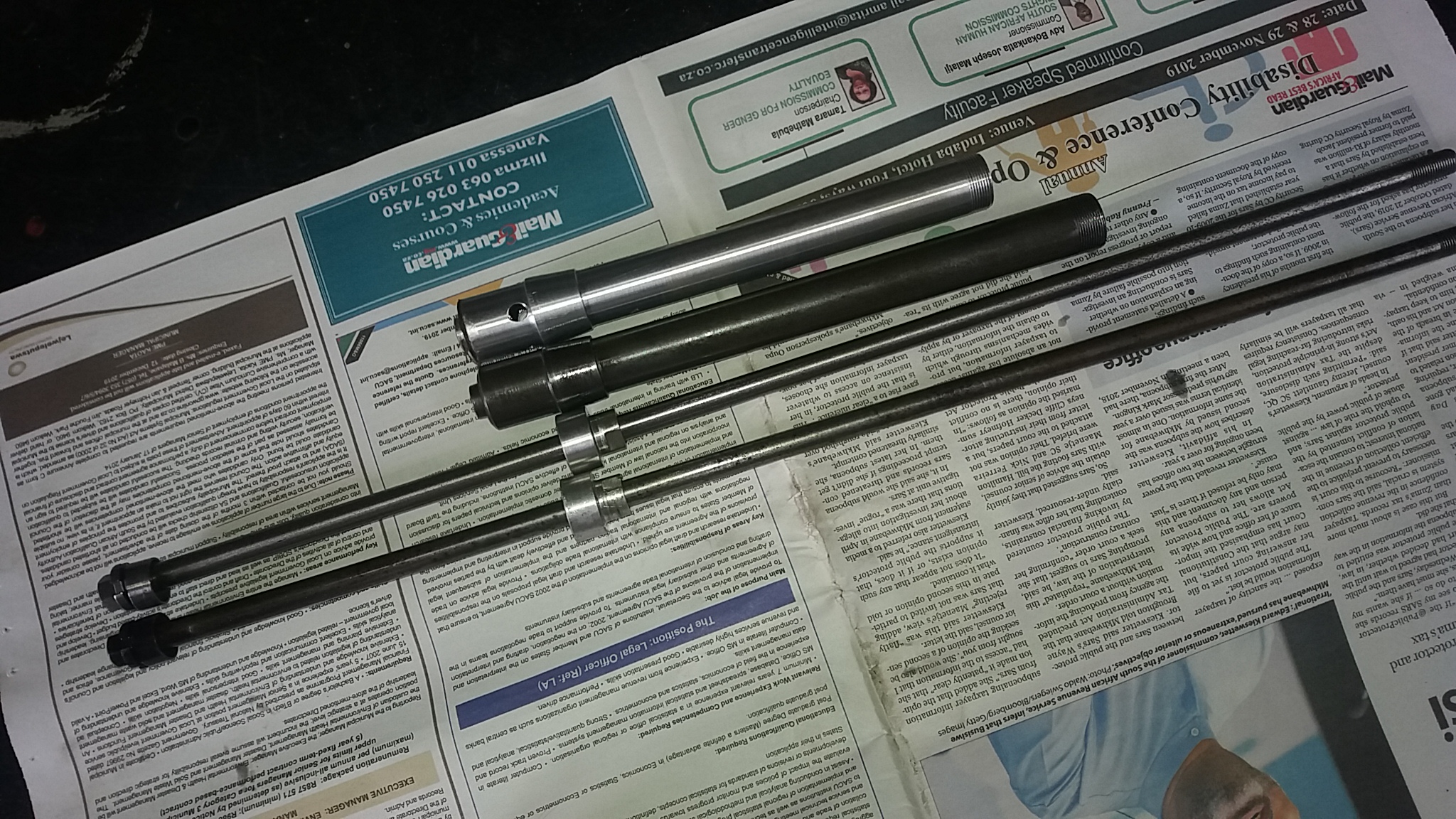

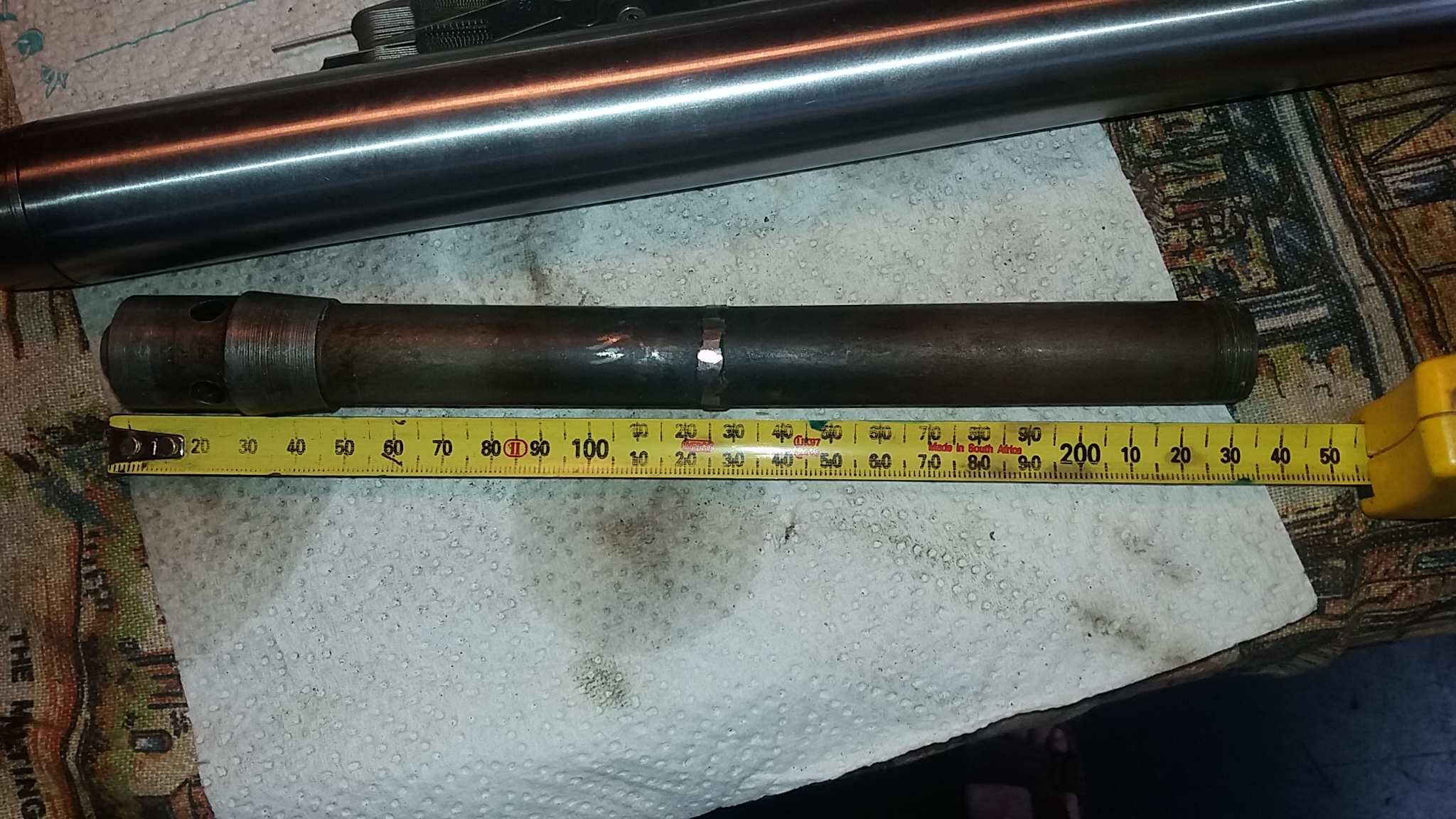

Well there is your problem!  ..... you have commando damper tubes,  they are longer than the short roader ones. Commando dampers are 232mm and short roadholders are 194mm. That accounts for the 40mm extra length.
https://www.rgmnorton.co.uk/buy/alloy-fork-damper-body-with-improved-damping-standard-commando-1_2282.htm
https://www.rgmnorton.co.uk/buy/alloy-fork-damper-body-cap-with-bolts-improved-damping-short-r-holder_2281.htm
The rod should be 503mm long
https://www.rgmnorton.co.uk/buy/steel-fork-damper-rod-26tpi-featherbed_4015.htm
According to RGM the rod and springs were the same length in the commando and short roadholder forks, the main difference being the length of the damper tube.
So with a couple of new damper tubes you’ll be sitting pretty on your stand .... hopefully anyway!
Dan
Ps why is there a weld mark around your damper tube?

Thank you finding that Dan, yes you are correct, the ES2 damper tube is 230 mm long, my Dommie is 194mm.  All other dimensions are identical, the rod length, the spring length, even the sliders which I thought were different (but aren't, the locating surfaces inside are positioned exactly the same). See photo below, the shiny items are the Dominator.
So, reading the discussion between you and Howard above (where I am thinking that a damper tube extending further up into the slider will allow the slider to travel further down until the rod stops it), I will fit the ES2 damper tube to the Dommie and see if the wheel sits 36 mm lower.
If this works, I think the easiest course will be simply to cut 36 mm off the damper tube and put a 28 tpi thread on it.
I'll keep you informed - but not tomorrow unfortunately, some other things are calling.

The problem of my ES2 forks being 35mm longer than my Dominator has been cleared up - finally.
The ES2 had been fitted with Commando damper tubes. Assembling it this morning with tubes from the Dominator, (all other components the original ES2 items). gives me a fork length fully extended of 710 mm. Exactly what it should be.
I will get the Commando tubes cut short (to 194 from 230 mm) and threaded to take the end cap.
