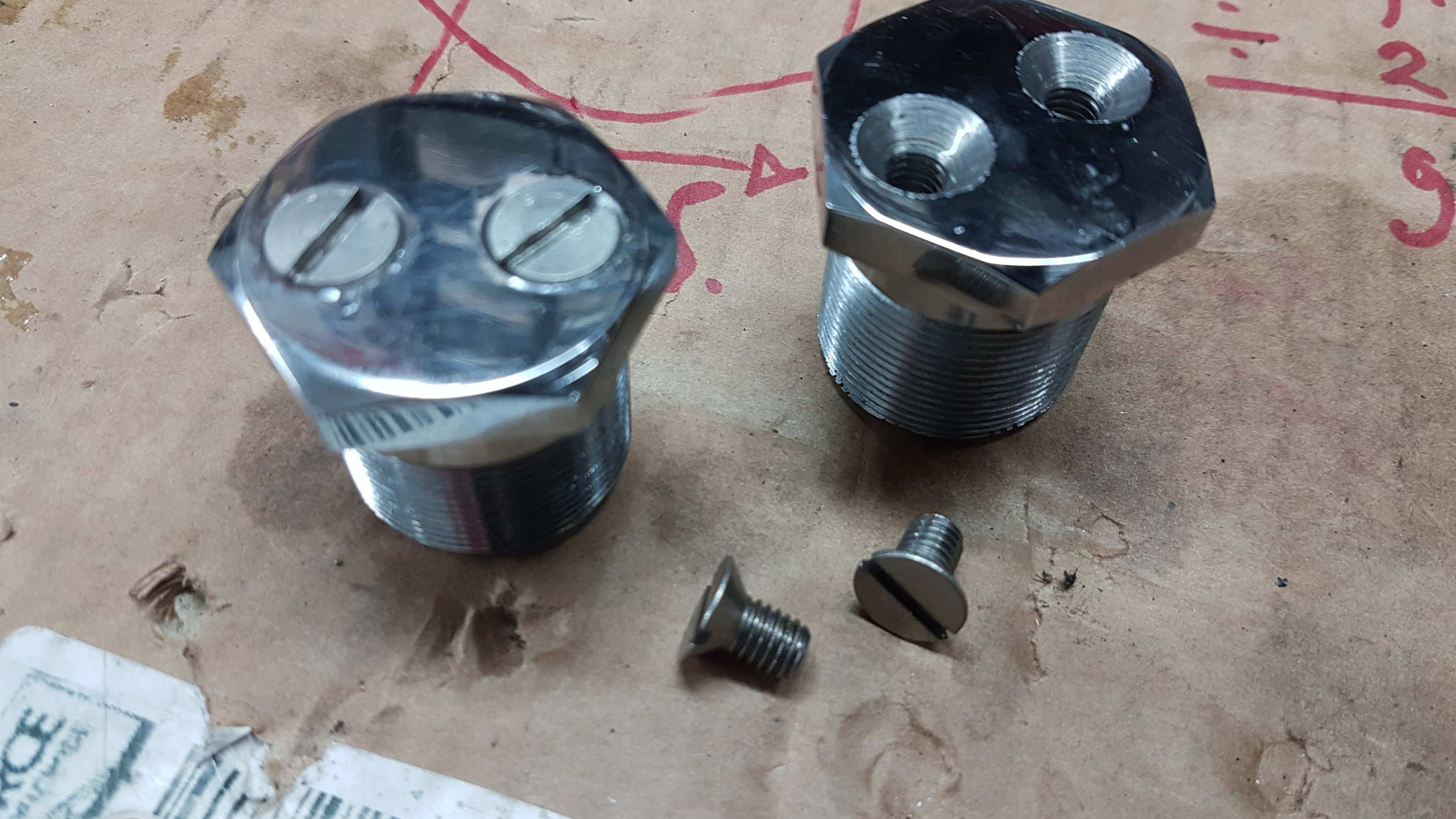

I've just modified a pair of spare top nuts to help aid fork oil replacment - drill and tap two holes in each at 6mm (sorry !) with countersunk tops and then add stainless screws to fit.
Once the old oil is drained and bottom screws replaced - with the top nut 6mm screws removed, use one to pour in the oil using a small funnel and tube and the other to allow the air to escape.
I've not actually put them on the bike and tried them, as I only completed the work the other day, but the theory is sound.

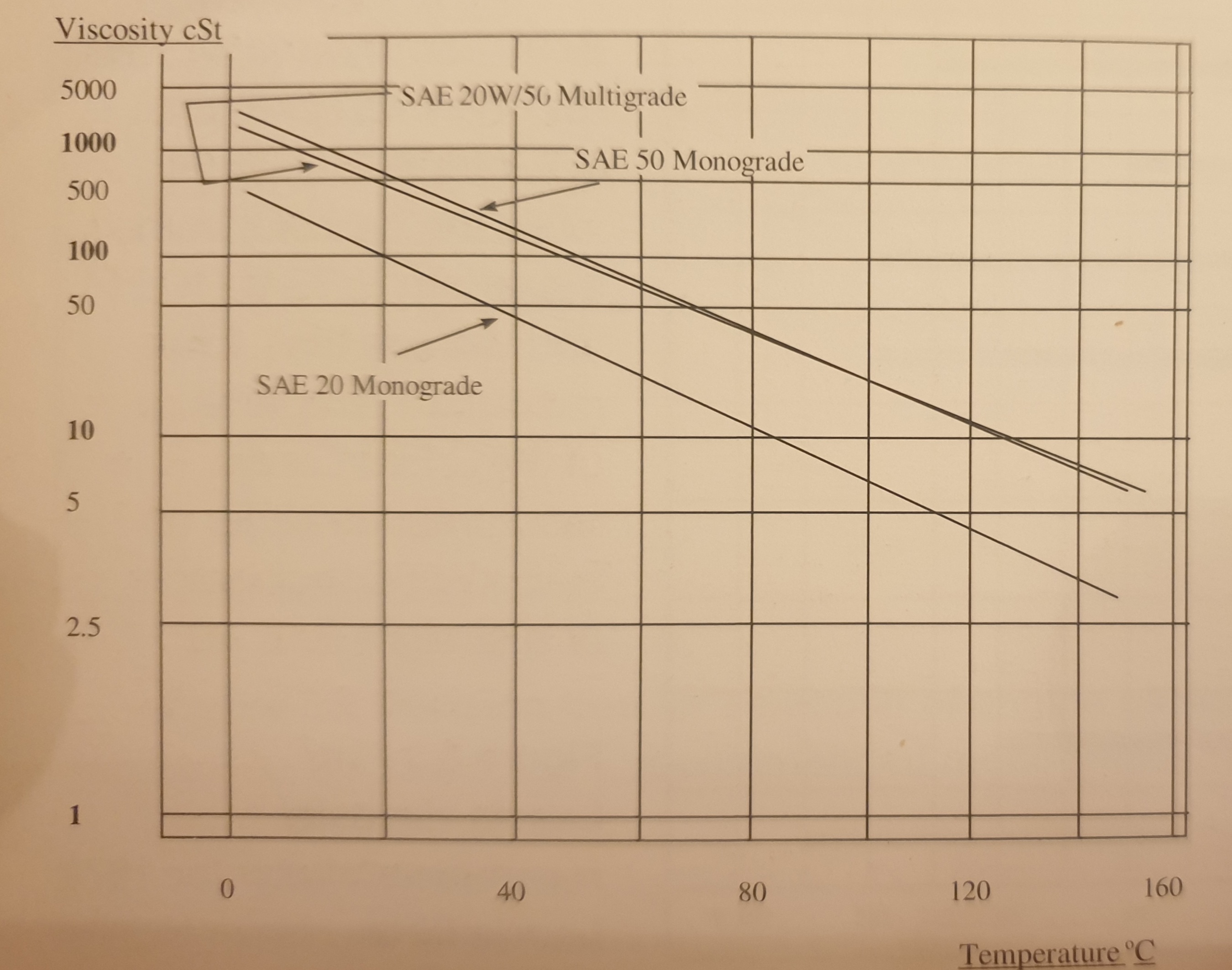

Take care before choosing multi grade oil. SAE 20 matches the viscosity of 20W-50 at minus 20°C. By the time you reach plus 20°C, a 20W-50 is far closer to SAE 40 than to SAE20.
But as others have said, products sold as "fork oil" don't necessarily have numbers with the same meaning. Allegedly.
From what you say David , it…
From what you say David , it seems that 20/50 is not really suitable for a primary case as its likely to be more 50 than 20 once warmed up. Back to ATF I think. Works in forks too.
I found this. Make of it…
I found this. Make of it what you wish! If the lines for 20 and 50 are correct then the 20-50 line on here doesn't meet 20 grade at -20 degrees as far as I can see.
