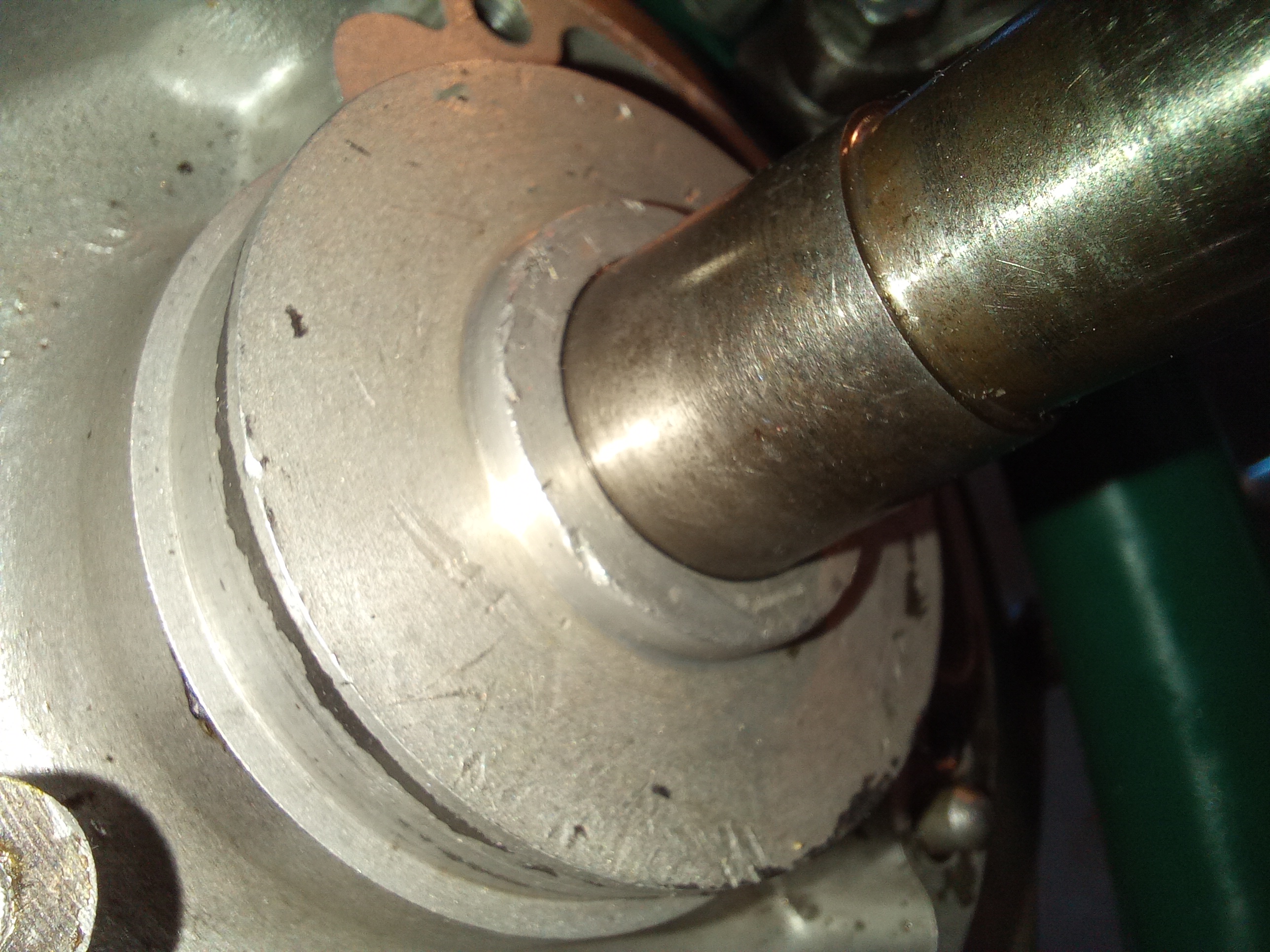

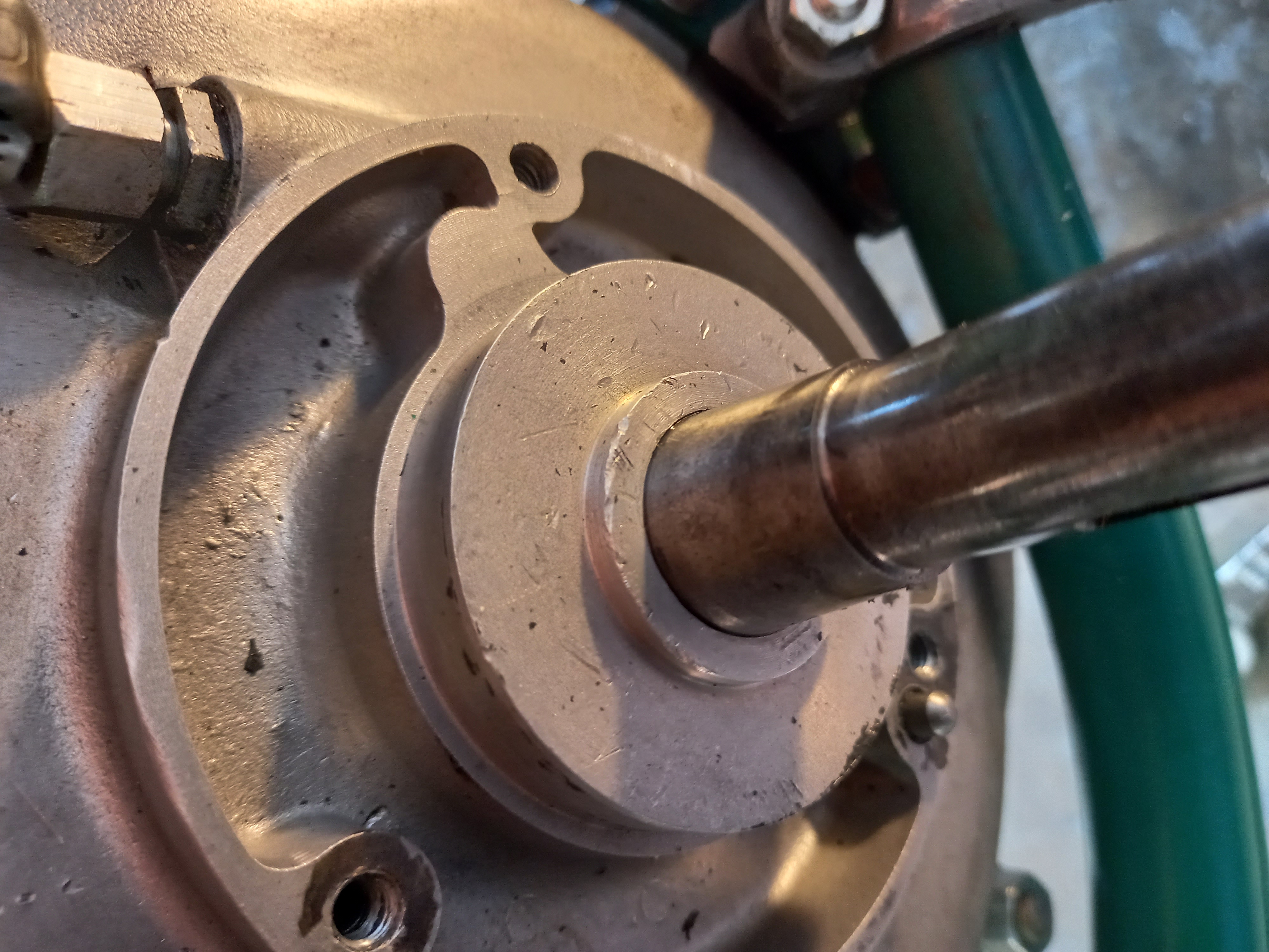

Not on my 1961 ES2. See attached photos.
The seal is fitted in a recess from inside the engine.
Or am I missing something?
The threaded screw hole at 3 o'clock is open right through to the crankshaft. Not the other two.
Is this correct?

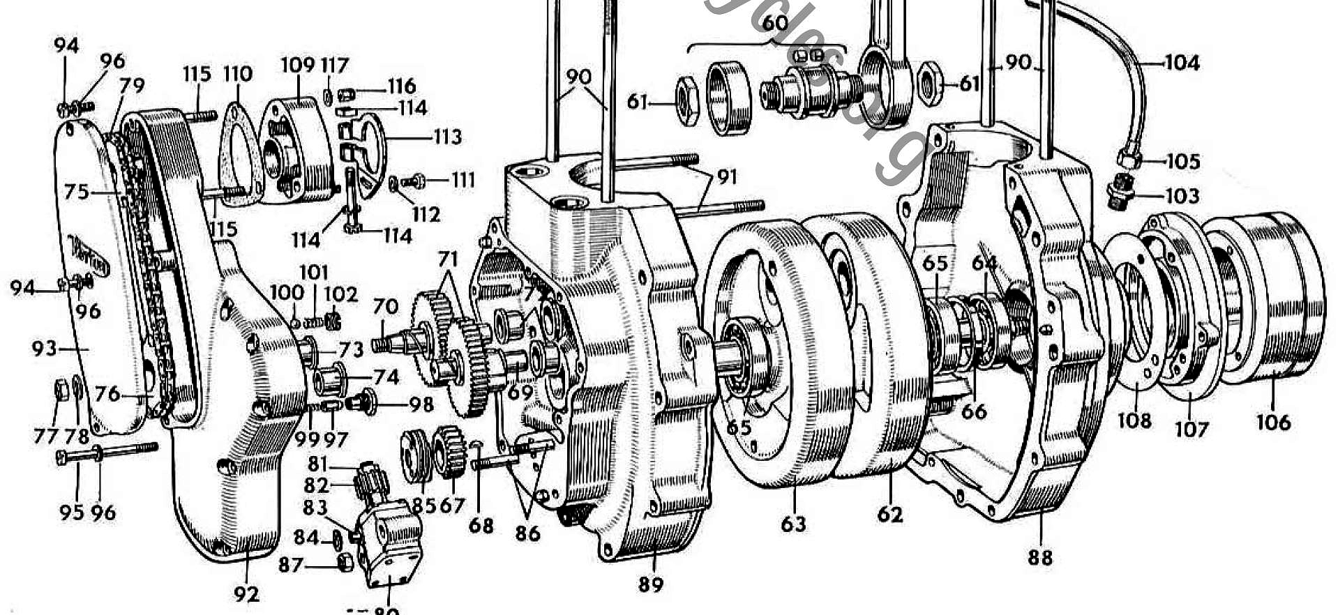

Just two drive side main bearings. The seal is on the twins and can be replaced easy enough with the primary off. No oil seal on the ES2, Mod 50 or 19S.
I can send a photo of an ES2 engine I am building, if that helps.

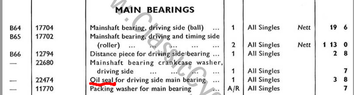

Yes Richard, there is an oil seal on the drive side mainshaft.  I replaced mine on my 1961 ES2 a number of years ago.
It is only accessed by removing the drive side crankcase as the seal is fitted from the inside unlike the twins. Seems a strange arrangement.
In reply to by ian_richtsteig
The seal seems to have been added sometime early on in the 1959 production run, I have a very early M50 alternator  engine with shop No.C30 which does not have the recess for it but other later 1959 ones do.
The seal itself is not the same one as on the twins and is a peculiar thickness which can be difficult to get, my bearing factor found me some but it took a while.

Checking my records, I see that I purchased a new ES2 drive side oil seal from Norvil in Nov 2018.  Part number 022474 - ES2 & MOD 50 - 1959 on.
What about the threaded hole for the screw at 3 o'clock? Should it go right through so my screwdriver can touch the crankshaft? If my new seal is still ok, maybe the oil is leaking out of there.
In reply to by richard_salt
Re. the 3 o'clock screw, from memory I think that those holes should all be blind ended, make sure that your screw for the stator carrier is a good fit, a bit of Pipeseal might be an idea, just in case the oil is coming that way.
