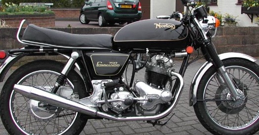

Rearsets are the way ahead…
Rearsets are the way ahead despite the looks of the things. (You can't see them when you're riding) The up and over gear linkage is fine if it employs rose joints. If you reverse the lever, the other camplate is not just a case of turning yours around to maintain 1 up three down and would involve removal of the gearbox, (primary drive etc etc) very expensive. You need to pay attention to the rear brake lever as the existing one has a lot of leverage and the std rear brake is not good anyway. When the rearset lever is pivoting on the footrest the leverage is much less ie. worse. I ended up manufacturing a twin leading shoe rear brake from mini components with a triumph herald master cylinder. took a lot of sorting but I've had it on for about 30 years and wouldn't go back.
RGM probably make the most affordable kit.
Dave Evans
Here's a picture:
