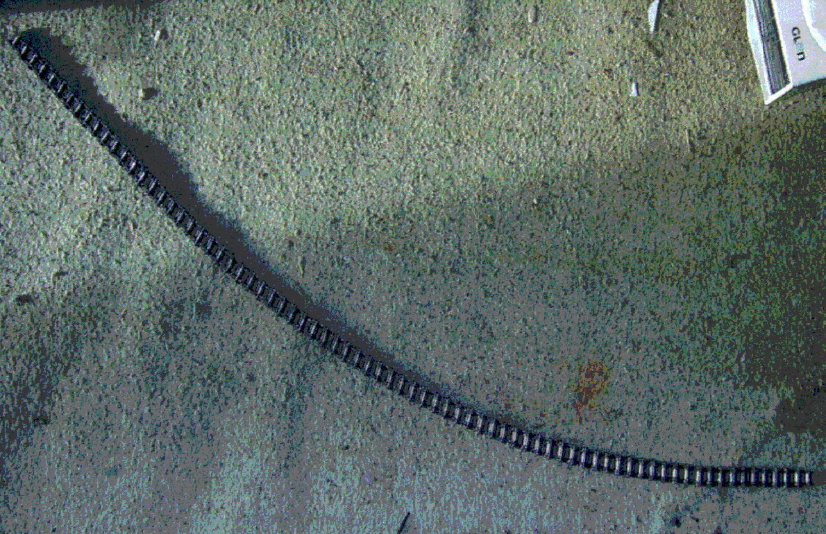

I suggest that you look closely at the chains you have. There are several makes that are basically a waste of money and this includes a few famous names from the past, previously manufactured in Japan, Italy and the UK.
The attachment shows my UK manufactured primary chain after less than 300 miles. The rear chain had to be junked after only 1000 miles despite a wax/oil dunk every 3 months and regular spraying.
Go for a good German make.
