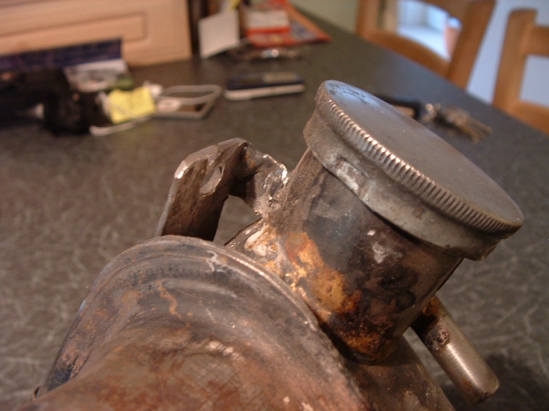

Thats ok. It doesn't seem an issue on many bikes but mine does have a coarse vibe regardless of ISO settings. I've investigated all the usuals, had the crank rods and pistons balanced and side to side but its still about the same. I've done 33,000 miles now since 98 soit's unlikely to change unless Ifind something by chance and haveone of those well I neverexperiences! Here's the tank brkt brace from an early prototype attempt. It actually looks better in themetal.

Supposedly some model of HD oil tank fixing provides the solution. They are similar to Norton but larger and use a 5/16" stud I believe. I have successfully superglued a broken/sheared rubber and provided it is then mounted with no stress (longtitudinal or radial) the repair lasts well. I used to however brea top mounts regularly and rewelding only lasted 1500 miles or so. The trick here is to brace the top tab to the filler tower so it no longer flexes to and fro'.
