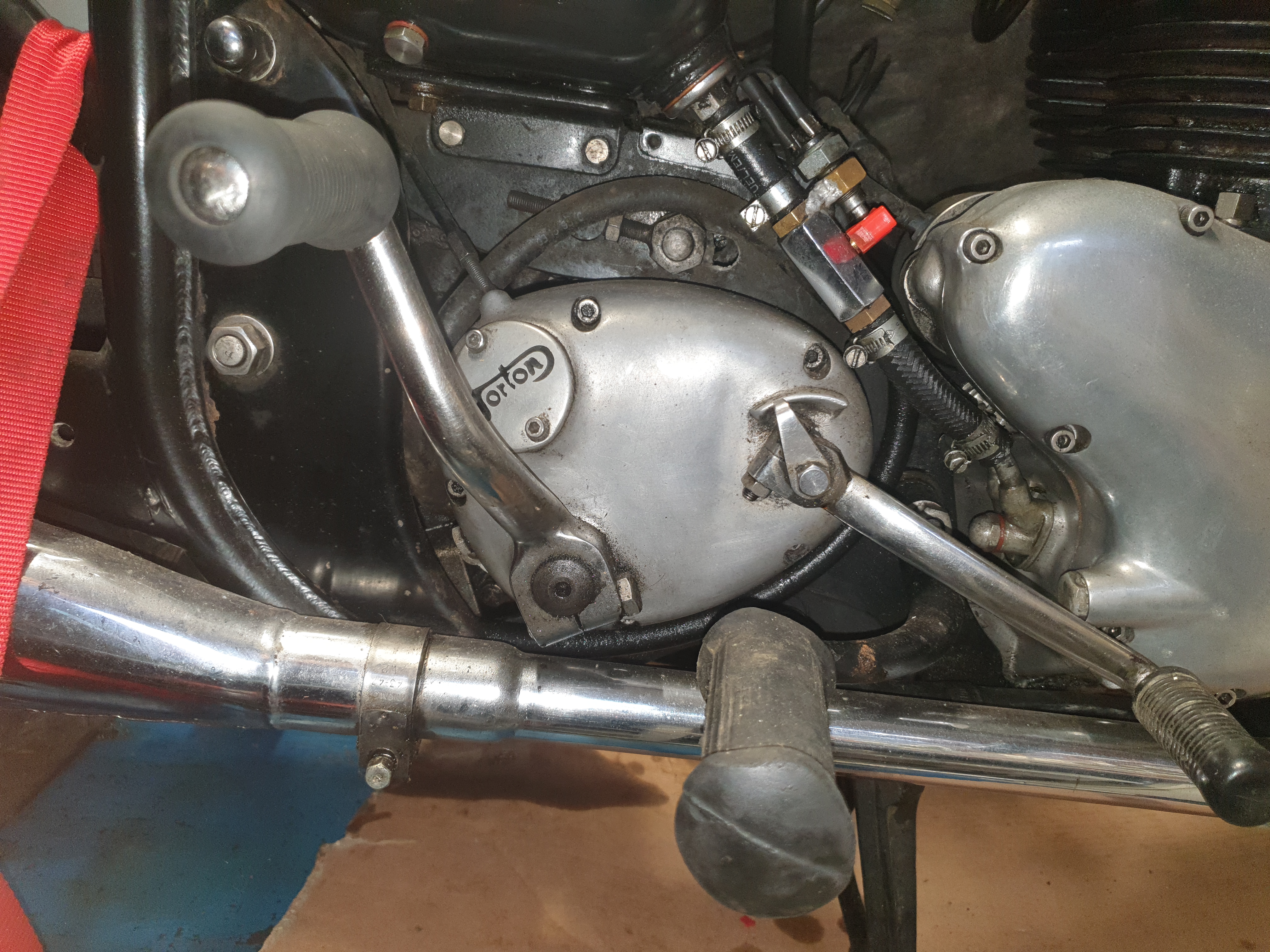

Continue to rebuild I would like comments on fitting the detachable oil filter I bought from RGM, does it fit into the feed to the engine?

No it fits in the return line to the tank. The filter restriction is too much for the suction side of the pump. So it filters any crud before it gets back into the tank and keeps the tank cleaner.

Brackets are available from our usual suppliers.  Pipe runs are not exactly tidy.  Mine came from Norvil many years ago, and I had to get longer pipes
Pics attached show the filthy location.  The tab and Jubilee clip came about (I believe) after a few Commando catastrophes when they came unscrewed on the road.  No idea why.
The picture is vertically up from road level.
