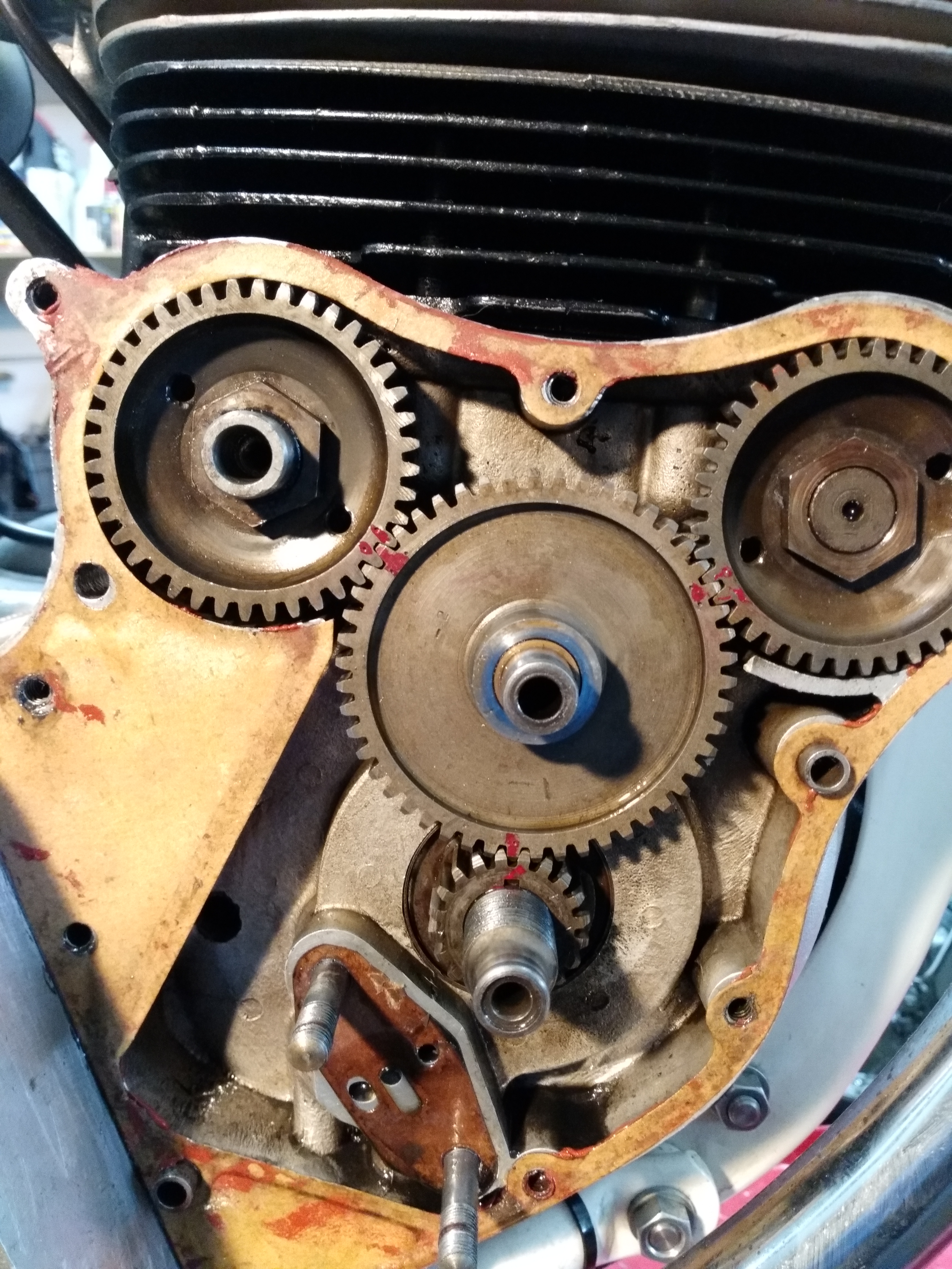

Here is a pic of the alignment marks on my Navigator engine.
Engine is set on TDC . The crankshaft pinion is marked with a single dot on the keyway in my case.
timing side

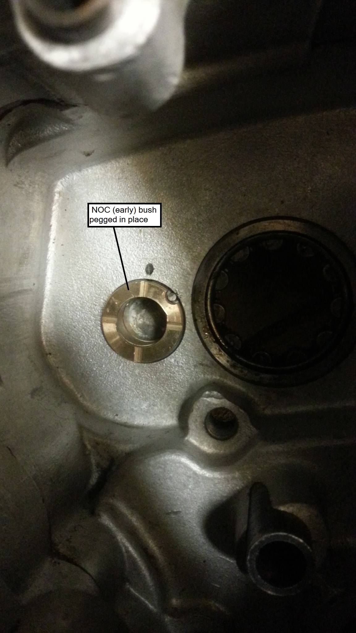

You can split the crankcases with the gearbox cluster in place. You can take it out as a unit by taking it out complete with the inner gearbox plate.I would recommend you to check all the bushes  and bearings while you´re  at it. Especially the layhsaft bush is known for spinning in its housing. In my case a friend made an oversized one for me on his lathe.

Thanks Ulrich, I see from your photo that the intermediate gear dot lines up with the keyway on the crankshaft, mine doesn't but the bike used to run ok!! the absence of a mark on the half time gear doesn't help, it's a strange one, it leaves you guessing that the crank is at TDC with everything stripped down.
Thanks again, Howard

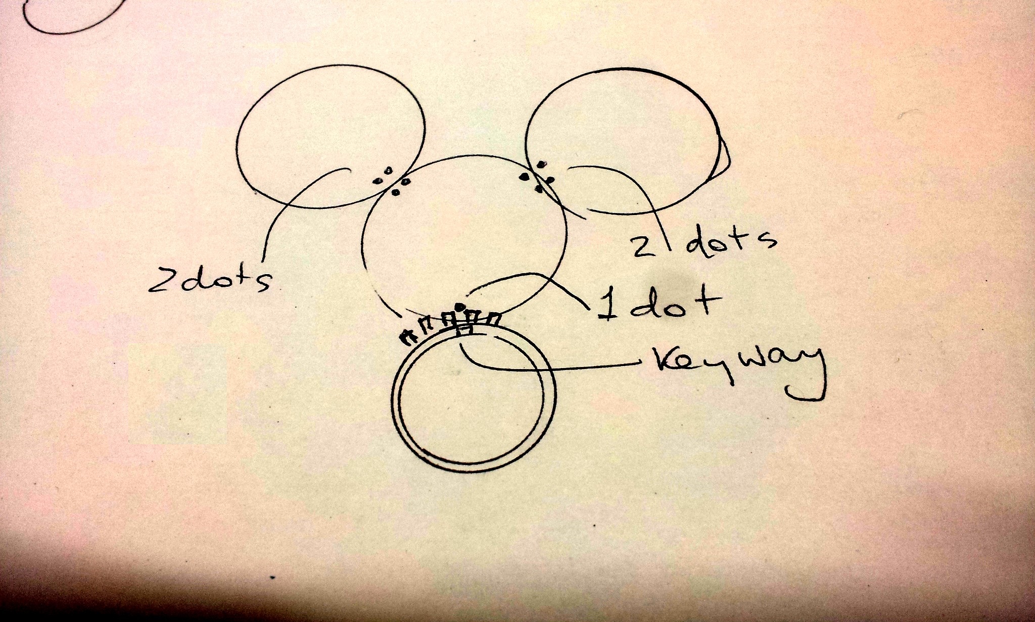

As Uli says above for timing marks & see attached

On engines before 106838, the layshaft bush is not pegged to prevent rotation. Its best replaced by a new one from the NOC that can be pegged - see photo. You may need to carry out rectification work as Uli outlines above if the original bush has spun in the housing.

Thanks Andy, I see from your drawing that the bottom dot on the intermediate gear lines up with the keyway on the crank, mine currently doesn't which leaves me a little puzzled as my bike ran ok!! I have bought three books and none of the clarifies the timing setup. I take it that the dot must line up with the keyway at TDC, is that correct?
Cheers Howard

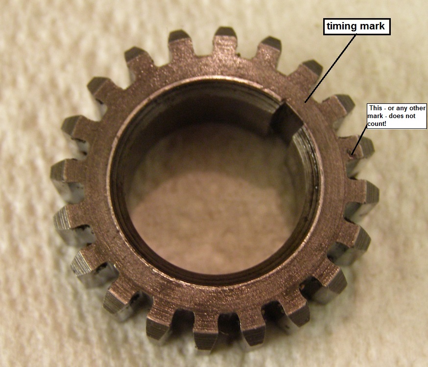

Hi Howard - there are NO timing marks on the small crankshaft pinion. It fits with the sloping side out - sharp edge in - as on Uli's photo. The keyway acts as your timing marktiming

Hi Folks - remember that the idler gear has an odd number of teeth, so the timing marks will only line up when you set them!
Once you rotate the engine - even one turn - the marks will not line up again.
You can still check that all is well by looking at the cam wheels themselves, and ignore the middle gear. If you line up the two dots as shown in Uli's photo so that both camwheel marks point toward the centre of the idler gear and the keyway on the crank should be in line too.
See Uli's picture updated with 3 white lines, which intersect at the idler gear centre. Due to a slight tilt from the camera - in the photo its not dead centre, but it should be.
The imaginary line passes through the wheel centres & between the two dots. The line going vertically down passes through the keyway.timing marks
