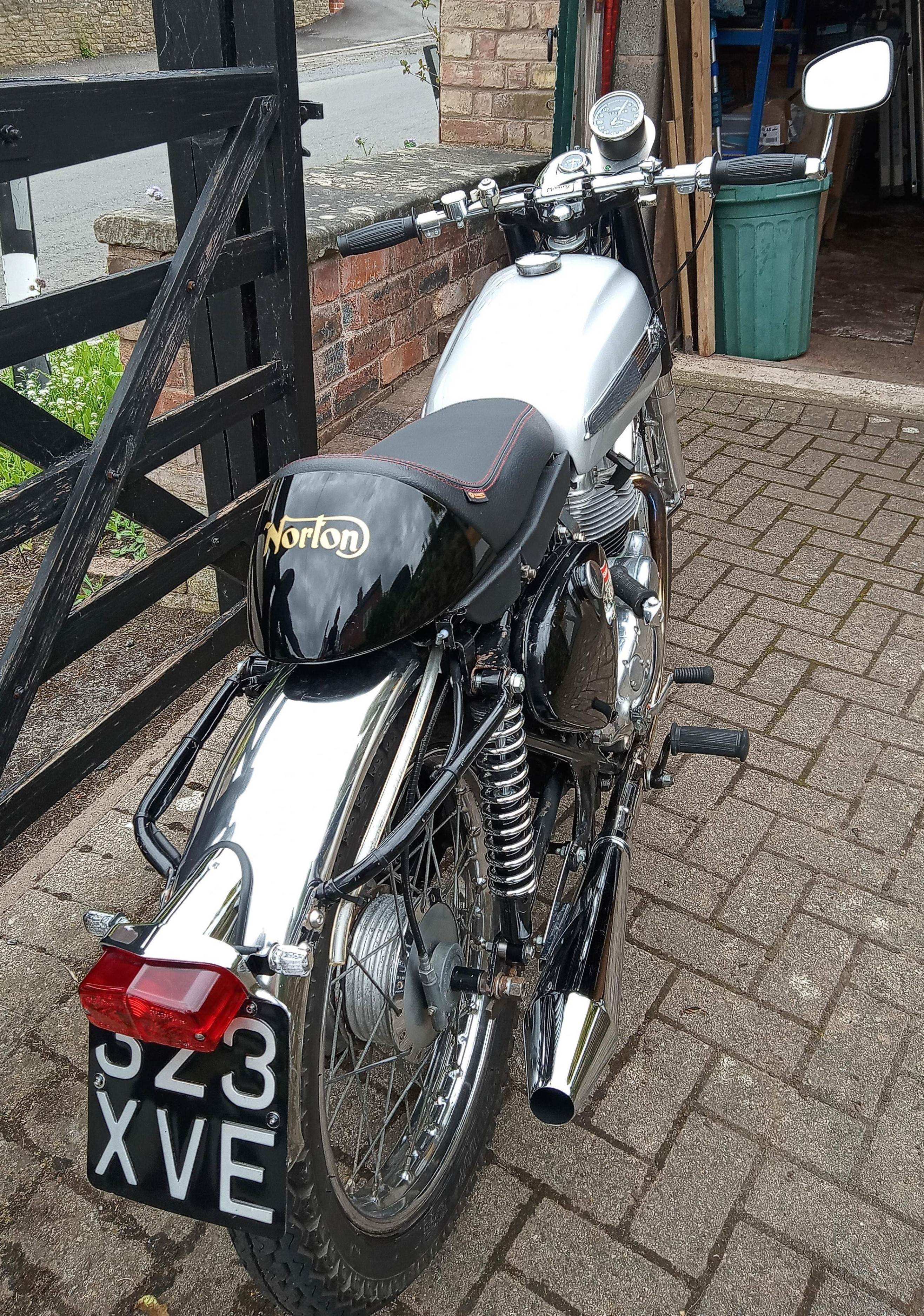

Gave Ethel her oil change today, bang on the 500 mile mark since the engine rebuild.  Amazing how black the 'old' stuff was.  Refilled with Comma 20/50 and fitted a new gauze and a finned ally sump plate with magnetic drain plug, from the NOC shop.  Bit fiddly fitting the longer studs but no real hitches, other than sore knees and elbows....
One thing I omitted to do is to clean the oil tank gauze, because I don't know where it is!  Can anyone enlighten me, perhaps with a picture.  Mine's a Standard model with the side tank.
