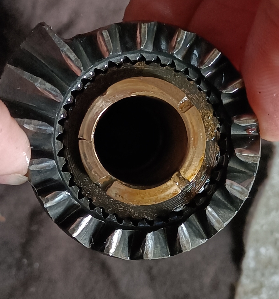

On to the topic: the 1962 Navi came with a few issues that I've worked through (sticky clutch: strip down and boil in detergent + could only get gears 1,&2: bent centre lug for the gear lever & new pawl spring). My current issue is that the kick start only engages 4/5 times: when it does, there's no compression, but some resistance felt. I've opened up the gearbox as far as removing the kick start shaft: the bush at the end is worn, so this might be the culprit. I'll also replace the spring that sits around the shaft.

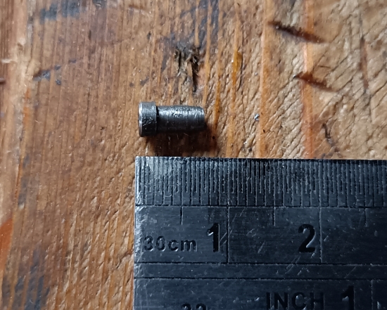

The "what's this" in the title refers to a small shouldered pin that I found sitting by the main shaft bearing: any ideas of where this is from please?
Attached are photos of the kick starter shaft bush, the pin as found and the pin by itself.
Thanks for reading!

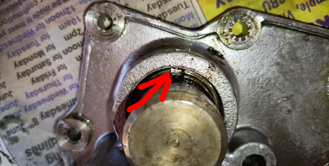

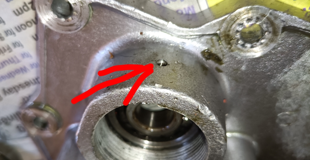

Is the one that fits in the hole visible on the thread and to the right of the main shaft nut. Don't lose it. It stops the clutch actuator rotating.

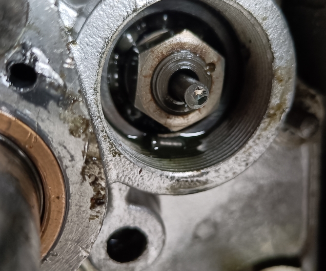

I see the hole you mean .... The pin isn't mentioned in the manual.
I was rocking the nut with a deep socket, not being sure whether it was  LH or RH thread, so I must have wiggled the pin out. It all makes sense seeing as the pin wasn't showing laying around in an earlier photo, before attempting to remove that nut!

The bush in your last photo is in the kickstart shaft and supports the gearbox layshaft. Part number 041469, fig ref B56 in the parts book. Looks well worn too.

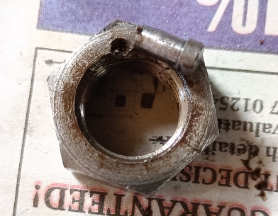

I had a look: that hole on the nut doesn't seem to take the rogue pin: it's not a hole, but a deep centre punch mark for locking the but (I've seen that locking method elsewhere). There is a 'half-hole' on the threaded shaft which this punch mark lined up with, so perhaps I have a replacement but without the 'half-hole'?
I'm therefore still a little paranoid that the pin is from elsewhere!

Your layshaft bush in the kickstart looks very worn. The kickstart ratchet has been dragging against first gear.
I suggest. Your bike has been run with insufficient oil in the gearbox. The layshaft has started seizing in it's bush. This has dragged the kickstart shaft round. The ratchet has been driven against the rotating first gear. Probably not heard by rider over other noises - at first.
