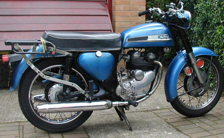

Polychromatic Blue is a metallic Blue used by Birmingham for the Manxman, and Plumstead for the Navigator - but I have seen it in differing shades. My own front mudguard is ex-factory, so correct. My fuel tank is a different shade - Vauxhall Starfirebgf

My first repaint was in 1970. My 1965 Navigator, bought for £65.00, was getting a bit rusty round the gills. Exchange and Mart declared that Hammerite paint cured the rust, covered everything and gave a wonderful finish. I think I removed the wheels and engine. Out came the 1" brush. Hammerite black for the black bits and Hammerite light blue for the blue bits. Looked just like Andy's bike but with the rust and oil covered up. Best applied thick and not overbrushed if you want a good hammer finish.

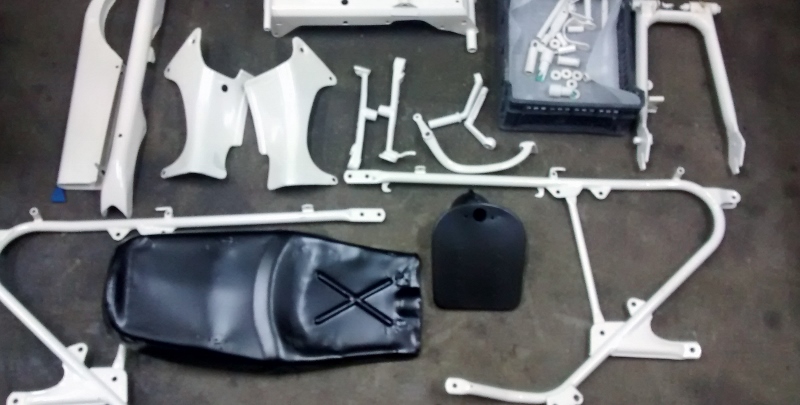

I went for powder coating all the individual frame parts but masked off all holes, threaded or not, plus steering head less bearings. I pressed out the swinging arm bushes and masked their holes. Masking with purpose made tubes and collars, capable of resisting grit and paint cure oven took some time. Photographed all the bits to give the painter at handover. He said it made the task of keeping everything together much easier.
The powder coater was a motorcyclist  who knew his art. Everything was grit blasted to remove rust and paint.  He then acid dipped everything to remove any oil in the tubes or other areas that might migrate out and spoil the coating. He primed the pieces with a zinc rich paint for longer life.. And then he sprayed the final coats before putting the parts in the oven to fuse the powder. Cheaper jobs are probably available.

This is my method of presenting the parts for painting. I used M8 studding and thin wall 10mm tube to assemble the frame in 'exploded' view style. This to let the painter get inside while spraying. Frame spacers and frame spacer tubes were in this assembly and got painted too.
Other parts were provided loose with instructions for the painter.
It took a little while but I'm very pleased with the end result. MUCH cheaper, and quicker, than going the traditional spray paint route.
