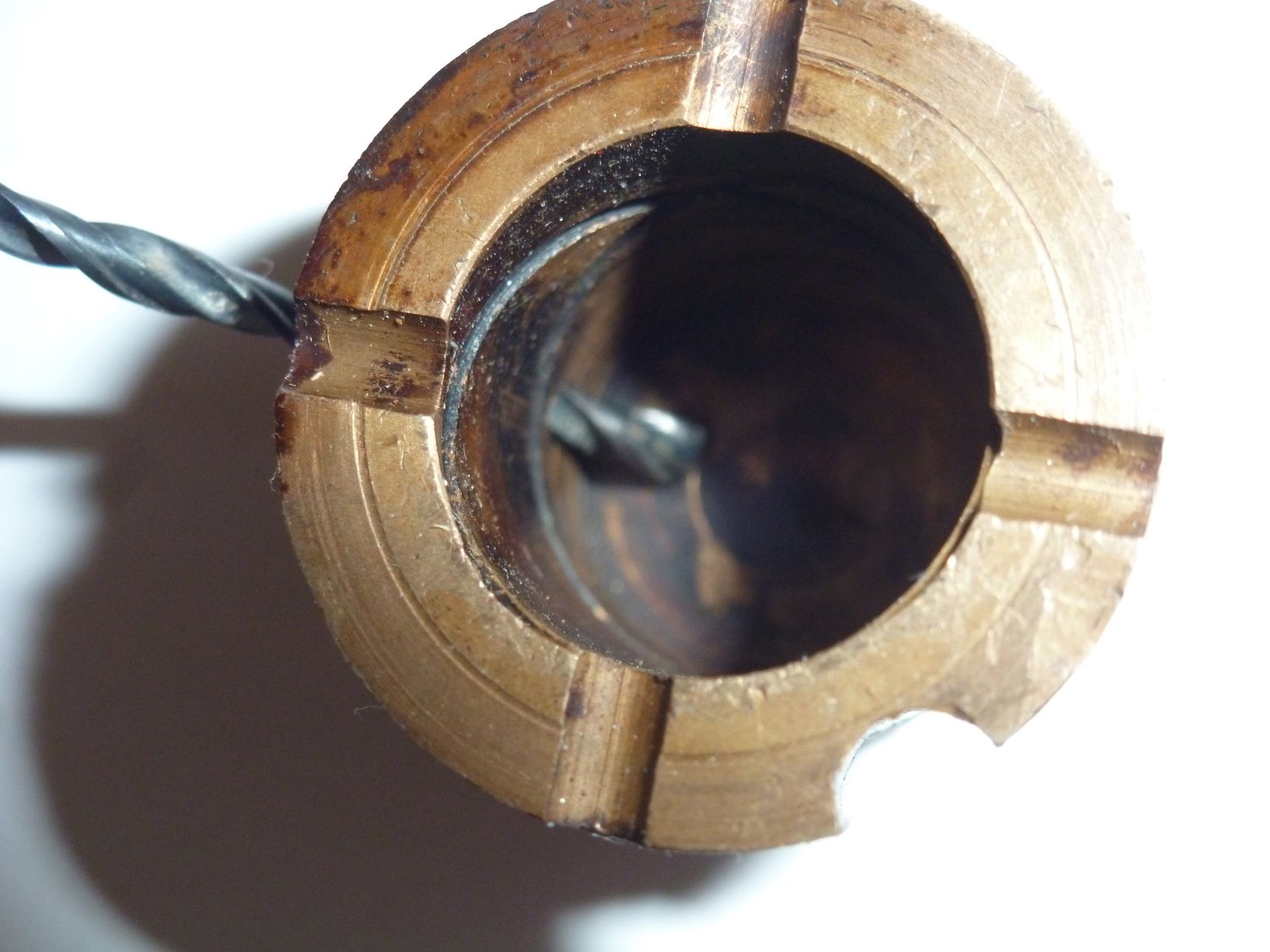

Couple of photos of a drilled bush. Of course this hole was drilled after the bush was pressed into the drive side crankase, as described above.
I may be mis remembering but I thought my bush was pinned from the front there being a semi circular cut out on the thrust face?
I also remember the pinning as being from the front of the bush with a circular cut out. Of course you still need the oil feed hole drilling. You could drill the bush before fitting if you can be sure of lining the holes up after assembly.

Ok , I machined a grove on the outside of the bush which aligns with the crankcase oil hole and then drilled through to the inner of the bush, Heated the crankcase and assembled the bush.
I fed oil through the crankcase oil drip hole and it arrived inside the bush so that I recon will do the job

Phillip, it is always best to pin the bush - if the gearbox oil level drops it is prone to snatching and spinning in the housing, which can quickly wreck the cases.
